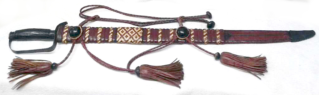

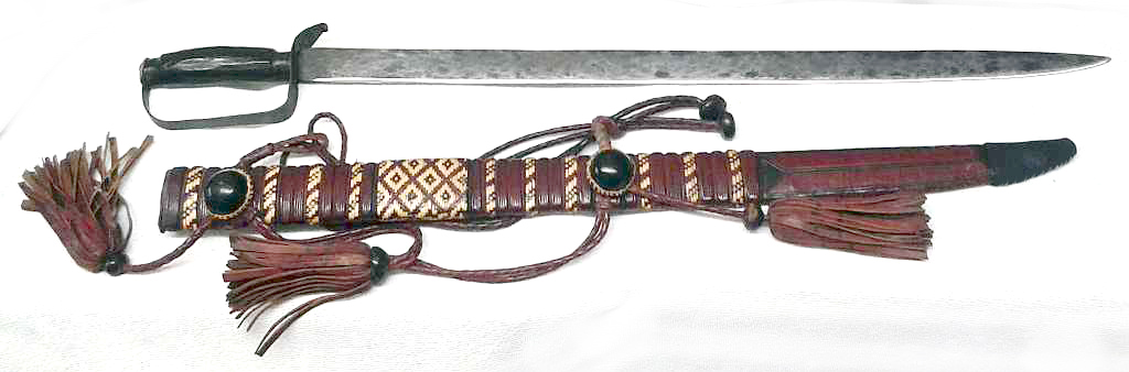

As I understand, the heyday of the Mandinka was prior to the eighteenth century and today they are spread through many modern African nations. This sword is very recognizable as a "Mandinka saber", but it is unclear to me what kind of warrior tradition the Mandinka have had for the last two hundred years.
How far back does this form go?
What is known about its origin?
Also, I think I am not alone in wondering why this rather stereotyped form does not have a name of its own but is rather just a "Mandinka saber". I found this comment in an old thread:
“I forgot to include previously that I once showed illustrations of one of these Mandinka sabres to a man who was of Fulani descent and from Guinea. He identified this sabre as termed a 'kota' if I recall correctly, claiming that the scabbard was termed 'holga' (= house 'for the sword'). While these distinctly formed sabres do not seem to ever be called by a specific term, only referred to as a 'Mandinka' et al , sword, I have often wondered what they were called locally.”
Based on its condition I would not think it is very old but would be happy for comments/guesses on this as well.
Marcus

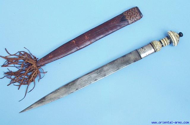

Thank you for posting a very pertinent and valid query. Actually the quote was mine, and I believe from my own attempts at establishing the lineage and development of these sabres about 15 or more years ago. The efforts however typically did not gain traction, so it is good to see the topic revived.
If you look at the open hilt, somewhat cylindrical without any sort of guard, it is remarkably similar to the Omani sword known as the 'kattara'. These open hilt broadswords are keenly associated with the Omani Sultanate of Zanzibar as seen in Burton (1885).
The idea I tried to advance in those times was that this distinct similarity was likely founded in the trade networks which connected Mali with the East African trade centers, including of course Zanzibar. Since the Omani traders were prominently represented in these trade networks, it does not seem implausible that the Manding, who were the controlling tribe and merchants themselves, would not have been influenced by the swords of the Omani.
The prevalent blades that occur in these Manding swords are typically of French origin with their availability (French West Africa), however there are numerous cases of German with trade volume of these present. The Tuareg takouba with curved blades (aljuinar) sometimes used similar sourced blades and I have even seen British 'Mole' blades on them.
As the kattara swords of Oman with these type open hilts (with knob or square pommel) are not believed to have begun much before early 19th century, it would seem to set the style of these Manding sabres in most probably mid 19th century. As the character of these hilts does not correspond to other hilt types in those Western regions, I am inclined to believe they must have been taken from the Omani hilts.
As with most of these African sword forms, they seem mostly to have been late comers to 'sword tradition' in Sahelian as well as Sudanese tribal cultures, with early 19th century being the start period. There were of course swords present with many of the ranking or noble individuals of probably European form, but in most cases, spears and such other edged forms were predominant tribally.
The influx of trade blades in the 19th century created the advance of sword culture and in the case of these Manding sabres, I believe they arose from Omani merchant influences coupled with those availabilities of blades from trade or colonial sources.

Hi Marcus,
You have a very nice Malinke sword, the European blade is 19th c. I think that the whole sword is end of 19th c. In very good condition.
Kubur

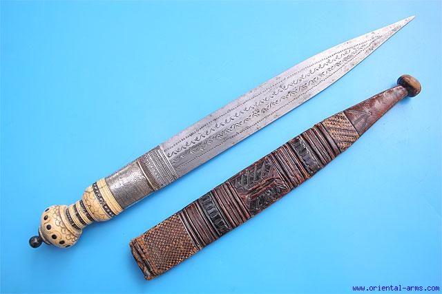

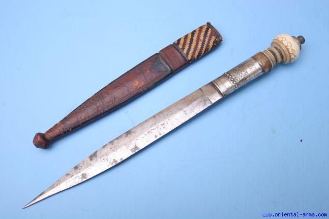

To the Omani, these open hilt swords were primarily status oriented, much as the khanjhar daggers. That the importance of these swords was probably notably taunted to other traders in these networks must be strongly considered. While slaving was one of the key commodities as these networks moved from Zanzibar inland and northward, we cannot imagine that groups of slaves travelled such distances across the Sahara. However, as these routes entered various entrepots and centers goods etc were exchanged with the those of caravans from the west at these points, weapons and their forms etc. would catch the interest of those individuals.
It is agreed that the hilt on the dagger with cylindrical shape is compelling and seems to be of Cameroon style. But is this the result of such influences from the Manding swords, or a prototype? We cannot be sure without well provenanced examples which might provide some chronology. That there is a similarity cannot be denied, but from historical and developmental perspective we can only recognize that for face value.
The idea of independent evolution of the hilt form and styling as well as the mysterious scabbard flare in remarkably distant areas, yet profoundly keyed to two indigenous points seems almost as tenuous as the idea of direct influence.
We know that Omani infuences were 'relayed' via trade networks from Zanzibar originations and traversing African regions, via Sudan, thenceforth westward across the Sahara. One connecting point was Darfur. The most notable commonality in the nature of the trade of the caravans as well as this very region ....slaving. It was here, in my opinion, that the distinct scabbard feature (from the scabbards of kaskaras) confluence with the open hilt styling of the kattara, and these influences travelled westward.
The Omani swords with their distinct hilts, probably with curved blades, and seen with swaggering slave merchants as marks of power and prestige, may have been acquired by traders in the caravans. As they exchanged with other segments of the caravan networks, the power of the Darfur traders, here symbolized by their kaskara (with flared scabbard tip) , probably also were acquired by said traders.
Arriving in Mali, the routes were controlled by the key merchant class of the Manding. As they exchanged with the traders from the east, would it not seem likely that they may have been impressed by the profoundly status oriented swords of slave traders and merchants of Zanzibar and Darfur?
Keen leather workers, they may well have adopted the cylindrical open hilt and as they designed the symbol laden and handsome scabbards so notable on their sabres, and amalgamated the symbolic scabbard flare recalling that of the Darfur traders.

just received this mandinka sword, this thread looked like a good place to post it.
4.5 in. grip, sheet steel guard. grip has a brass or copper spacer at the guard, a steel ring bolster and a leather covered grip sewn along the top and black laquered. pommel has a featureless copper disk (coin?) keeper under the peened tang. blade has a dark patination with some darker oxide areas and a few small pitting areas. blade is 23.25 inches long, 1.125 in. wide at the guard, 4mm thick at the guard, slight distal taper to 3mm near the tip. hammer marks from the forging evident along the blade. leather scabbard with traditional banding patterns, braided suspension cords and buttons.leather fringe tassels.
Old 4th June 2017, 05:46 PM   #24
Posts: 10,852
Very attractive example Wayne! Really displays the phenomenal leather work characteristic of these people. The stirrup hilt European style on this sword reminds me of quite modern examples of these seen still carried by some forces in coastal West Africa in conflicts in 1980s.The hilt on this one does seem much older, the examples I refer to were brass.
Old 4th June 2017, 08:19 PM   #25
Posts: 4,285
Thanks for the comments, Jim, I wish the keeper under the peening were not smoothed off, if it is a coin. it would help set a lower limit on it's date of mfg.
