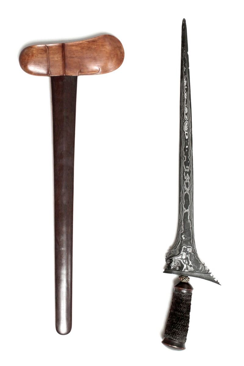

Gentlemen,
here is a Keris that I got a while ago.
I was told it is from Bali or Lombok.
The hilt is pleasantly simple.
Can someone add to the above description?
Maybe put in a date range?
There seem to be some ribbons missing around the sheeth.
What would it have to look like if it were complete?
Many questions from a learner.
Thanks in advance for any input,
taube.

A good and old kris blade from Bali or Lombok, congratulations! The cylindrical hilt is in locengan style with plaited horse or human hair (?), and the scabbard is in rustic sandang walikat style but not specific from the region.

Posts: 7,298
With Bali and Lombok it is often very difficult to tell since Bali ruled Lombok for a bit of time. The missing "ribbons" on the sheath stem were most probably a simple rattan weave. As Jean has pointed out, the walikat style sheath is somewhat rustic and i have never see that little belt stop on the top part on a keris sheath before.
The blade is certainly antique, but i am not particularly good at pinpointed such things. Always very difficult with keris considering that styles are repeated again and again many years after the time they originally appeared. I think it would be fair to say that yours appears to be at least from the first half of the 19th century though it may indeed be older.
I would say the horse hair is more likely than human in these hilts. I have been told that this style of hilt was often employed by warriors as these hilts provide a good grip. But that might be nonsense for all i know.

I have no disagreement with the above comments.

I have a keris with that style of hilt; it's the only one I have that actually feels like a weapon, in hand. The hilt combined with the blade and the overall balance leaves little doubt in my mind.

Thanks everybody!
Happy to read it is a truely historical and maybe even utility item.
@Bob: Would you mind showing your Keris with the similar hilt?
Best.
taube.

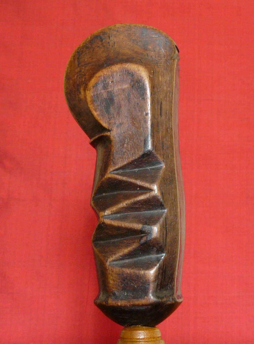

According to Djelenga who was a respected kris collector & book author from Lombok, these hilts were used by young people, especially priests and nobles. The warriors apparently used the large cekah solas hilts (see pic) which makes sense as the grip is excellent.
And at the request from Taube I attach the pic of one of my krisses with a similar hilt.
I have also heard that the cekah solas hilts were favored by warriors, but heard that same for these hair-wrapped hilts as well. Not a lot has been written on such matters beyond Djelenga. While i don't dismiss his opinion this hilt style seems an odd one for nobles.
