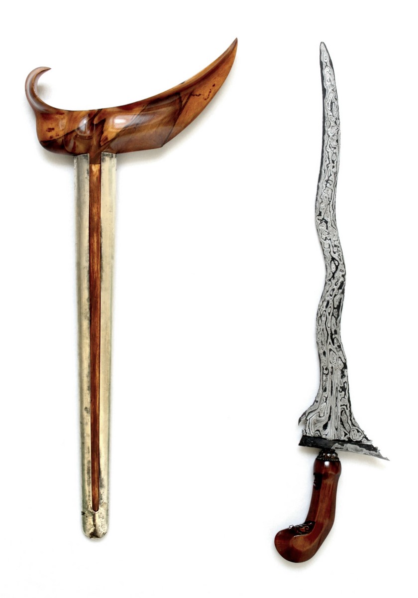

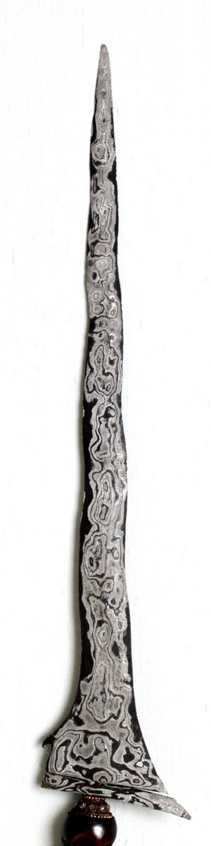

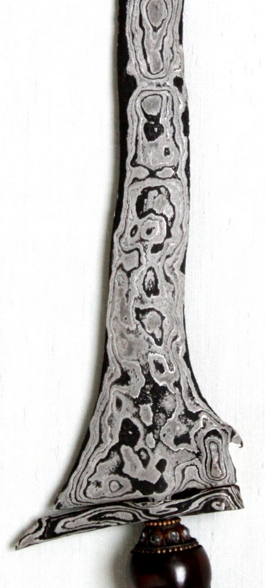

Sorry if this subject was raised earlier in the forum but some members of the Solo kris circles claim that meteorite iron was used for making pamor blades besides the Prambanan meteore. From memory they identify it from the prickly touch, look, and "resonance" for those able to feel it.
These 2 blades are examples of what they identify as made from meteoric pamor, what do you think?

Yes, it is a widely held belief that pamor made from meteorite does have a very slightly prickly feel to it. The two blades that I have been involved in making that definitely contain meteorite do have a very faint prickly feel. Another blade that I have which is attributable to Jayasukadgo also has a very faint prickly feel. Jayasukadgo was a Surakarta empu during the era when Surakarta empus did sometimes use meteoritic material.
However --- over the years I have handled other blades that have very little possibility of containing meteorite, and these have also had a very slight prickly feel.
"Resonance" ?
Yeah, right. For those who believe.
The "look" of the blade?
Here is a pic of a blade that very definitely has pamor made from meteorite.
Does it have some sort of distinctive look that jumps out at you and screams "METEOR!!!" ?
Jean, I've been exposed to these beliefs for a very long time. If somebody believes that he can identify meteor by look, touch, feel, or because it whispers to him when he's asleep, who am I to argue with him?
In my experience the claim that a blade contains meteoritic material begins with the way it looks:- if it has pamor material that is a little bit out of the ordinary and cannot be easily identified, then this is a sign that it is probably meteor --- for those who believe.
Then the "testing" begins, the feeling of the blade with eyes turned skywards or slightly closed, the deep concentration, the announcement that it feels slightly prickly.
Somebody else who is present will feel the blade and confirm the prickly feel --- would they dare not to? This is Jawa don't forget. Avoid conflict and disagreement at all times.
Then the edge of the blade will be flicked with a fingernail and it doesn't matter what sound it makes, this will be a sure sign that it is meteoritic pamor.
It must be very clearly understood that virtually all keris knowledge as it is today is in fact a belief system, or a network of belief systems. This knowledge is based in societal and cultural beliefs and mores and has very little to do with reality.
If we are to understand the keris, we must understand these beliefs and when the occasion calls for it we must not challenge these beliefs --- apart from being a waste of time this would also be impolite.
But the acceptance of the belief, when this is called for, need not divert us from reality. We just don't speak of reality when belief is the order of the day.
Belief (and good manners):-
if a Javanese gentleman assures you that a particular blade is made from meteoritic material, accept his assertion, declare that it feels prickly and compliment him on his prize possession.
Reality:-
which meteors were used to produce the blades that contain meteoritic material?
where is the record in the old literature of meteor falls?
where, prior to the late 18th century, is there mention or inference in the literature that keris contained meteoritic material?
No answers?
Totally unimportant. Belief and reality never were very comfortable bed-fellows.

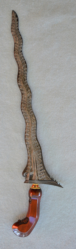

The picture above of the keris that pande keris Yantono made, using meteoritic material that I welded uses pamor that was made with meteoritic material that had been combined into a small billet thus the billet of meteoritic material could be incorporated into the iron in exactly the same way as if it had been commercial nickel.
I welded meteoritic material used in the keris above, in a gas forge, not in charcoal, not in coke. I welded a number of billets of meteoritic material, all of which were made with a number of small pieces of Arizona meteor. Small pieces, because at that time--- about 1990--- it was incredibly difficult to buy large pieces of meteor, and even the small pieces were very expensive.
I did initially attempt to weld meteoritic material in a coke forge, and I did have limited success, but it was a very wasteful process, and very, very difficult. I never used the Javanese envelope method with meteoritic material.
Using a gas forge for welding is about as difficult as making a chocolate cake --- in fact I'd say that making a decent chocolate cake is quite a bit more difficult than taking a weld in a gas forge.
The same is not true of coke, nor of charcoal.
I am quite certain of the way in which Javanese smiths welded pamor. Apart from having seen it done, and I myself having tested this method, I have a copy of a smith's textbook that was compiled under the aegis of the Karaton Surakarta, and this is the method shown in that text book.
So when we speak of "meteorite pamor", we are not talking about the entire bulk of pamor material being from a meteor. We are talking about the contrast in the pamor being provided by meteoritic material that has been welded with iron. We do not need very much meteor.
