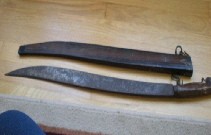

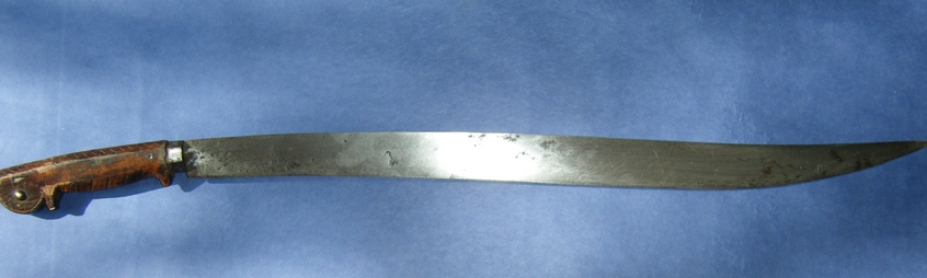

Default Philippine monosteel Blades. Preserving and restoring
Hello Everyone,
I would like to ask what is monosteel(Philippine monosteel blades)? What's its history? Made of? Automobile coil? Leafspring? Can you age the blade if its monosteel construction? How do you get rid of rust on monosteel blade? Does the same rust removal techniques for laminated blades apply? Polishing and etching? Would you apply vinegar or other etching acids(citric acids or Fecl) to a rusty monosteel blade? Thanks! Oldschldude
Blade dark spot early rust.
Slightly surface rust.
Pitted rust spots.
Crusty rust whole blade.

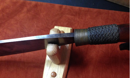

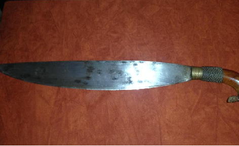

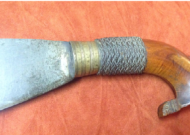

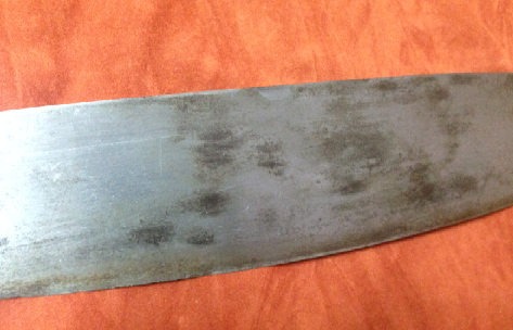

Hello.
I'm back with pics. Finally figured out how to compress photos using MS Paint.
Most info that I read about rust removal or blade restoration was on laminated Philippine blades. Didn't know if etching also applies to mono steal.
I'm attaching my barong pics that I would like to clean the blade. It started to get dark spots and small pits. I would hate to ruin it by improperly cleaning the blade. I would like to get rid of the dark spots and don't know if etching it would ruin the blade or change to different color. I will use warm vinegar if I will etch it.
I never etched a blade before, I only apply oil to preserve it. Most of my info in blade restoration I got here and I think this barong is mono steel. One question is, When did the filipinos start using leafsprings? WW2 era or before that like in Span-Am War. Thanks again everyone. Oldschldude

Hello Oldschldude,
the blade from the Luzon sword in up I've cleaned with sandpaper only, by such a rusted blade you can start with 80 and can end with 1000 to get a nice smooth finish but know people which go higher.
Your barong blade don't seems to have bad rust so I would start with 120 or 160 paper. I bet that your blade will show lamination, look close to the spine if you can see lamination lines.
I wouldn't clean such a blade with any sort of acid like pineapple juice, the blade will get a grey/dull surface and it will need a lot of polishing to get it away again. The sandpaper you can use dry or with oil. Before you start to etch a blade clean it with aceton to remove all oil and grease.
Thank you for the compliment.
