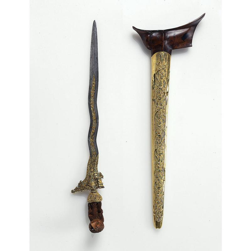

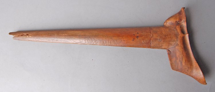

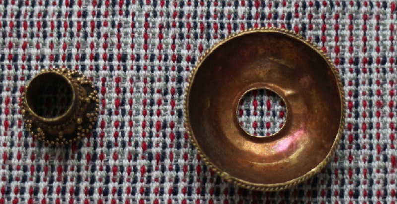

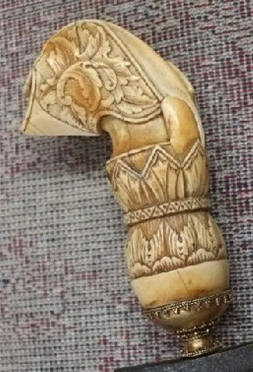

I just got this keris Sumatera(?). It does not have a sarung/scabbard.
I can get the sarung done here -especially the peninsula malay type- but not sure exactly what type of sarung is appropriate to this keris. Would it be palembang style? bugis? etc.
Would appreciate suggestions and pics of appropriate scabbard.

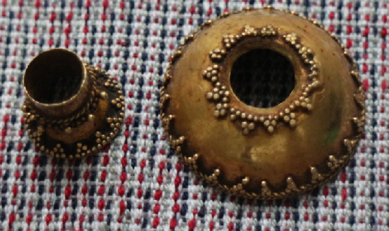

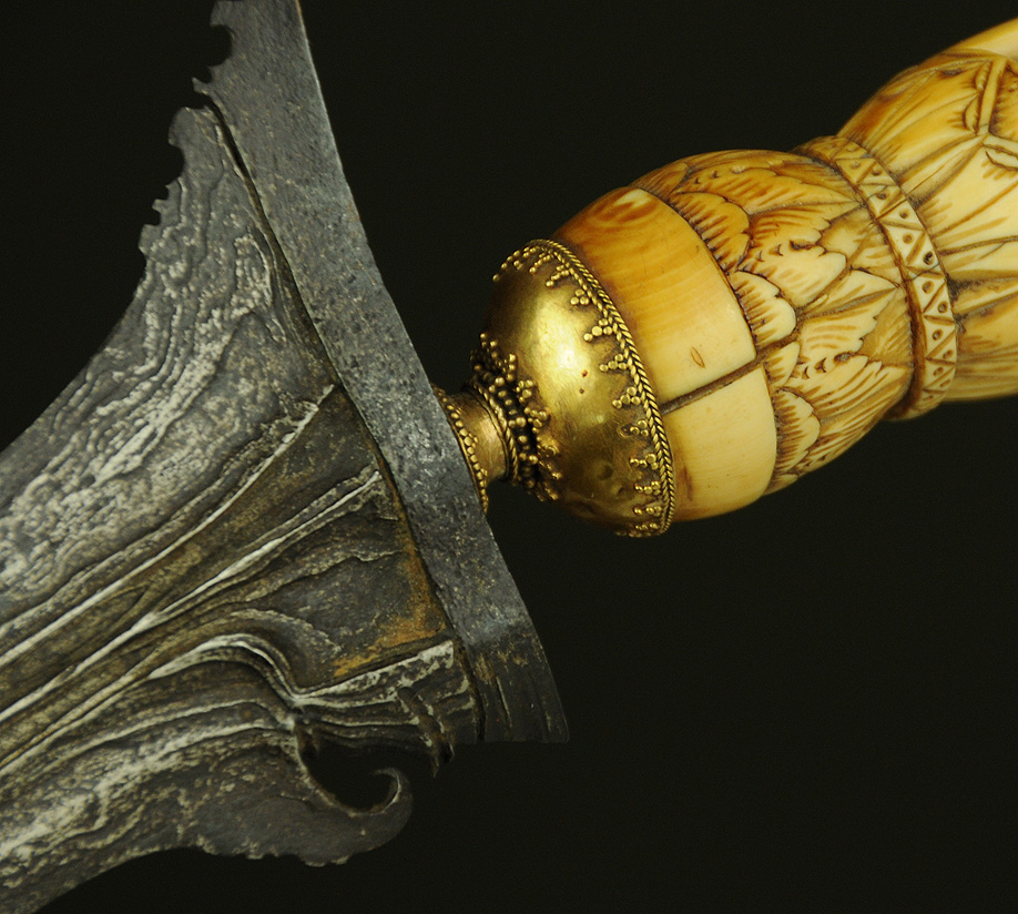

Another Q. the tone and color of pendokok looks like gold and not kuningan or copper, but I have no way of verifying this. Can any of you give your opinion?
Old 25th May 2016, 06:16 AM   #2
Posts: 7,230
I think I'd be inclined to run with Palembang.
If the pendongkok is not brass, it may be gilt over silver.

Thank you Mr Maisey. I think it'll look good in palembang sheath. I'll go with this and get it made.
My guess as well. Palembang.
I would have to say that even better, closer images of this hilt cup would not be sufficient for us to be able to identify this metal for you. In the current images i would guess brass, but again, would not be able to make any positive ID. But any jeweler worth his salt should be able to tell you the answer fairly quickly without much trouble.

Do we think the base of this Selut may be possibly upside down as it is mounted?

Rick;
The base of the selut/pendokok/mendak is detachable and that's how it came with to me.

Hello Green,
another vote for Palembang. The pendokok looks like gold or gold plated to my eyes. I would let test it. BTW, beautiful hilt, can we see additional pictures?

By enlarging the pics I seem to see withish shades on the granulated balls of the pendokok so the metal may be gilt silver. You may get a more accurate opinion by looking at the inside of the cup. The ivory hilt is peculiar and very nice indeed.

I don't know if this will help or not, but this is the best I could do with the posted photo.

This looks like silver now.
Is it possible that the yellow tint in the first photo was a reflected colour?

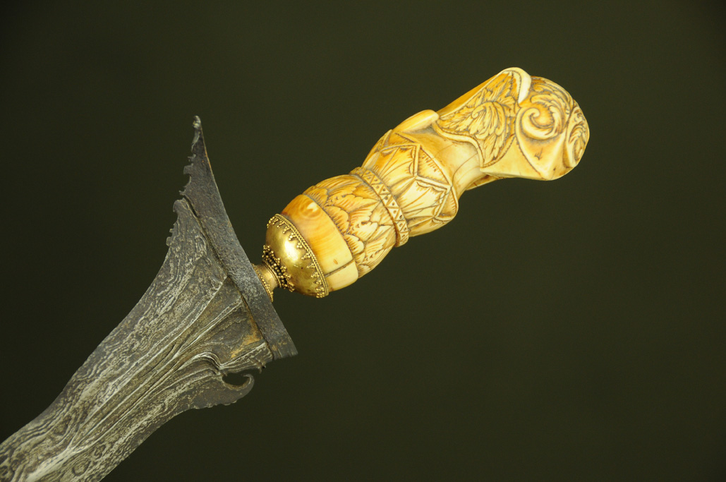

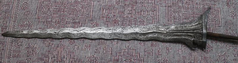

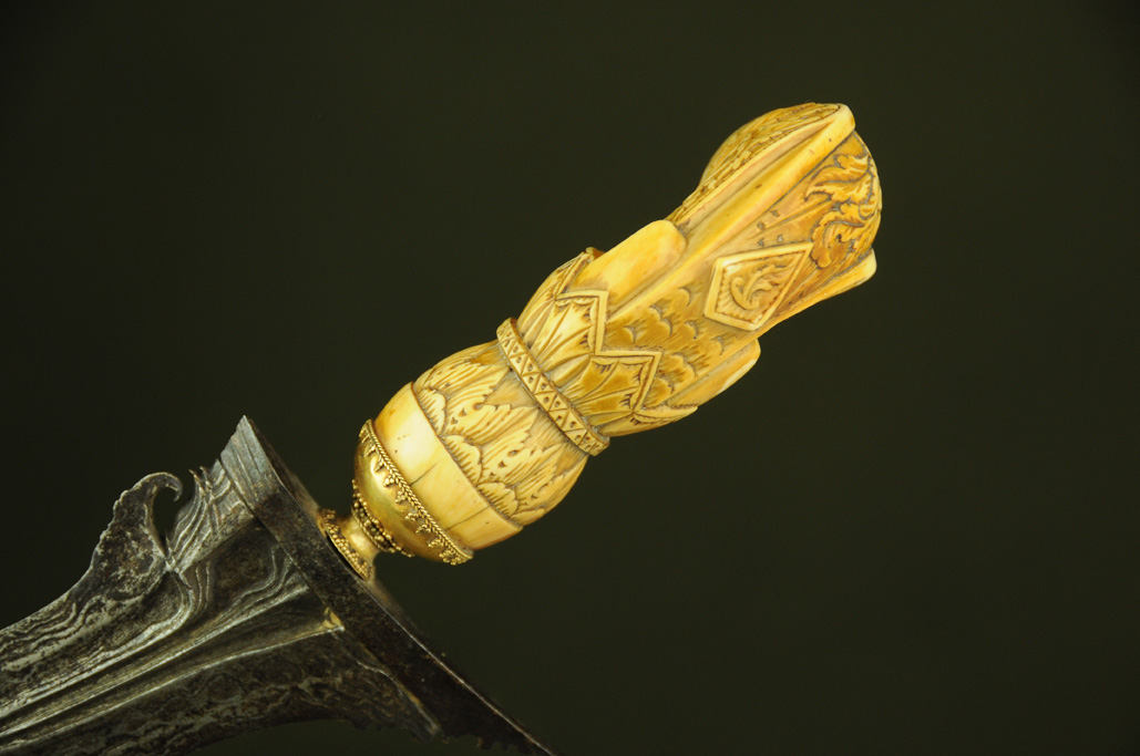

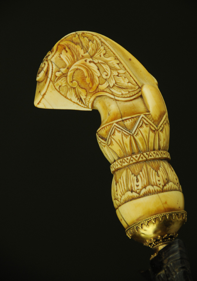

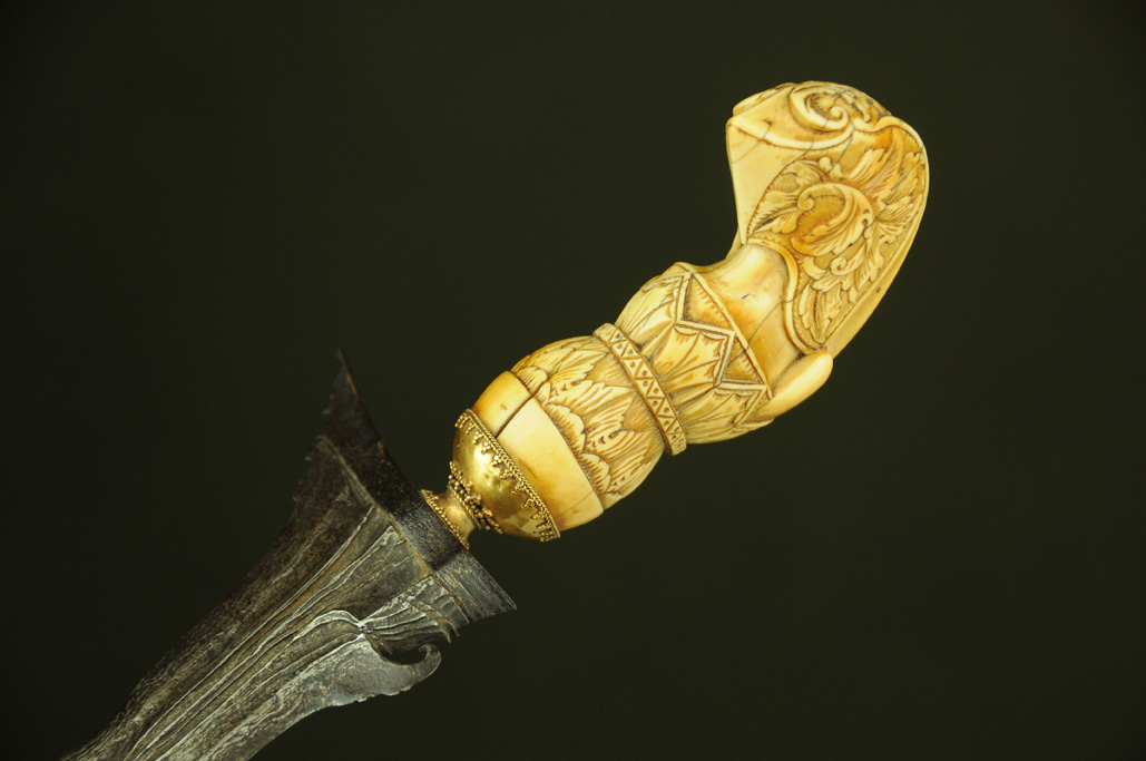

Very unusual mix of features on hilt, like the execution of the waist band. The blade is 40 cm long, so quite long for Palembang.
Old 28th May 2016, 09:03 AM   #13
Gustav
Join Date: Jun 2009
Posts: 1,346
Entire blade.
Old 28th May 2016, 09:12 AM   #14
Gustav
Join Date: Jun 2009
Posts: 1,346
Because of the unique hilt style and not quite Palembang Mendak it would still look strange in a conventional Palembang sheath. Something like old North Coast Java/Lampung would look perhaps a little bit better, perhaps not. I also doubt, the Mendak and hilt are aesthetically the best mix.
Do we see such extensive use of granulation on Mendak in Sumatra?

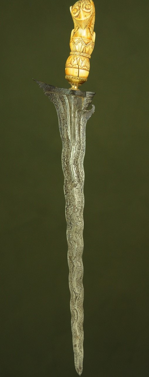

Here's a few more pics , sorry they are not v clear as they were taken under low light. The inside of the pendokok look dull with suasa tint but on rubbing it, yellow color quickly came out.
I don't see any silver but it could very well be gilded as this method of spraying golden layer on base metal is v often done on many malay pendokok... except that the pendokok look rather thin and does not look like a typical malay pendokok.
also, i can't put what type of blade this is. does not look typical malay blade..the aggressive abuse (?) of surface texture of the blade by the previous western (?) owner doesn't help. For it could have been previously warangan (which puts it to javanese type) or wasn't.

I agree with you Gustav, this is not a typical Palembang blade, but its not typical of anything I know, certainly not Jawa, and with that kaku blade it doesn't fit easily anywhere, however, there have been some mighty queer keris emerge from South Sumatra, and Palembang dress is as good as any dress that I can imagine to put this into.
When trying to make a decision on keris origins and nothing is obvious, we usually play a game of elimination and then see what we have left. If we cannot place this keris with some degree of certainty into one of the big, well-known baskets, then Sumatra is probably where it belongs, and South Sumatra is perhaps the safest dress to use.
The problem we face when trying to determine geographic point of origin for keris is this:- once we move away from an area of dominant influence, the rules fly out the door. There is variation upon variation upon variation, and nothing is certain, so we do the best we can under miserable circumstances.
I'd still run with Palembang --- unless somebody has a better suggestion?
One of the really good indicators with any keris blade is the way in which the ron dha is cut. The ron dha on this keris shows absolutely no consistency of form, and nothing that is identifiable as any known form, but it does show a form that mimics the elements of a correctly cut Palembang or Javanese ron dha, almost as if the maker had seen a correctly made keris and tried to remember what it looked like. Again, the prominent ada-ada, a distinctive feature in some Javanese keris, but not to this extent, and the number of waves? An abomination and an insult. This blade was not made by any empu, nor any pandai keris, it was made by a talented tukang besi at a customer's direction.

I also would say South Sumatra.
Alan, I know, that Garrett and Bronwen Solyom have done some research on Lampung. Is there some material about Kerisses in this research?

Green, in these latest photos the hilt cup doesn't look like suassa or gold at all. Looks a little copper-ish on the interior, but i would more likely suggest brass if pushed.
This keris looks like a Palembang (Sumatra) blade, which i believe was already established, so i would not classify it as a Malay blade nor expect the same treatment given to a Malay blade. The only "abuse" i see of this blade os that it needs a cleaning to remove the rust. If i am not mistaken, it would be expected that keris from this region would also receive warangan much the way a Javanese keris would. The surface texture does not look abused (aggressive or otherwise) to me, at least not that i can see in your photos. I would expect a keris from this region to have such a topographical surface as this. Of course, if you are unhappy with the condition of this keris please send it to me immediately and i will give its poor "damaged" self a good home.

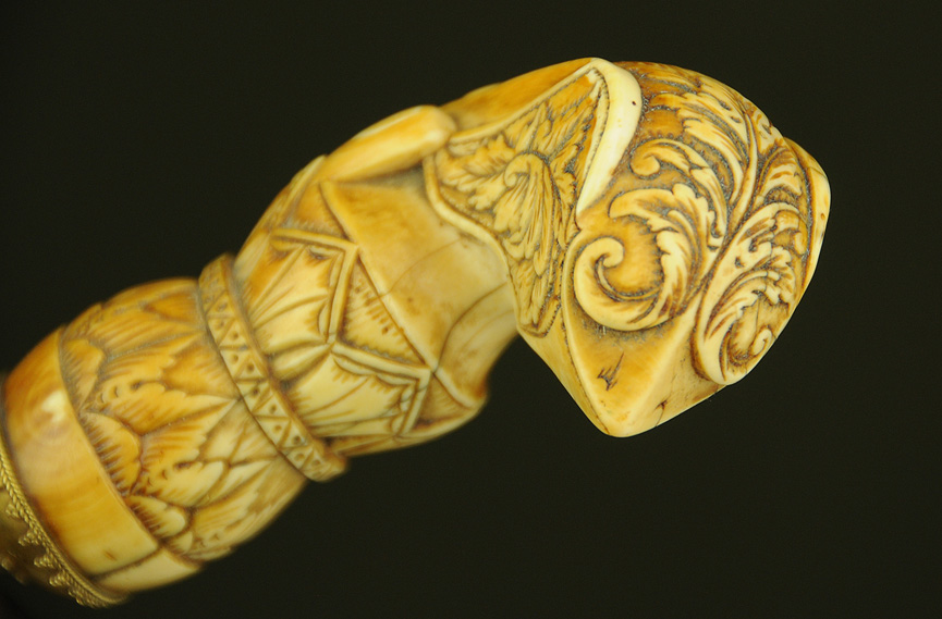

what attracts me to this in the first place is the big old ivory hilt which i still don't know what 'basket' it belongs to. looks like it may be a mongrel just like the blade. not that i worry about it too much...and the mendak/pendokok... gold, brass etc... i still don't have a definitive clue.
one thing for sure is, taking Alan's and others' suggestion , next week i'll get the local MALAY peninsular malaysia sarong/scabbard maker to make a palembang sarung for this... unless he has a very strong opinion other wise...and further reinforcing the mongrel-ness of this keris!

21 luks is indeed unusual for a keris blade from ANY culture (and an oddity that i like about this) and this blade doesn't fit into any particular "pakem" AFAIK, however i don't quite see how this can be seen as an "abomination and an insult". To whom? Certainly not the person it was made for. Just seems a bit too severe a judgement to me.
