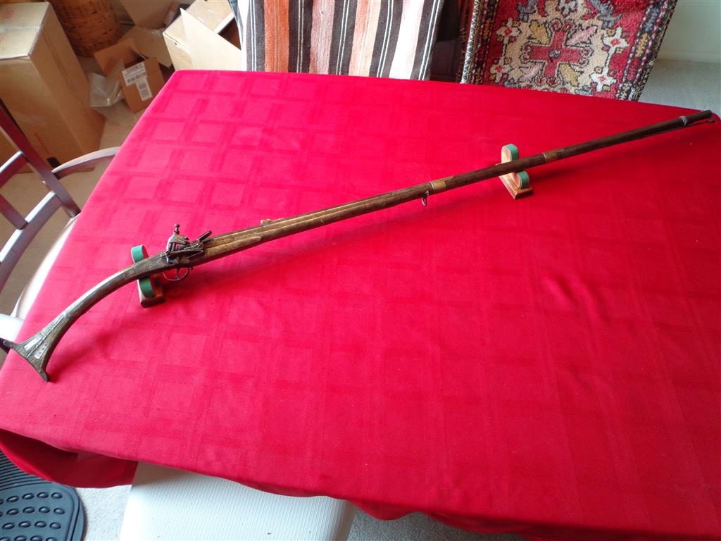

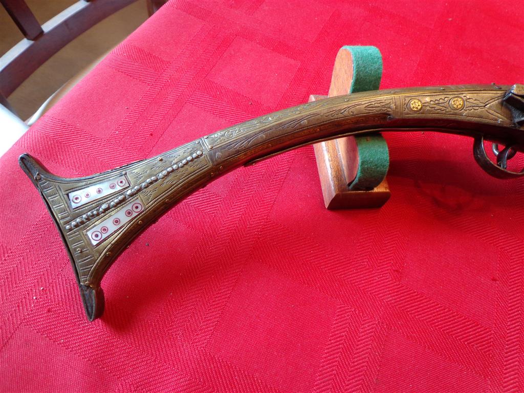

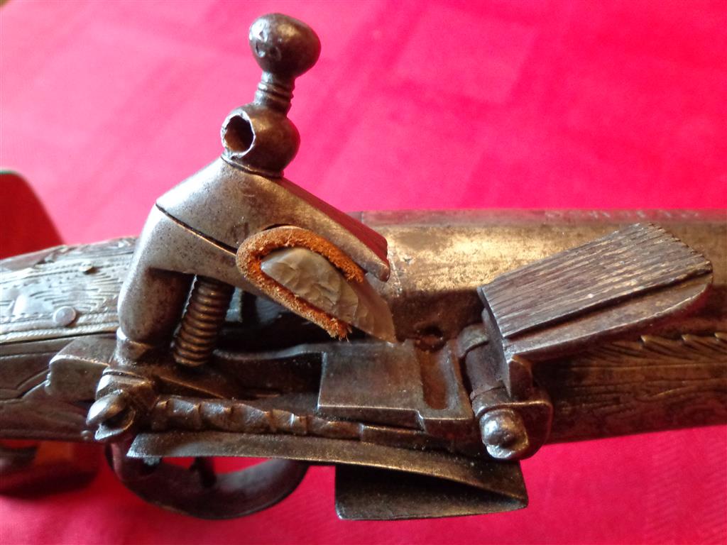

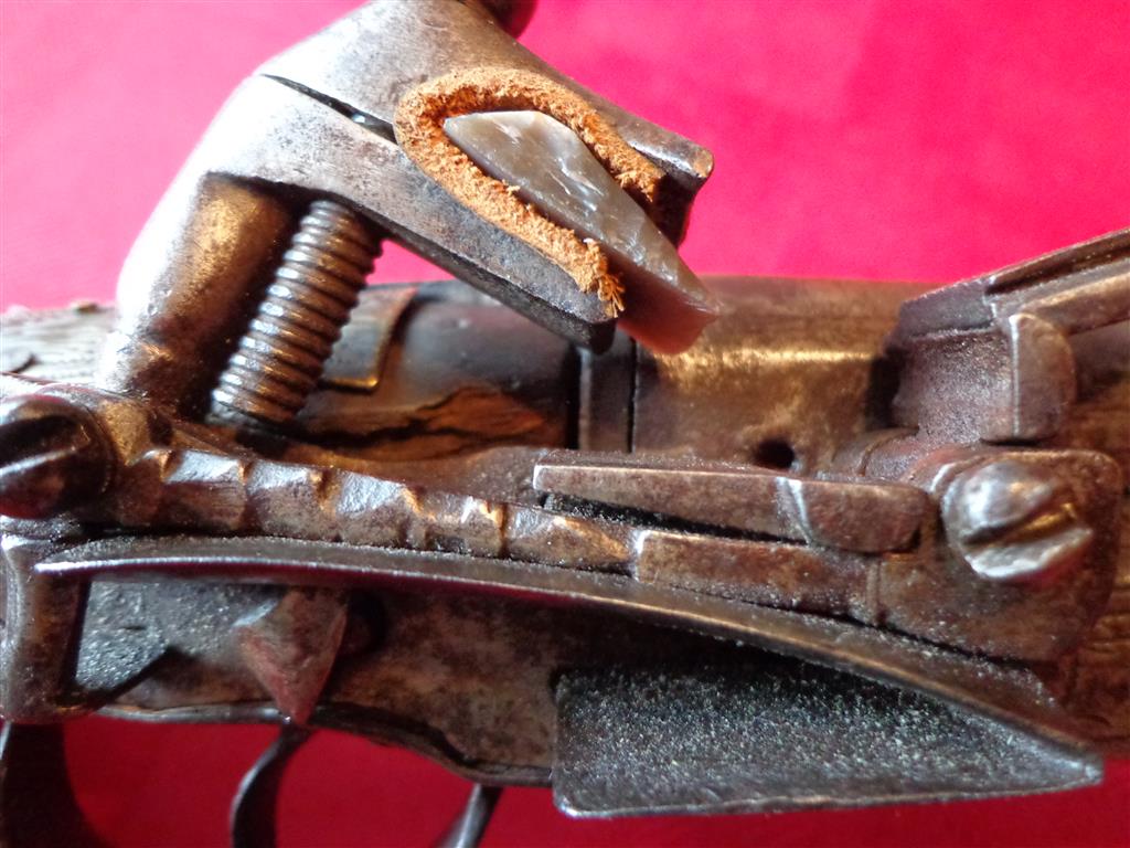

Well, I seem to be experiencing weak moments lately. Which resulted in yet another Albanian long gun. This one is very typical with lots of engraving and some extra nice metal work in front of the lock area. Lock is in working order.
There was likely more than two barrel bands when the gun was built. But they appear to have been missing long ago since you can't really tell where any more were located by the difference in patina on the barrel. Also missing two of the pearl inlays in the butt area. One on each side. But those would be easy to duplicate. Another one that should clean up/restore nicely. Barrel is 46 inches long, 58 1/2" OAL. About .65 caliber.

Rajesh I think the barrel is Italian.
I love your sight one of the best ever seen on this kind of gun.
I like too the lead dots of the butt like the rat tail pistols...

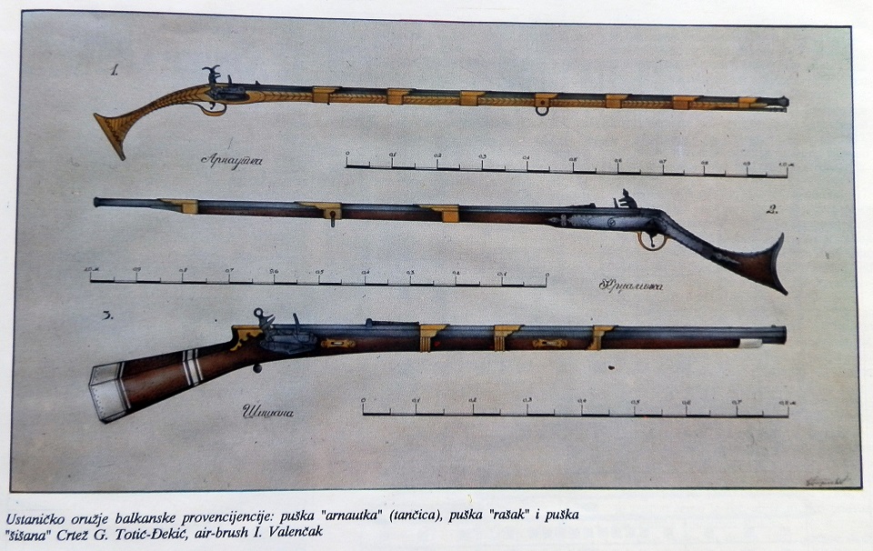

For your library...

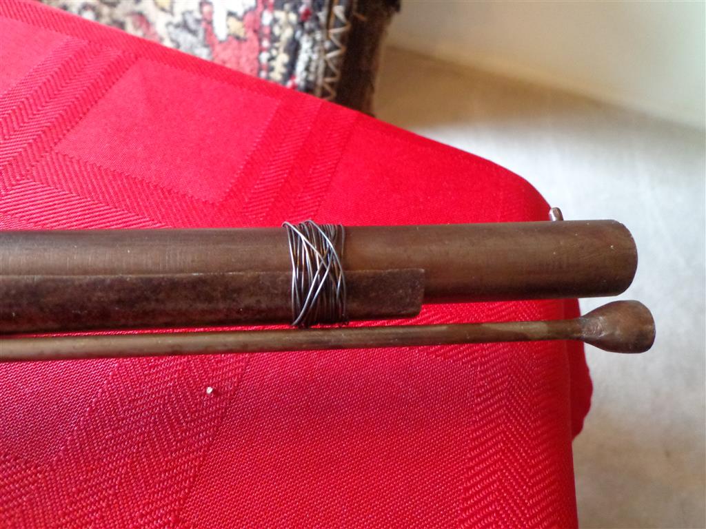

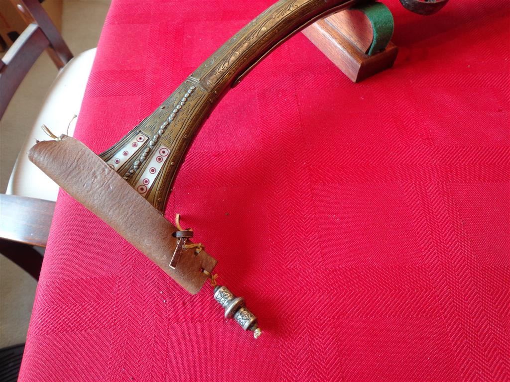

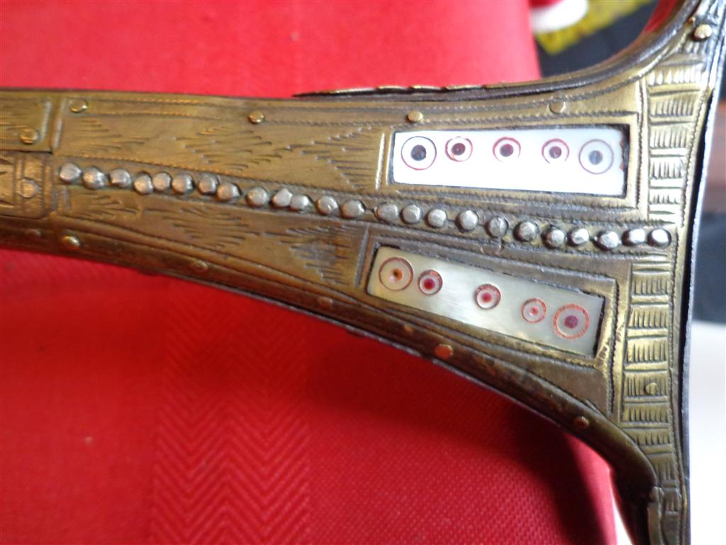

Hello All
It's been better than a year, but finally the Albanian Tanchika "shooter" is finished and ready for test firing. LOL
The barrel is now .58 caliber with a new steel liner inside the original barrel and a new front bead sight installed. A new ramrod was made (original was a too-short later replacement) and threaded on one end for cleaning accessories.
The lock was tuned and now sparks great. The two missing pearl inlays were copied to match the two originals, even down to the little circle engraving and filled with original type red paste. All four were then re-glued in place. Think that turned out well. You can't really tell the old ones versus the new ones.
I have a shoulder sling that I'm going to add but still need to make a couple rings. It's an original sling from a British EIC 1842 Musket. Should look the part. LOL
I was thinking that the small, thin butt stock might be uncomfortable to shoot. So I just made a rudimentary leather butt cover that will slip off and on. LOL
Anyway, here are some later pics of the finishing gun. Hope you enjoy. And thanks for looking. Been a while coming.

Yes difficult to see the difference between old and new, bravo!

Thanks for the comments - and your safety concerns. I always first test fire these guns from a distance using fire cracker fuse first. Just to be double sure.
Actually, the modern steel liner makes the barrel stronger the the original barrel was when new. The gun is now no different than shooting a contemporary muzzle loader.
Have to start on the shoulder sling this weekend. I'll re-post a pic when it's done.
I don't care for the wire binding, but it will do until I make one or two additional bands and have them engraved similar to the originals.
Most of the time in this project was spent waiting for the barrel to return to me.
