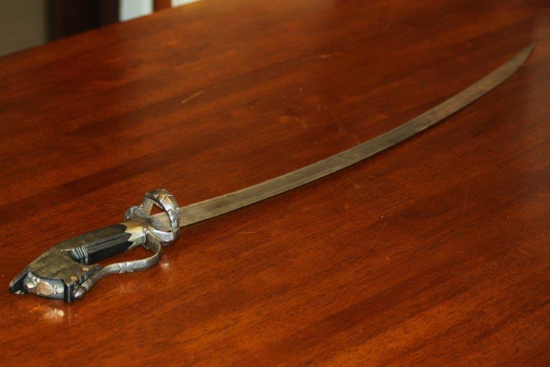

Originally Posted by kronckew

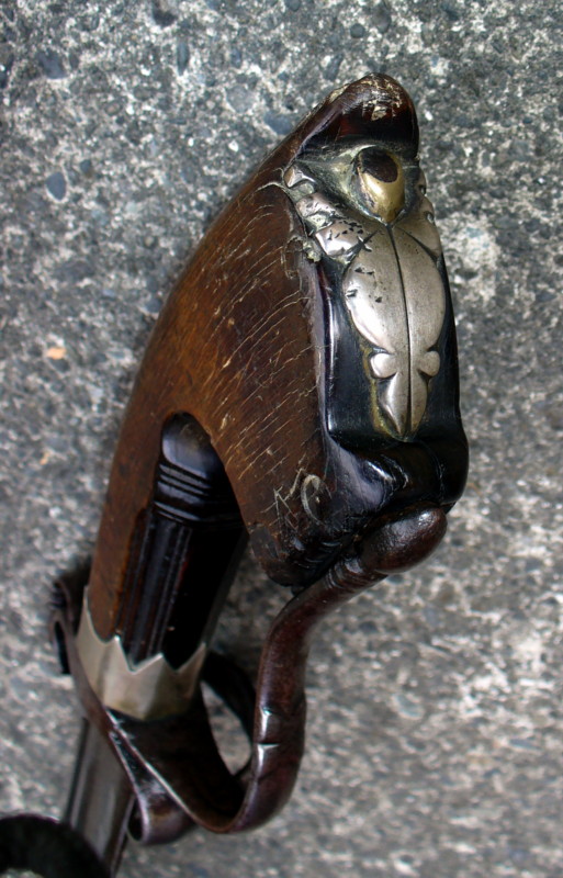

moroccan? berber? spanish colonial? just acquired this one, looks like it was made this way from a local copy of a european trade blade and has been shortened after a break. eyebrow marks both sides, no sign it ever had any guard that i can see. metal plate both ends of the horn grip, pommel one looks like steel. blade 20 in., 25 1/4 in. overall, 466 grams (1.03 lb.) on it's way over from france...
Salaams I saw that the original description by the seller indicated Morocco on this weapon... I can see why they thought this as the blade is similar to other examples from there..and the hilt could be a cut back altered one from that region. I have to say that the eyelash marks are very clear...almost too clear...but that could just be accurate strike marks..as opposed to more recent. Its very difficult especially just from a photo but I would go with that; Moroccan but with severe potential rehacking of the hilt..

my other nimcha (with a guard) has a 35 in. fullered single edge blade.

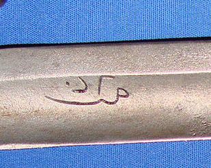

Salaams Kronkew ~ and is dated.
Ibrahiim al Balooshi.

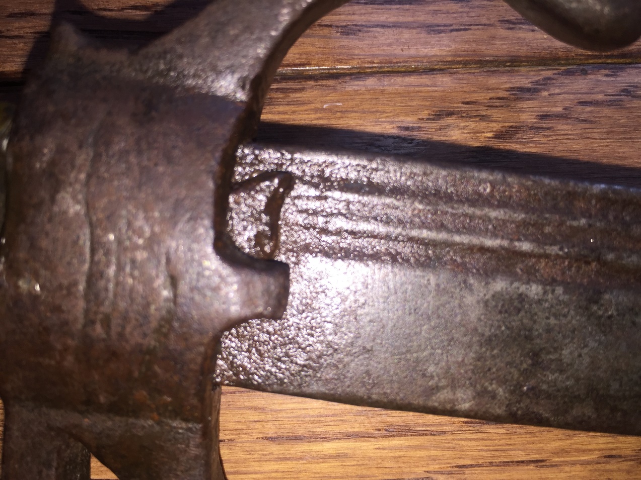

Old 3rd May 2016, 05:25 PM   #49
not sure what it is dated at though
marking:

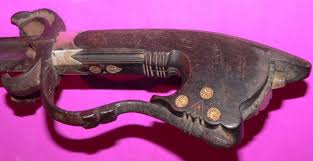

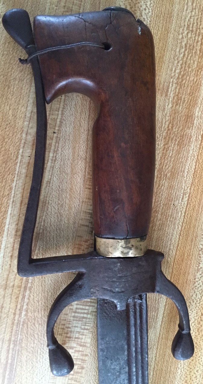

Here's my only Nimcha. One of the quillons is missing. The blade's very thin - you can see where they had to put a shunt in the hilt to make it fit. I assume the blade's european?

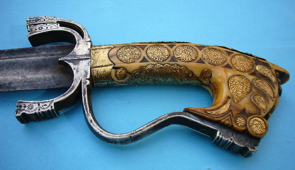

Default Zanzibari Sword Hilt.
Salaams All...As part of a multi layered puzzle with this weapon viz;
On the Zanzibari sword hilt there are three dots often with their gold decoration removed. Does this signify something Talismanic?
The entire hilt takes on an animal outlook... Is it a Lion or Horse designed geometrically?
On top of the pommel are two projections possibly ears?
Over the top of the pommel is what I have previously suggested is a Turtle?
