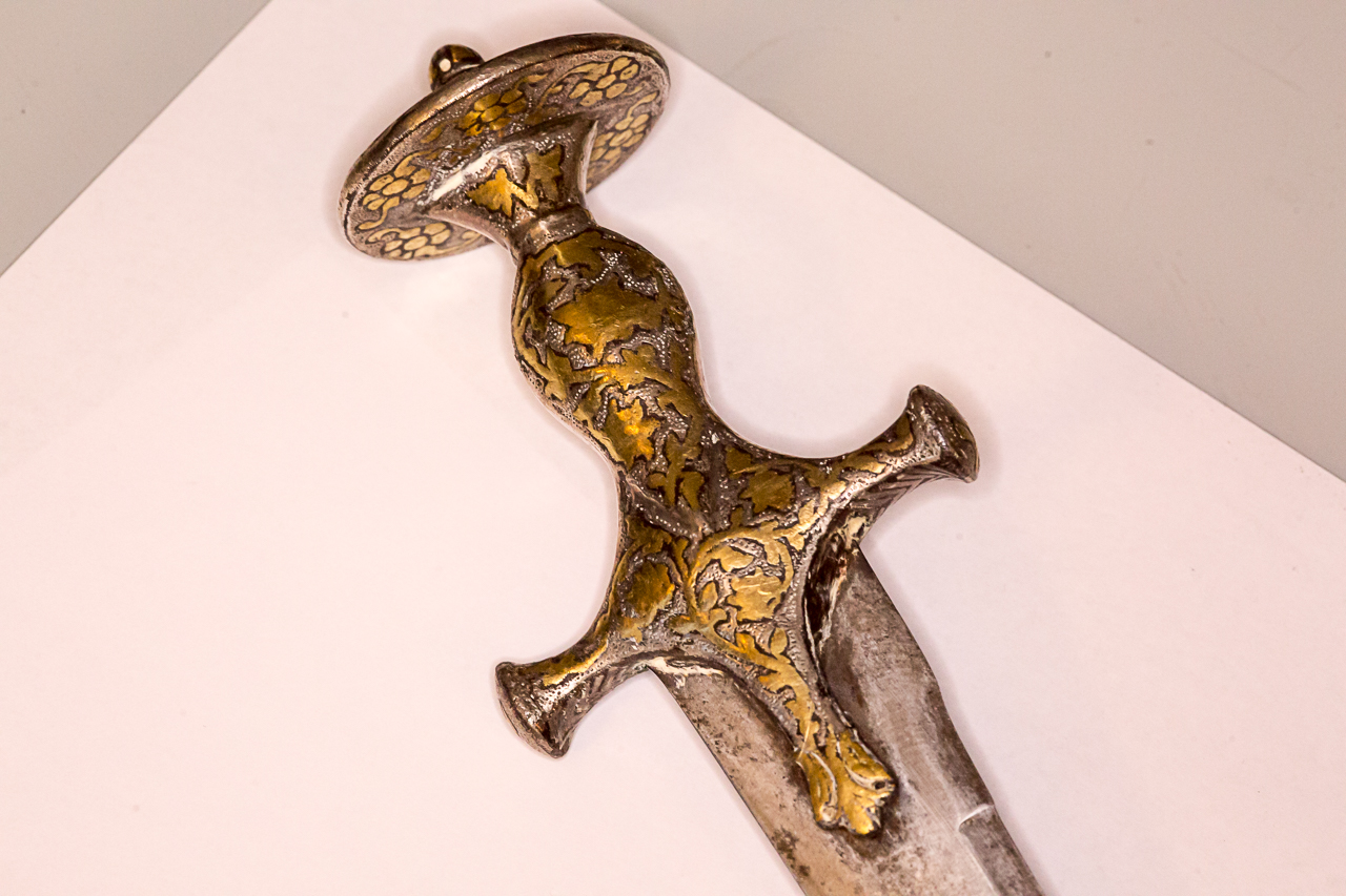

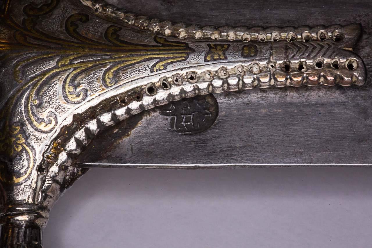

Hi all , here is a gold indian tulwar i own with large indian blade.. can anyone through more light to this sword? it seems to be rajput to me. I also need help with the inscription that is on the blade. Can anybody help with the translation please?
I can see the sanskrit letter S
thank you!

Maybe I am wrong but I would say recently made. So in my opinion the stamp doesn't even matter.

Please have a look at the ricasso, then at the beginning of the edge. To me, the ricasso appears to be very flat and rather thin, like cut from sheet steel, then the blade was given an scandi ground edge.
The hilt also looks suspiciously new, almost no losses to the koftgari.
Not to mention the golden koftgary on silver background which is a rather recent trend.
Also the spots of acid etching on the silver background of the hilt look very suspicious.
I would also like to hear what others have to say.

its 100% antique and not a reproduction.. the blade is very thick and heavy and not formed from steel metal..
I do own another example similar with gold and silver work. You can get nearly mint antique koftghari tulwars but they set you back a arm and a leg..

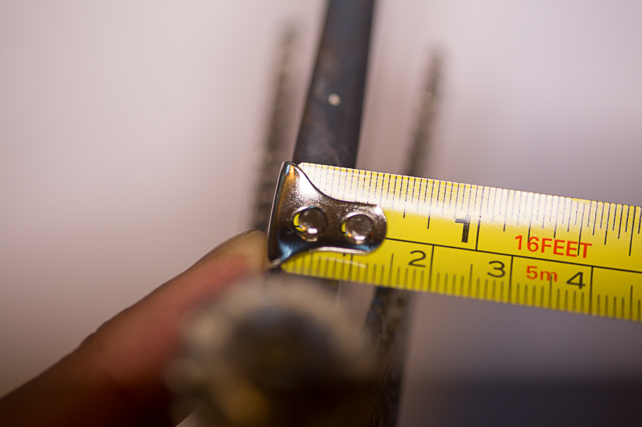

It is hard to say from the pictures. but I have seen other hilts of this type, not with quite the same decoration, with blades marked with a Kishangarh etchings, and I have been told about another woth an etching from Rutlam State 1876.
How thick is the blade?
Can you write the letters down under the langet?

Hi Jens , i'll measure the thickness of the blade and get some more images for further research. I'll post new copies of this hilt too for comparison.
I will try and copy the stamp also..

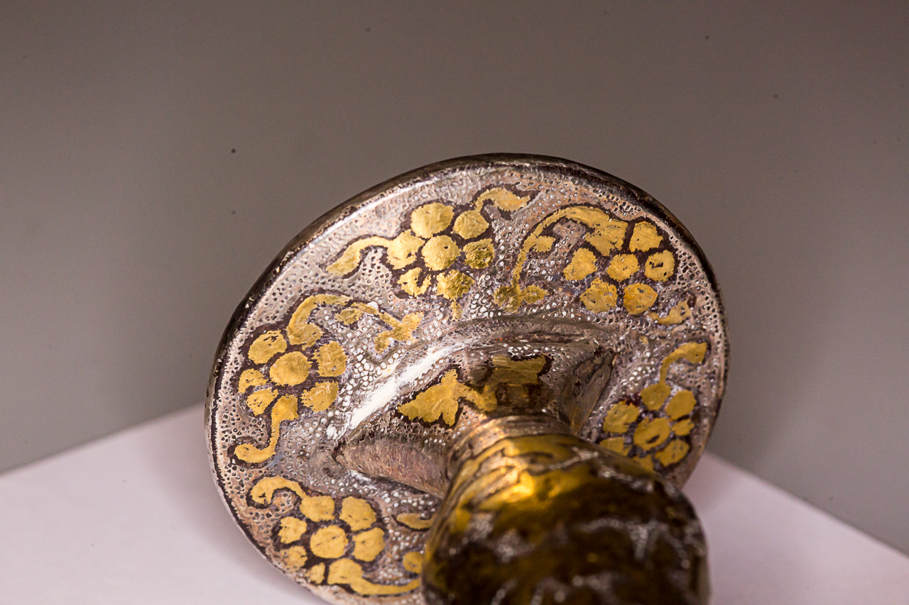

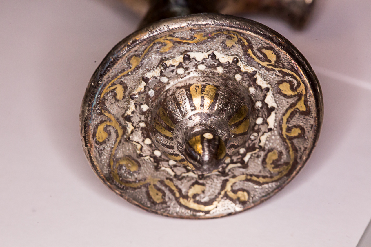

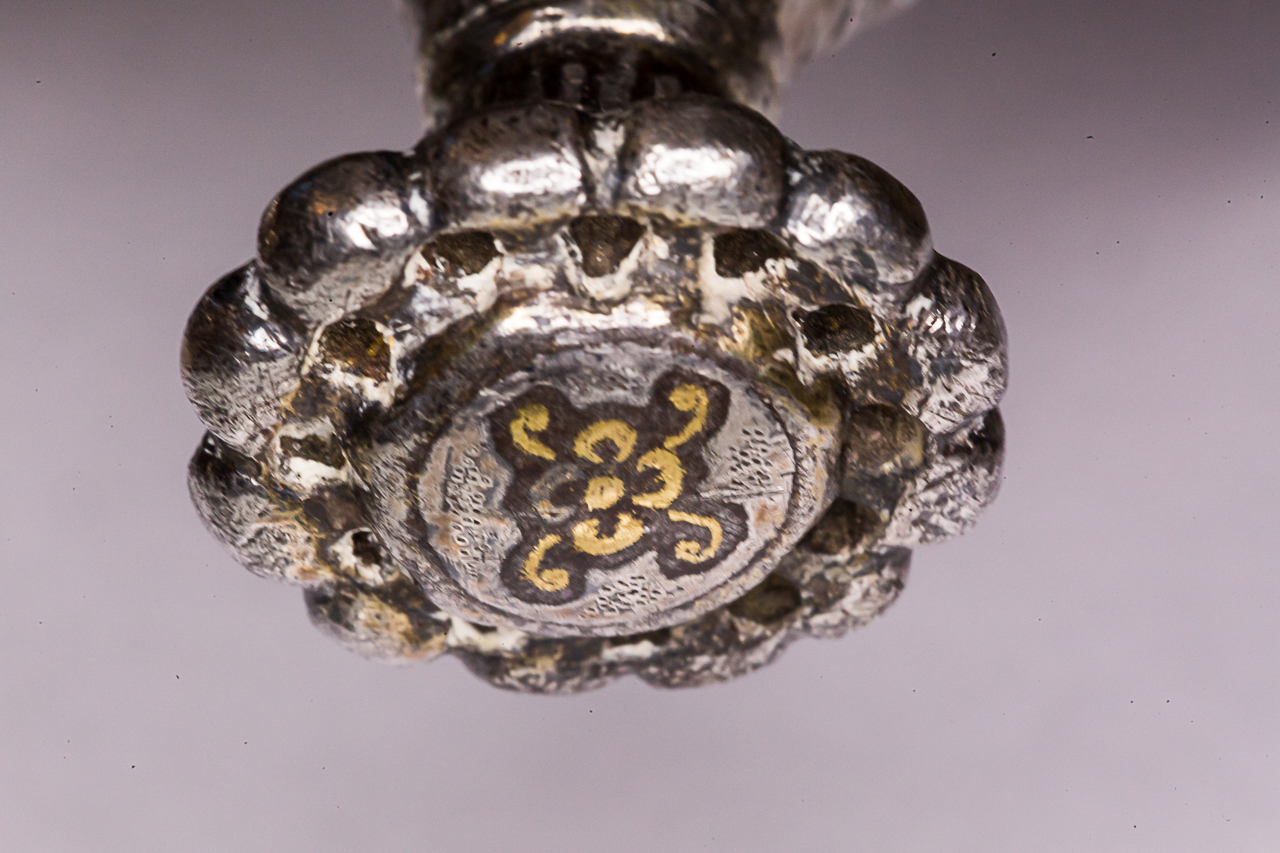

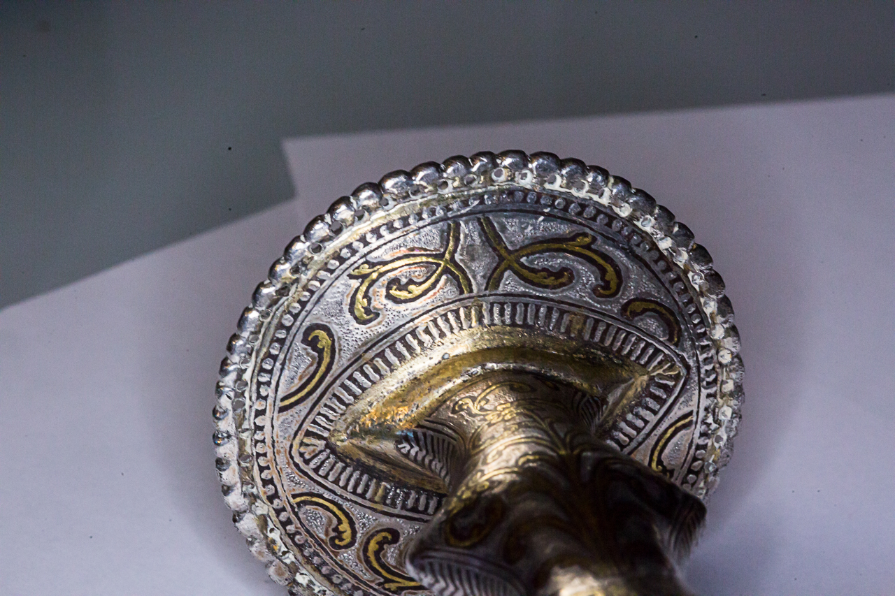

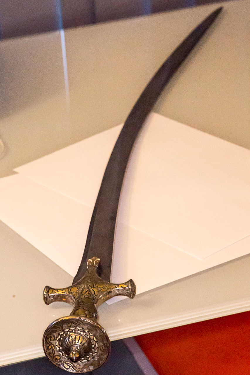

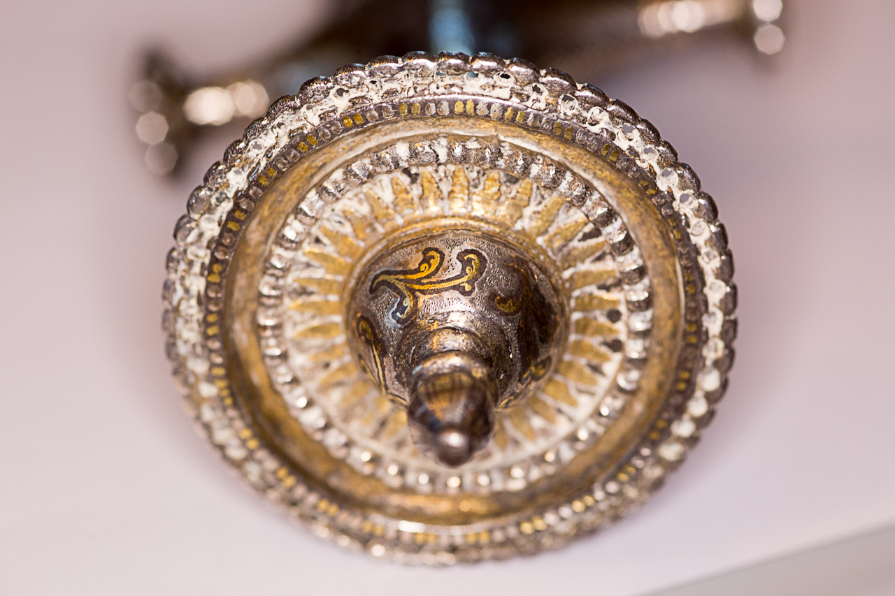

This sword is a beast... 37inches top to bottom of the hilt. Blade is 34 inches.. Here are some close ups. The white residue is the excess wax left on... Any ideas how to remove it without upsettng the koftghari? heat gun?
AkaaliSingh is offline   Reply With Quote

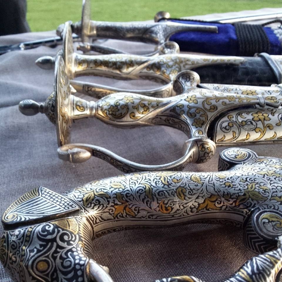

Here is another silver and gold example.. again abit white residue all over due to too much wax.. apologies.

Here are examples of new gold/silver tulwars..
