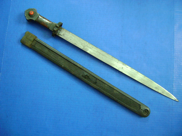

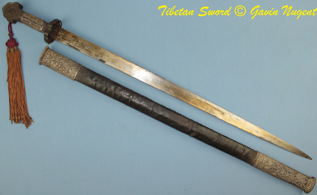

One of my major loves is Tibet and Bhutanese weapons and I've been lucky enough to have sourced some very fine examples from the regions.
Below is one such sword that I'd like to share.
The sword is 102.5cms long out of its scabbard and the long tapering single edged blade shows a very fine tapering hairpin pattern which points to the blade being manufactured in this manner, not modified from the typical hatchet tip type. Of interest is both the edge and spine taper to create a symmetrical profile. Whilst I have seen many much shorter variations with this blade type, this is one of the very few I have noted at such an impressive length.
The scabbard is also unusual in that it is only repousse silver fittings over leather with some very unusual designs to the silver.
The Tibetan swords with the typical hatchet tips, to me, when swung, are usually committed and beyond the point of return, ideally suited to horse back.
This sword is akin to a fine Chinese Jian which is perfectly balanced for a deadly slash or thrust.

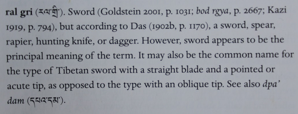

Gav, this is an absolutely astounding example of one of these Tibetan swords!!! which has led me into researching some old notes as it is (as far as I have known) almost unheard of to see a sharply pointed blade like this.
The usual blades on these swords, which I have discovered are not typically termed ke tri as long believed, are of course the rather hatchet tipped single edged blades.
Apparantly (and according to Donald LaRocca , "Warriors of the Himalayas" Rediscovering the Arms and Armour of Tibet", N.Y. 2006) this particular example refers to the RAL GRI.
* RAL GRI: sword type with usually shorter blade where tip comes to an acute tapering point (in manner of Scottish dirk).
The regularly seen Tibetan sword with hatchet type point is termed DPA DAM (also Pa TAM).
The Chinese ancestry of these comes from the ancient 'zhibeidao' with straight SE blade with oblique or angled tip.
It is noted that these RAL GRI swords were typically carried by Tibetan chieftains, and a reference cited to Lt Col. Laurence Austine Waddell, consultant on the 1904 Younghusband expedition into Tibet, he notes,

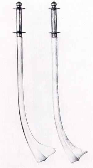

Jim,
Thank you for giving it a little bump to the top. Shakethetree and Ariel, thank you for entering the discussion, it is nice to see some life put in to such a rare and interesting sword and to view other examples.
Ariel, Jim, I have not here or elsewhere that I can recall in recent times, referenced a native name to these sword types but Jim, you're spot on with the definitions as far as I know them.

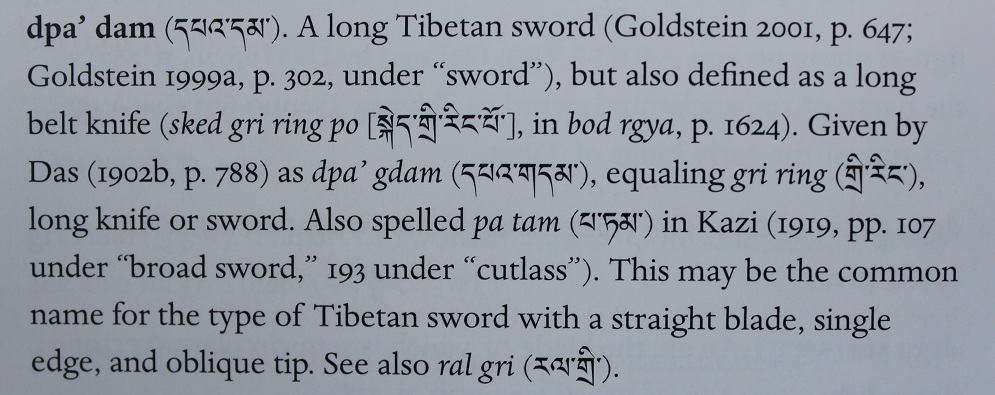

With reference to sword type names, I have attached photos from LaRocca's exceptional work, particularly the glossary of terms in the back of the book, see below.
Shakethetrees, if you do not have the book noted, spend the $40-50 to own a copy, it might cure your need to buy the sword types.
Gavin

Dpa' dam is listed by LaRocca as Sked Gri. Is it Ke Tri, pronounced slightly differently?
Are there differences between spear-pointed and hatchet-pointed blades?
One needs to be born in in a monastery in Lhasa to figure out how to pronounce those convoluted strings of letters:-))))

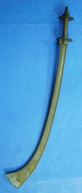

Originally Posted by ariel

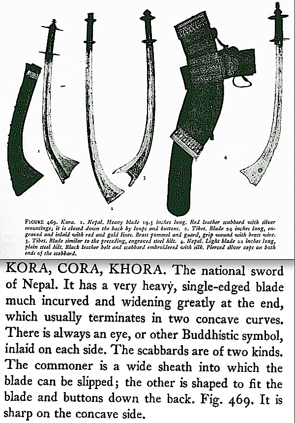

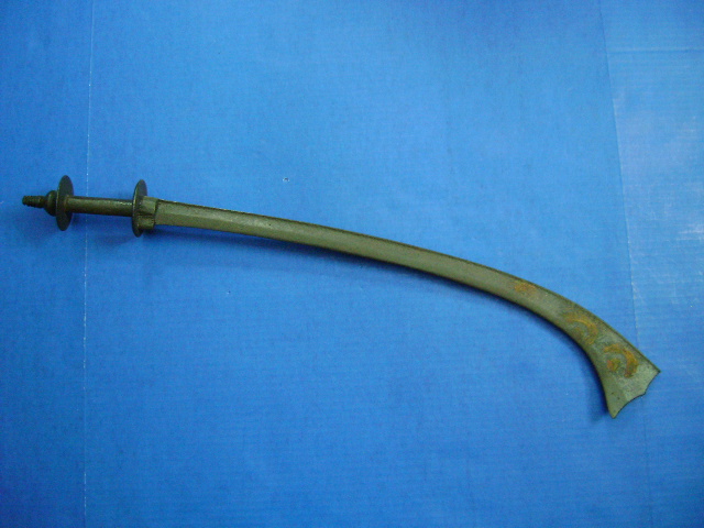

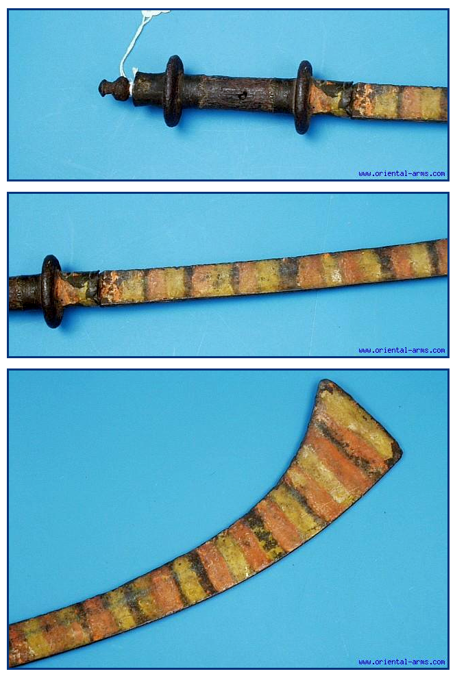

And, finally a Kora, purportedly Tibetan because of its slender structure ( not sure if it is true).

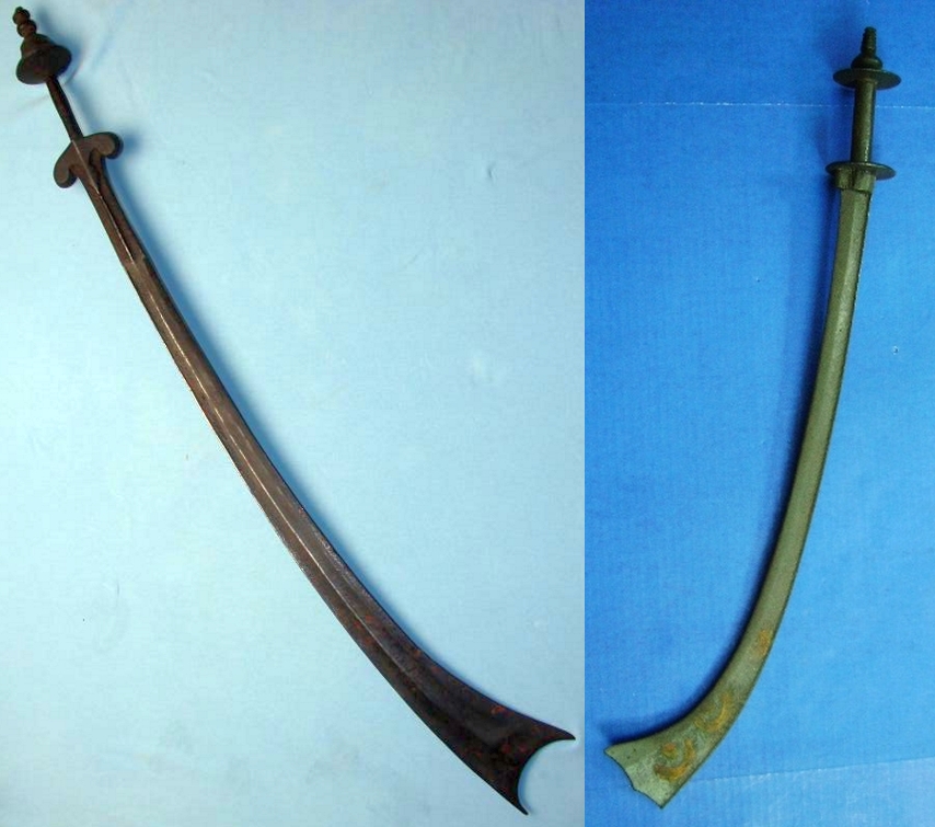

Ariel, here is a kora on the left that Gavin sold which he identifies as Tibetan compared to the one you posted which appears to be be from Nepal but someone with more knowledge might comfirm this.
Old 13th March 2016, 01:24 PM   #16
Gavin Nugent
Gavin Nugent's Avatar
Posts: 2,818
Nice Kora Ariel,
I'd be inclined to pin yours down as Tibet too.
To my eye but without formal factual data to back it up, the rounded Stupa pommel arrangement, the form of the disc guard and the slender blade point to Tibet for me.
I'd love to replace the very early Tibetan Kora I sold years ago but the wheels must keep turning so other treasures like the Tibet sword can be obtained and studied.
Gavin

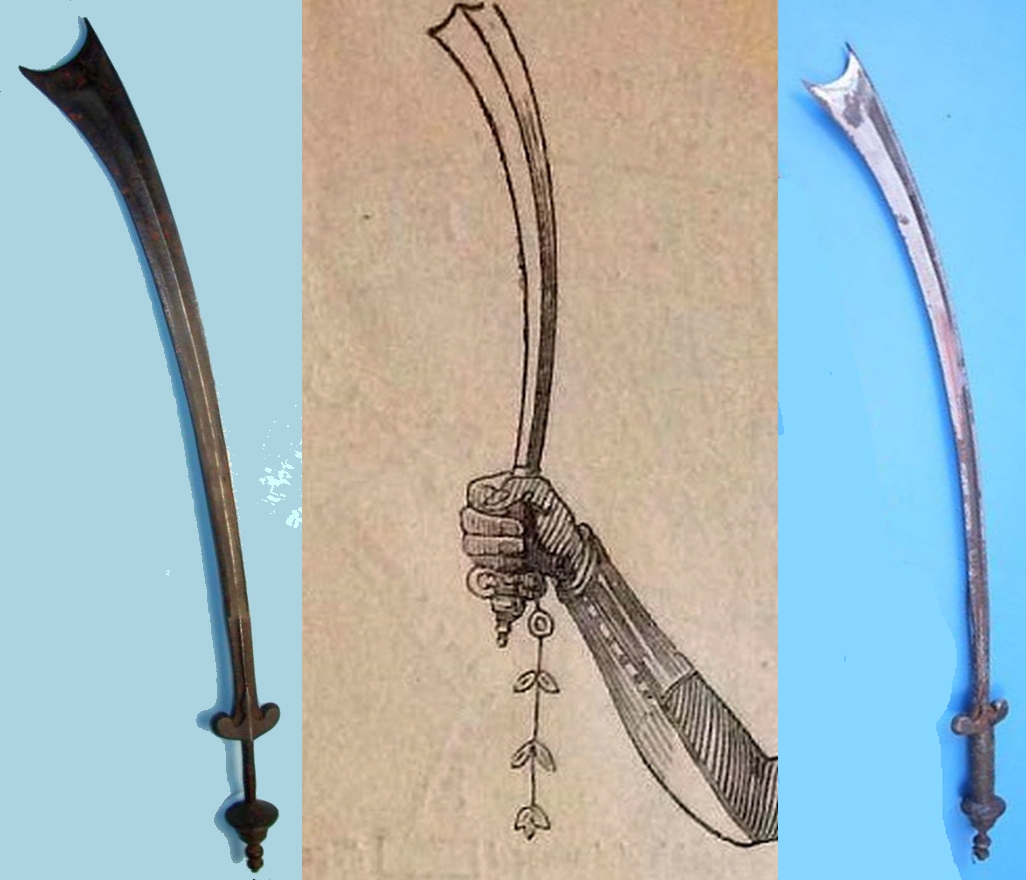

Perhaps a new thread or an old Kora thread should be revived....this image of a Sikh holding a Kora, although a line drawing from the 19th century puts an alternative perspective on the early type when viewing the hilt.
Gavin
Old 16th March 2016, 09:30 AM   #18
poor guy looks under armed. needs a couple of quivers too. and a few more knives.
Old 16th March 2016, 02:27 PM   #19
dennee
Location: College Park, MD
Posts: 186
I'd love to see any solid attributions of 'koras' to Tibet. There were certainly examples found there, whether or not any actually originated there. There are some early to mid-twentieth-century photos of religious dancers with koras, and these are of this type: narrow, with a very convex end.
But I haven't seen koras in other period photos or paintings from Tibet or in monasteries. I have seen talwars, 'katars,' Indian shields, etc. Weapons made their way into Tibet in any number of ways (including Gorkha invasions), and many were donated to the protector chapels in monasteries. Koras may have been attractive for ceremonial use because of their exotic appearance and origins, rather like the flamboyant archaic Indian sword forms remaining in Buddhist art.
One could certainly argue that the medial ridge found on this type has more in common with Indian swords than Tibetan, which were more heavily influenced by Chinese weapons. (Such a ridge is probably structurally necessary on such a narrow sword.) Of course, we lack truly ancient Tibetan swords (although I hear there's a sword in Bhutan that is said to be more than a thousand years old, although I believe it was derived from the Chinese pallasch, as you would expect).
There also appear to be rare examples of what folks have called "Tibetan" kukris, presumably made in Nepal using hairpin-laminated steel. I don't have any photos, so I don't know if they were made from scratch or fashioned from Tibetan trade blades.
dennee is offline   Reply With Quote
Old 16th March 2016, 05:32 PM   #20
Posts: 10,860
I agree with Dennee, it does seem that the kora in Tibet would be an anomaly, but certainly not entirely discounted on an incidental basis.
As with most cultural diffusion with arms, any number of circumstances might account for these, but as far as a regularly present form of weapon in Tibet, the kora seems unlikely.
Gav, that image of the Sikh holding one of these very forms of kora is phenomenal!! and I am wondering if perhaps the connections between Nepal and Rajputs might account for this seemingly hybrid form of kora. As Dennee has mentioned, various forms of such hybrids have been seen as the tulwar hilted types, usually it seems in upper Bengal, and Nepalese regions.
It would seem that as closely as Rajput and Sikh were regionally to the west, that movements of such forms might have traversed into these areas, or perhaps the Sikh portrayed may have been alternately in more eastern area?
The tulwar hilted kukri is also well noted, and seems part of these hybrid anomalies.
When we first considered identification of this unusual kora bladed weapon of Gav's, it seems the Stone classification was the primary basis.
Gavin
Here is a comparison between Gavins kora (lt) and a kora from Artzi (rt), with the Indian kora drawing in the middle, with Gavins being described as Tibetan and Artzis described as being Central / North Indian. The Indian kora drawing has a different blade type and hilt. Gavins and Artzis kora seem to be of the same type.
Below is George stones kora description with Arials kora on the bottom right, which looks just like the kora that Stone describes as being from Nepal. Both of the kora that Stone describes as being from Tibet seem to have a different blade type fron the Nepal kora.

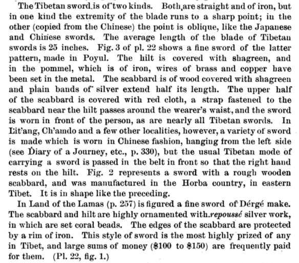

Dennee, what are the documented examples again? As for Stone, he may have been right but that is not much to go on, were did he get his information from?
Notes on the Ethnology of Tibet: Based on the Collections in the United States National Museum, William Woodville Rockhill, U.S. Government Printing Office, 1895.

Most interesting is the 19th century image of a Sikh clearly depicted with one of these, and begs the question of why a Sikh would have a weapon of presumably 'Tibetan' form. We know that the Sikhs indeed did 'invade' Tibet in 1841 via the Dogra's (their Rajput vassals) ....however this would not necessarily account for a Sikh brandishing this weapon.

We know of the kora in traditional form as well from 8 examples in Copenhagen (from East India venture by Denmark at Tranquebar c.1620) which were catalogued 1674 and 1689 but of course collected earlier.
These seem to be a bit longer and narrower blade form (attached B&W photo).

Another non typical kora said to be from Bhutan.
Kora sword from Bhutan, early 18 century or even earlier. The 23 inch, down curving blade is painted black. yellow and red for the ceremonies referred to as Dashera or Dasein common to the Hindus in the Himalayas. The cylindrical grip with small disk shaped cross guard and pommel are typical to the early type Kora swords. Total length 29 1/2 inches.
