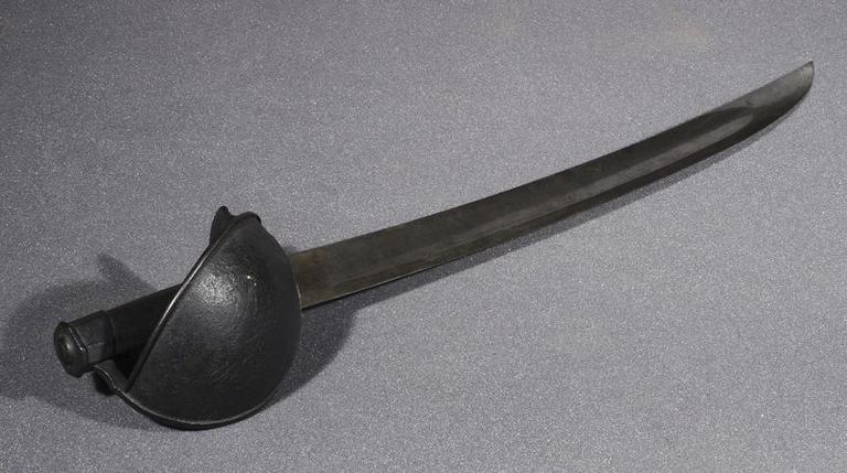

A friend found this saber in his grandfather's barn in northeastern Pennsylvania, probably about fifty years ago. The blade is 26¼ inches long with an overall hilted length of 36½ inches. There is a short ricasso with stamped marks - one is a W under a star within an impressed shield shape (not the teardrop as in the image below) and another much less well struck possibly with a P inside an impressed circle or oval. The opposite face of the ricasso appears to have a 'G' mark. The back of the blade is flat but it becomes sharp in the final 5½ inches. The body of the blade is mostly a wide shallowly convex fuller with a narrow bevel to the edge. The hilt is missing the guard (indeed, the hilt had been stuck back on backwards for longer than I have lived), but it is clear that there was a knuckle guard once that inserted into the pommel. The grip and pommel are covered in sheet iron which may be seen to be over a wooden core.
The blade looks to be of military type and I'll speculate later 18th to mid 19th century. I am not sure that I can place an octagonal iron clad grip, but that makes me suspect militia. So possibly something from the American Revolution up through to the War of 1812?
Your suggestions are welcomed!

Hi Lee,
it looks like the French naval sabre d'abordage model 1811 or 1833, apparently it was also in use in different countries.

Lee, many of these were imported on both sides of the US Civil War.
And of course, both sides copied these styles as they made their own and well in the same war. This could easily be US therefore.
However, I am not saying this is US Civil War, and after looking at some info on Revolutionary War blades, it might better with 1812 range, like what Ulberth is suggesting?

As Ulfberth pointed out, this is the French boarding cutlass M1811 or 33 (so hard to tell those two apart!). Battara makes a good case for possible CW usage as well. If I had to guess, I'd say Civil War over War of 1812.
I am assuming by 'barn find' that it was hidden in the rafters or some such, versus just hanging on a hook? If it were in the South, I'd have laid odds on a Confederate piece. Like the American colonists before them fighting the Brits, times were tough and weapons scarce. Southern fighters often carried parts-swords or blacksmith made weapons into battle, such as the so called 'Dog River swords'. These weapons were often stashed in walls, under floors and in old barns to prevent them from being seized by Union troops as they made their way through the towns. I've seen swords from the Mexican War, French imported swords, etc, used by the Confeds. Being from PA, this logic doesn't quite hold, UNLESS it was a war trophy/seizure, which was also quite common. Being that it is the remnants of a naval sword, it very well could have been carried by a rebel blockade runner sailor.
From the look of it, the sword looks like it was still in use in its present form, meaning it isn't just a remnant with parts fallen off. Likewise, I don't think it's a post-war put-together made to whack cornstalks with. During the War of 1812, we weren't so desparate for weapons that we needed to fight the war (American contractors like Nathan Starr and Rose were putting out cutlasses in droves). The only final possibility is that it was a French used cutlass used by a French privateer. As a private purchase sword, it could have been a parts sword (to save on cost), made for the 1812 War (France vs Great Britiain with lots of French piracy going on). Well, anyway, my 2 cents...

Excellent catch Ulfberth! That surely does look like those French cutlasses, but anybodys guess what became of the guard.
Mark offers some compelling suggestions toward the presence of this as a possible privateer weapon, and it seems these regulation patterns often ended up becoming altered for any number of uses when out of their original context.
The absence of the large guard makes this resemble the machetes which were becoming well known in tropical colonial regions, and usually without any type of guard. French locations such as Haiti and other Caribbean locations might have been the source for such an altered sword. Being found in circumstances such as barn, garage etc. in modern times does not mean this was its location permanently. This may well have become a souvenier or carried via trade contacts which often went from these locations to American ports of call.

Ulfberth, I think that you have surely 'nailed' it right on the head! The owner remembers swinging it around in the barn as a child. I'll ask if there is anything in the family history that might favor any of the possibilities pointed out by M. Eley. I know that my friend also has what he believes is an American Civil War naval officer's sword along with a picture of the original owner in uniform wearing it! I'll see about getting pictures of that and will report back whatever else I learn.
The flat back did make me wonder if the blade were French, but there were no remains of any engraving there. So, I do not feel totally ignorant and my friend will be thrilled that with your help the original origin has been identified. Thank you all for your assistance thus far!

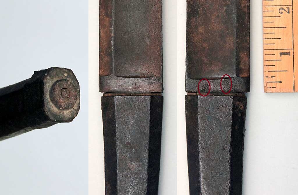

Check the back carefully near where the guard meets the blade. The manufacturer and date should be etched there.

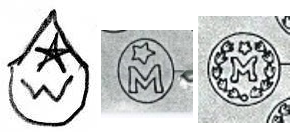

I think these are two controleur stamps, the one seems the be a B and the other could be an M instead of a W, that would place the sword right into the period of the Napoleonic wars.
I cant be sure, the stamps are not clear enough.

Yes, that sure is what immediately comes to mind but, the design of the shield/escutcheon and the relative position of the star don't concur

They do Fernando they do, but due the condition of the stamps and the pics it could be the one or the other, perhaps this distinction can be made IRL.
I have seen hundreds of these stamps IRL and if the blade is rusted ot pitted its easy to mistake the one for the other.
Thats way I stated " it could be" and " I cant be sure the stamps are not clear enough"
I got confused with what my friend had told me; there is a Civil War sword descended in the family, but the naval officer apparently served in the Spanish American War time frame. I will get further details.
Because the blade looked 'French' to me, I had carefully searched for the usual script engraving along the back spine near the grip, but there was no trace. It may have been obliterated by rust.

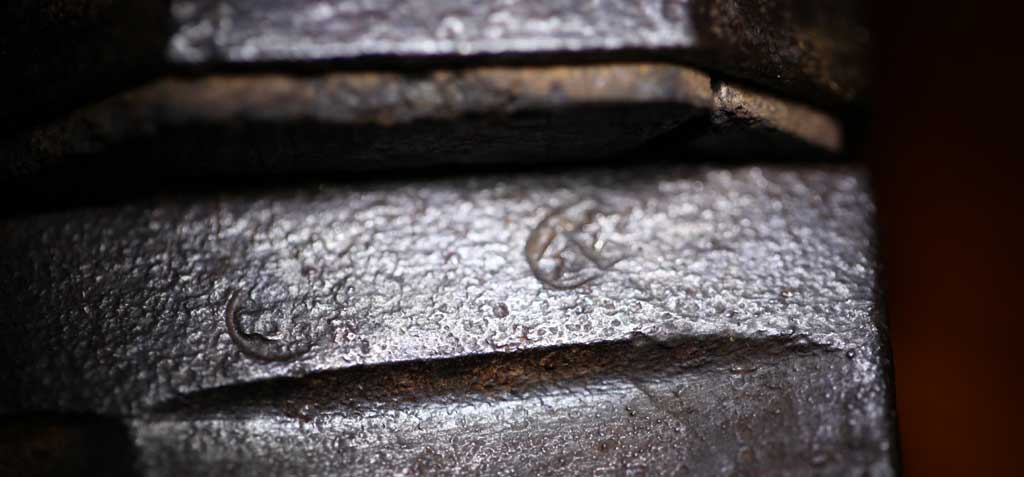

My lighting unfortunately does not do a great job with the marks. Holding a LED flashlight close disclosed the 'star over W within shield stamp' fairly clearly. I will see about getting someone to hold the flashlight while I try a close-up and that should provide a clear image of that mark.

The images looked a lot better on the camera preview screen, but here is the best one for what it is worth...

I think these are the identical blade marks; unfortunately depth of field issues prevent my close-up photo from properly showing the top of the shield in the star over W mark, but it is pretty clear to the naked eye with the sword in hand. Thank you all again.

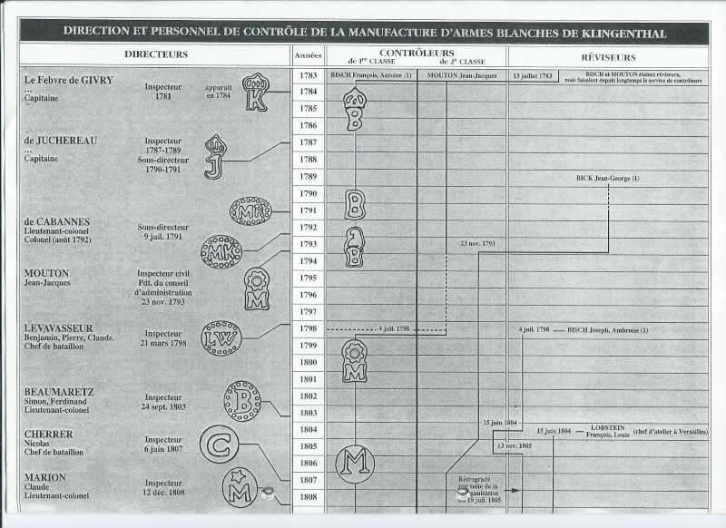

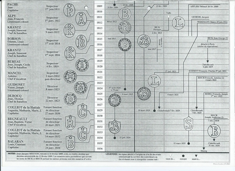

I came across a list of poincons for Chatellerault today while looking for something else.
I found the W with star above in the shield which relates to S. Wideman controller First Class from 1836 to 1843.
He was plain W without the star - second class - from 1829 to 1836.
The director between 1837 and 1839 was C.L.C Dupont de Pontcharra whose stamp was a P with star above in a circle. If that is the same as your P stamp it would date the blade nicely to a two year period.

That was great work, CC! And Fernando for confirming that the mark existed from that article. Considering the date of manufacture, we can rule out War of 1812 and privateering.
