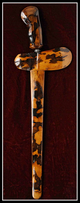

Old 27th September 2015, 11:56 AM   #11
Keris tangkis example.

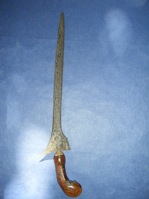

Old 17th February 2021, 10:25 PM   #15
Posts: 7,302
Originally Posted by Gustav
On Lombok different Pamor on each blade side is called Pamor Seliwah, according to Ir. H. Lalu Djelenga.
i am resurrecting this old thread because i just encountered this name Pamor Seliwah regarding such pamor in Lombok in another place so this can confirm that name to a certain extent, though it is quite possible this other source got this info from Ir. H. Lalu Djelenga to begin with. I believe in Jawa this would also be referred to as keris tangkis.
Here is my humble example.
