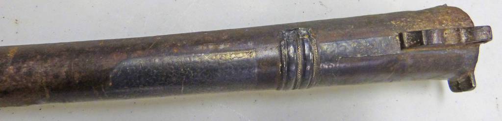

A while ago I purchased this matchlock Torador barrel.
It is still in the UK at present, but would value opinions on it.

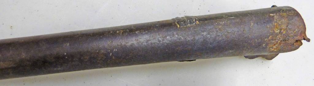

The first pictures are as it came into my friend and agent's hands, and the latter pictures are after a very light and not at all thorough cleaning.
I gather the bore is 'lovely and smooth' so that is pleasing!
Now, do you chaps have any idea where about it came from?
In Eggerton's book, there is a depiction of a barrel with quite similar decoration and attributed to Oude. Does this sound right ?
Any ideas of age? Yes, I do know dating any arms from India can be very difficult as the styles remained fairly static over long periods.
Overall length 52 inches.
Thank you for your time,
Richard.

Love the silver koftgari. Would be interesting to clean and etch to see if the barrel is a twist core damascus.

That is a really nice Torador barrel. With some very nice hammer decoration and silver mounts. Please do post additional photos after you receive the gun. I would like to see what the breech plug looks like. The barrel looks very early.
The pan appears to have been made without a movable cover. And your contact mentions the bore is in very good clean condition. Hmmm. After you receive the barrel, see if the outside patina on the barrel is the same color/shade all around. Or if it is a differnt shade of patina on the lower half (under portion) of the barrel, which would be the evidence the barrel was in a wood stock.
If the bore is in good shape, and the patina even the length of the barrel, it could be this barrel was completed, but never mounted to a gunstock. (?)
Your new pics will be interesting to see.

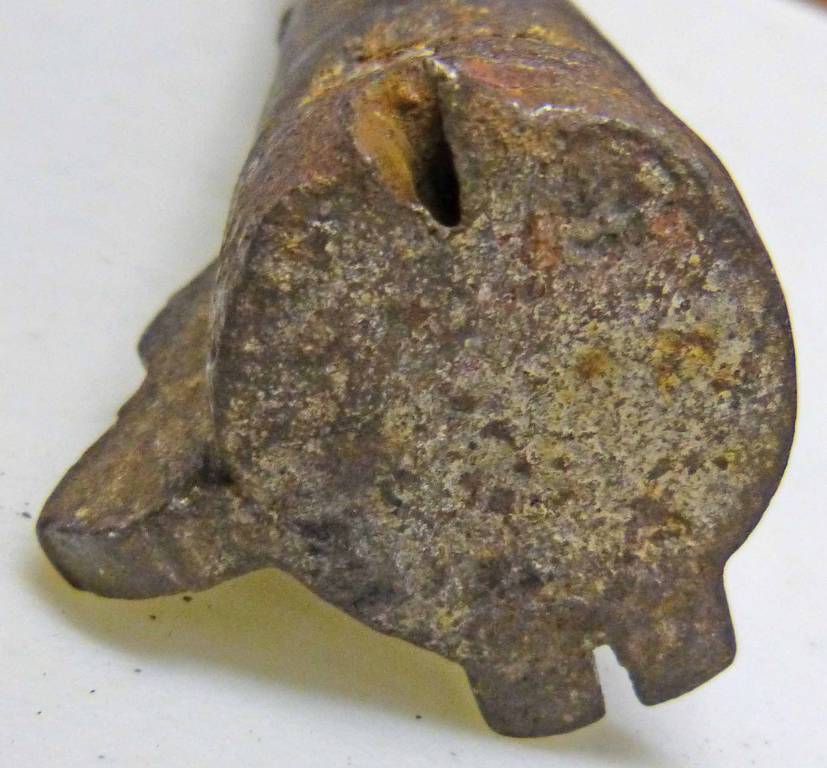

I have some extra photos I cam attach for you. Plug doesn't show well, and appears forged in place as to be expected.
The recoil lug appears to have been pulled out on this one, either through accident or yanking the barrel from the stock without removing the pin.
To answer your question;
It would Appear to have been in a stock at some time, but not at all recently.

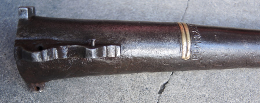

Thanks so much for your response. I was just wondering if your barrel was plugged in the same manner as Stewart's and mine. And it sounds like it is. I've seen one other variation of plugging the breech using a fairly thick, flat plate with a notch cut in for a rear sight. The plate is just slightly larger diameter than the breech of the barrel. The barrel they cut up in the "Mughal Matchlock" YouTube video had this style.
Sorry to hear your recoil lug is missing. But that seems to add proof that the barrel was mounted in a stock at some point.
Yes, it's obvious some of these barrels were made without pan covers. With the barrels being made so robust, I've wondered why the pan covers were made of such a thin piece of metal? It seems that most of the barrels you see today have the cover broke off. I'm going to have a new cover made for mine using a bit thicker iron, since mine is already missing.
Thanks for the Link with that list of guns. Super interesting!!! Especially the notes of barrel decoration.
By the way, the length of my barrel is 55.5".

Thanks for the additional photos. I can see your barrel is sealed up similar to mine and Stewart's. If you want, I can take close up photos of my recoil lug for you to use when the time comes.

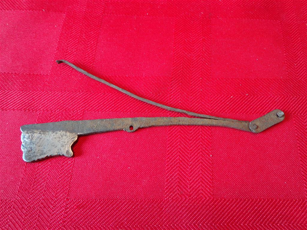

Meantime, here is an original Torador trigger bar and spring assemble, still in working order.
Rick.

Thanks for the photo of the spring and scear arm. Not actually seen the 'guts' before.

Yes, it might be the only original "spare" around. Neven seen another for sale. I pick up those parts as I find them in case I or another collector has a need at some time.
