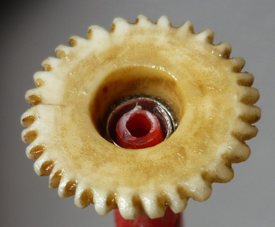

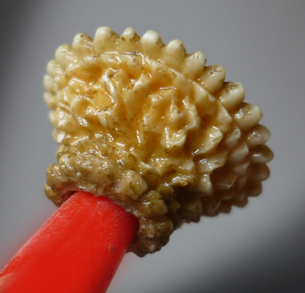

Pick up this old topic to introduce a genuine old mendak.
Unsure about the material. Could either be ivory (no schraeger lines spotted) or deer / antler? Small repair needed at the bottom where a chip was broken off. Very white dense from the inside.
Any suggestion about it and which handle (Solo / Djogja or even Madura) is best to combine?

I doesn't look like ivory Paul. Could be bone or antler. Could even be resin from the looks of it. Is there a thick layer of shellac over it?

Posts: 205
Just oiled it and it should soak a bit (it was very dry) so that's why it appears so shiny.The structure is very dense so I doubt if it is from bone.

I might suggest that you wipe it dry once you feel it has soaked enough and re-photograph it. The oil is a bit distracting to the subject at hand.

Posts: 205
More interested to know were it comes from than the material itself.
