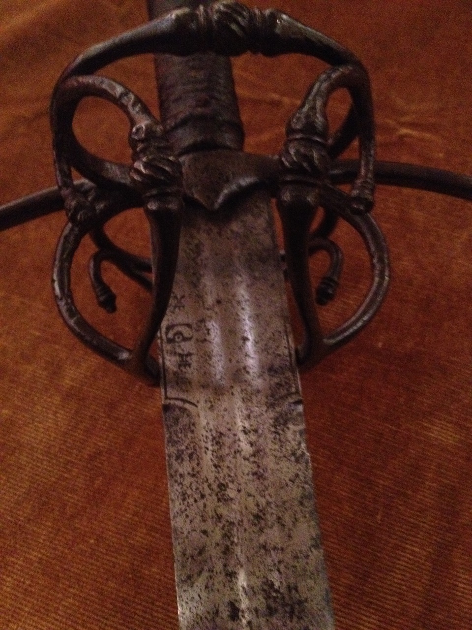

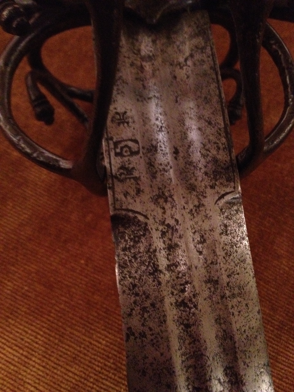

Old 9th May 2015, 03:41 AM   #152
E.B. Erickson
Join Date: Dec 2007
Posts: 61
Ibrahim,
Yes, that old Julia auction is where I found the sword. The other two items weren't surprising to find in an American colonial context, but that Germanic/Dutch basket was! I guess it shouldn't have been too much of a surprise, because England and Europe had a lot of trade going on in the 1600s (when they weren't fighting each other!).
No need to apologize for the confusion about the quotation. Whoever said that is a much better writer than I am, and I just wanted to make sure that I didn't get the credit.
--ElJay

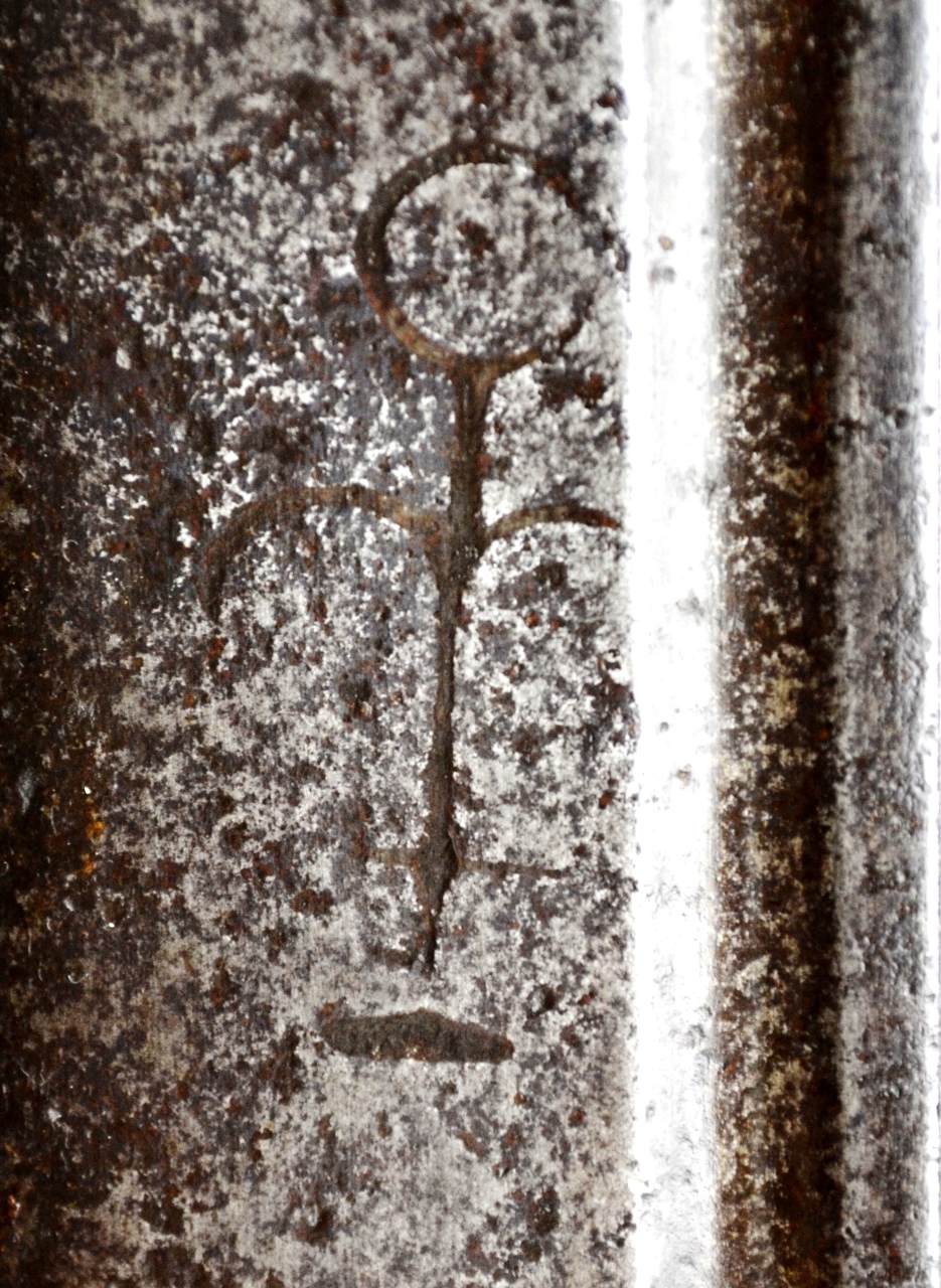

Old 9th May 2015, 12:49 PM   #153
ulfberth
Join Date: Jul 2014
Posts: 447
Originally Posted by E.B. Erickson
First, glad to see photos of the blade on Mark's sword, even though it negated my prediction that it would have a narrow and wide fuller!
Second, please see the attached photos.This went through eBay several years ago, and was advertised as being a Dutch baskethilt. Can any of you that have access to European museums verify this? The pommel does not appear to be original. The photos of a page from a book were included as aprt of the auction description.
From the National Museum Copenhagen Denmark, Danish, Dutch , north European ?
Kind regards
Ulfberth

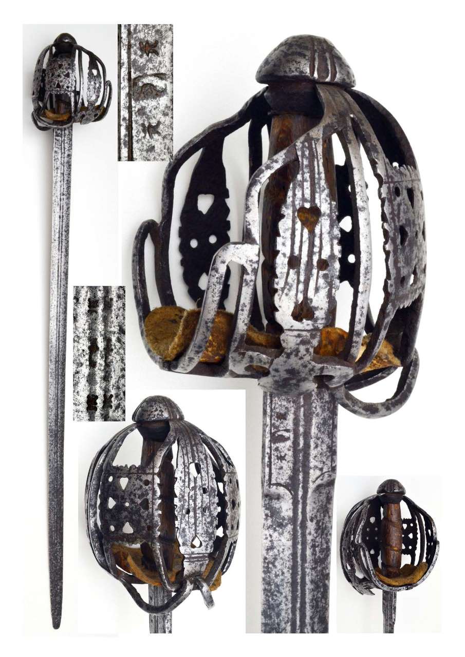

Old 10th May 2015, 09:26 AM   #154
Cathey
Cathey's Avatar
Join Date: Oct 2009
Location: adelaide south australia
Posts: 286
Default Glasgow Scottish Basket Hilted Backsword
Hi Guys

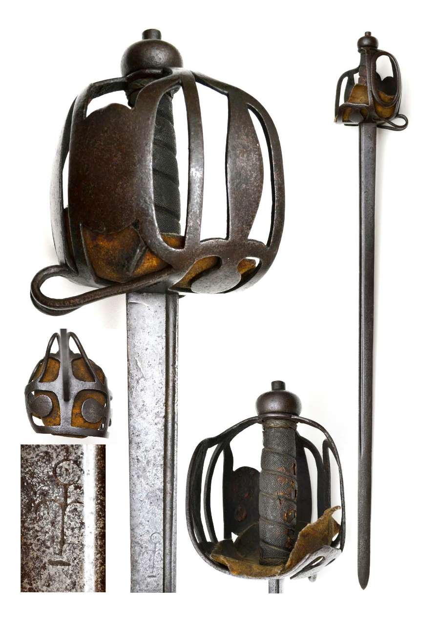

As I mentioned, Rex and I went to Melbourne for an Arms and Armour Auction last weekend. Apart from a number of nice Georgian swords I had targeted an early Basket hilt which I was fortunate enough to secure. The hilt is reasonably early, probably around 1707, however the blade marked with a Fox with a H over the forelegs is probably latter.
This brings me back to the old question which Harvey used just the H over the forelegs on the familiar fox marking. I have seen plenty with SH for Samuel Harvey and have begun to wonder it the absence of the S represents an earlier Harvey such as Joseph.
Date: Hilt Circa 1707, blade may be latter
Maker/Retailer: Blade made by Harvey
Overall Length: 39 1/4” 99.7 cm fuller 24 3/8” 62 cm
Blade length: 33” 84 cm
Blade widest point: 1 ½” 3.7 cm
Hilt widest point: 4 ½” 11.2 cm
Inside grip length: 4 ¼” 10.7 cm
Marks, etc.: Stamped with a fox with H over the forelegs.
Description
Glasgow hilt with Cone shaped Pommel, Shields and Guards have bracket cut with central lobes to the edge, Shield and Guard piercings include darts mounted by two circles, other circles and engraved lines. The two shields are pierced by a central star of four points, surrounded by darts mounted by two circles. There is no wrist guard or horseman’s ring. The grip is wood with brass wire. The backsword blade is stamped with a fox with H over the forelegs.
General Remarks
No Horseman’s ring in the guard
References:
MAZANSKY (C.) BRITISH BASKET-HILTED SWORDS: A TYPOLOGY OF BASKET-TYPE SWORD HILTS pp102 F5c, 109 F13b, 113 F15
Cheers Cathey and Rex
Cathey is offline   Reply With Quote

Another outstanding sword!
Most interesting that the indeed old question of the SH running wolf (fox) on these Harvey blades comes up. This discussion has gone on for many years now, and interesting situation that there were three Samuel Harvey's, senior b. 1698; his son Jr. and grandson III. The grandson died in 1810.
I had actually never heard of a Joseph, so curious as to where he would fall into the range of this dynasty.
It seems there was no particular chronology or documented evidence of these marks used by the Harvey's at a particular time. I recall having one of the horsemans swords with HARVEY in blocks letters across the forte many years ago.
Some blades are marked S HARVEY without the fox; on a slotted guard hilt c. 1780 the blade is stamped H/VEY below a crown.
One of these swords in Neumann (19.S) has a blade c.1750-68 with this same fox and letter H only. This seems the correct period for this blade which as indicated post dates the hilt.
I have always wondered what prompted the Harvey's to adopt the well known 'running wolf' of the expatriate Solingen smiths in England from Hounslow and Shotley Bridge, and when this occurred. It is curious as these were not used exclusively in either of these German 'arrangements', and the use of the mark in Solingen had expired during these times as well.
As far as I know no other English maker ever used the 'fox', and the inclination of its use seems inconsistent with the Harvey's.
It seems Eljay had come up with similar findings some years ago.

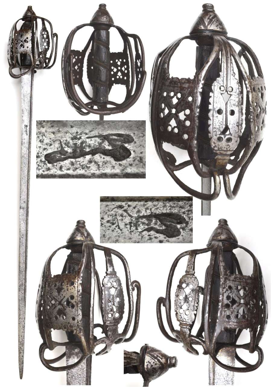

Just working through what I have and haven’t posted and realised I had not put my favourite up yet, so here goes.
Scottish Basket Hilt by Thomas Gemmill
Date: Circa 1690-1720 (17-18th Century)
Nationality: Scottish (Glasgow)
Overall Length: 93.5 cm (36.8 inches)
Blade length: 79.7 cm (31.4 inches)
Blade widest point: 4.4 cm (1.7 inches)
Marks, etc: Blade marked "Andria Farara" in the centre.
Description
The Iron hilt has a broad flared wrist guard with fluted decoration. The edges of all the broad and narrow guards are cut with pairs of claws with bifurcated ends. The piercing includes hearts made up of three separate holes, a diamond one shaped to fit between the other two which are round. The central piercing on the broad guards is in the form of an X. The grip is stag horn. All other bars are broad and have deep fluted decoration. This is a full basket. The broad sword blade is marked “"Andria Farara" on both sides.
General Remarks
Provenance: sold by Philip Fialides of Impala Antiques to retired Victorian Superintendent of Police Noel Standfield, Noel then sold the sword on to Murray Gray. Noel had done considerable research on this sword and was the first to claim it is an unsigned Gemmill.
Sword has since been confirmed as an unsigned Thomas Gemmill by the Baron of Earlshall who will be featuring this sword in his book.
Thomas Gemmill (Kings Armourer in Glasgow, c. 1718-1737)

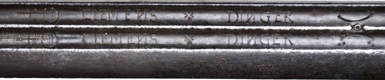

Old 21st May 2015, 05:27 AM   #162
Cathey
Cathey's Avatar
Join Date: Oct 2009
Posts: 286
Default Basket Hilted Back Sword (Irish Hilt)
Hi Guys
Just looking back at what I have and haven’t posted on this thread already and realised I missed the third of my Spiracle Pommel Swords, so here it is.
Date: Circa 1615-40
Nationality: British
Overall Length: 108.6 cm 42 ¾”
Blade length: 95.1 cm 37 5/8”
Blade widest point: 2.8 cm 1 1/8”
Hilt widest point: 11.3 cm 4 2/4”
Inside grip length: 8.5 cm 3 3/8”
Marks, etc.: Blade marked to both sides to a German, Solingen Swordsmith, “CLEMENS DINGER”.

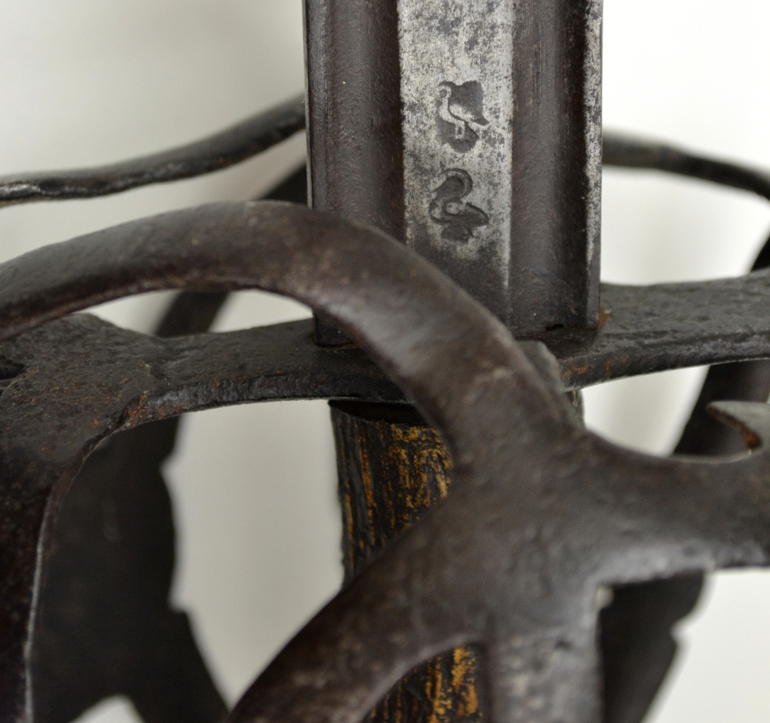

With regards to marks, I flipped the picture of the two makes under the hilt upside down and what I first thought looked like some kind of snake now looks more like two swans. Sometimes I think the more you look at sword marks the more confusing they get.
Description
English Basket Hilt circa 1615-40
English basket hilt sword (Irish Hilt) of early form, approx. Staghorn grip (latter replacement), steel guard of early type with the feature of a loop in the nut that attaches the guard to the Spherical pommel. The backsword blade is attributed to Clemens Dingen (II) recorded as working 1630-1710 and marked with CLEMENS DINGER and the Orb and cross on both sides.
References:
MAZANSKY (C.) BRITISH BASKET-HILTED SWORDS: A TYPOLOGY OF BASKET-TYPE SWORD HILTS pp67
MOWBRAY, Stuart C BRITISH MILITARY SWORDS VOLUME ONE 1600-1660 The English Civil Wars and the Birth of the British Standing Army pp122
OAKESHOTT, Ewart EUROPEAN WEAPONS AND ARMOUR From the Renaissance to the Industrial Revolution pp176-178
Old 21st May 2015, 04:11 PM   #163
cornelistromp
cornelistromp's Avatar
Join Date: Mar 2009
Posts: 1,071
WOW, he worked 80 years !

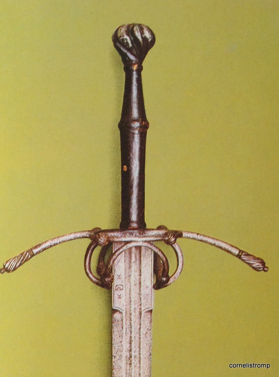

there is a famous Swedish sword known which can be dated to 1627 with a similar standing swan of Clemens Dinger.
I will check it later today.
best,
Old 22nd May 2015, 09:08 AM   #164
cornelistromp
Join Date: Mar 2009
Posts: 1,071

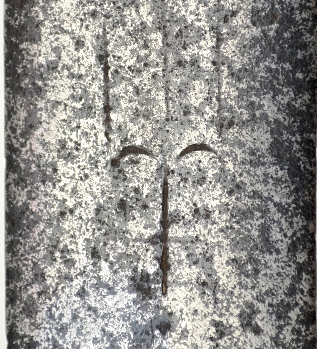

swan mark and "signature Clemens Deinger" on rapier of Gustav II. Adolf from Sweden carried at battle of Dirschau Poland in 1627.
Clemens Dinger worked for from <1627 to the 1650s, the swan mark (different) was also used by his son Heinrich and used by his grandson Wilhem in 1698 onwards.
Old 23rd May 2015, 03:31 AM   #165
Posts: 10,867
Definitely a very nice blade! Apparently Clemens Dinger (the elder) worked in Solingen 1590-1620 and then listed (according to Bezdek p134) in Toledo from 1620-1677. There is another listed among the numerous members of this family as Clemens Dinger zu Wirsberg 1640-45 (not sure what the 'zu' means).
Whatever the case this blade of course probably aligns with earlier blades by the elder as the 1627 date was set as noted by the battle in Poland that year.
I am curious, in the name stamp, why are the 'N's backward (as in the Cyrillic letter 'I') ? Is this some sort of artistic license or deliberately set trademark? In many cases other letters as in Spanish names, inscriptions have uncharacteristic 'E's and other substitutions in various cases.

Upon cornelistromp advice I purchased copies of Solinger Schwertschmiede Des 16. Und 17. Jahrhundersts Und Ihre Erxeugenisse by ALber Weyersberg and Stephan Kinsman’s European Makers or Edges Weapons, the Marks a Handbook for Museums and Collections. These books arrived the other day and I have found both publications quite useful.
Given the earlier period dating for the sword in question I would attribute the time line to Clemens Dinger worked for from 1627 to the 1650s.
if he started working as a sword smith in Solingen at around the age of 20, then he stopped in Toledo at the age of 107! ???
This is obviously not the case.
if you could survive childhood and your teenage years you had a good chance of living to your 50s or your early 60s.
I think there are two Clemens mixed together here.
re Toldedo:
Wendelin Boeheim refers to one Spanish? dated blade of Clemente dinger,
CLEMETE DINGER ESPERADO MI SIGNAL PARAIO 1677,
but questioned whether there really has worked a Dinger in Toledo.
It was fashion to put in Solingen Spanish phrases and Toledo look a like marks in the blades.
I expect the career of clemens Dinger as suggested by Boeheim, before 1627 to mid 50s to be very likely.
best
jasper

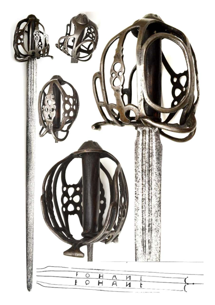

Join Date: Oct 2009
Posts: 286
Default Scottish Basket hilted Broad Sword
Type of Weapon: Scottish Basket hilted Broad Sword
Date: Circa 1730 (18th Century)
Overall Length: 101.6 cm (40 inches)
Blade length: 87 cm (34.3 inches)
Blade widest point: 3.3 cm (1.3 inches)
Hilt widest point: 11.5 cm
Inside grip length: 9.6 cm
Marks, etc.: Numerous marks to blade shoulder and in both fullers haven’t identified any of them as yet.
Description
Basket Hilt-Scottish-c1730-Broad Sword: - Thick steel basket Hilt has typical heart and circle decoration made of thick flat bars, no wrist guard. Blade length is pitted and has dark patina, numerous marks visible on blade shoulder and both fullers, probably German. The fuller runs almost the entire length of the blade. The blade may predate the hilt however they appear to have been together for very long time.

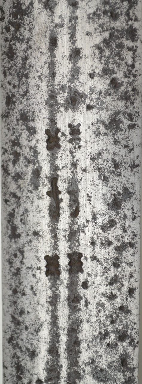

Old 31st May 2015, 12:29 PM   #173
cornelistromp
Join Date: Mar 2009
Posts: 1,071
Description
Cheers Cathey and Rex[/QUOTE]
@ Cathey,
the blade seems indeed older, 150-200 year, out of the first half of the 16th century and maybe shortened.
this type of mark I noticed more often at the ricasso of a so-called compound or complex hilt from the first half of the 16th century.
Always on the left side of the ricasso (pommel up) of a double fullered
blade.
best,

Description

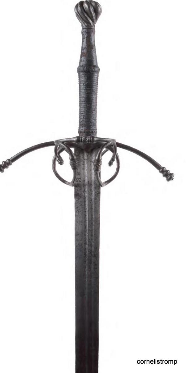

@ Cathey,
blade.
best,[/QUOTE]
Hi Jasper and Cathy,
the marks on the blade look like they are from the same maker, and yes the blade is from the first half of the 16th century , from south German Or North Italian origin.
The blade in the basket hilt is a similar blade and looks shortened.
Or it could be a blade from the same maker forged in different dimensions to begin with.
The blade of the complex hilt measures 4,5 CM at the cross guard and is 106,5 CM long.
I cant measure the blade on the basket hilt but I think 3,5 would be close.
Also the fullers on the one and a half sword are 7 mm wide.
@ Jasper , you'r first picture is from that Italian book, but were did you find the picture of the second sword ?
kind regards
Ulfberth

@Dirk,
http://www.baldwin.co.uk/media/cms/a...0Militaria.pdf
lot 184 pp80
best,
Jasper

Hi Jasper and Ulfberth
Thanks for the example of what does appear to be the same mark on the ricasso, pity we cannot establish who the mark belonged to. I am still trying to decide what the marks lower down on the blade itself might be. The middle one looks almost like a scimitar sword, however I think the longer I stare at it the less I know what is.

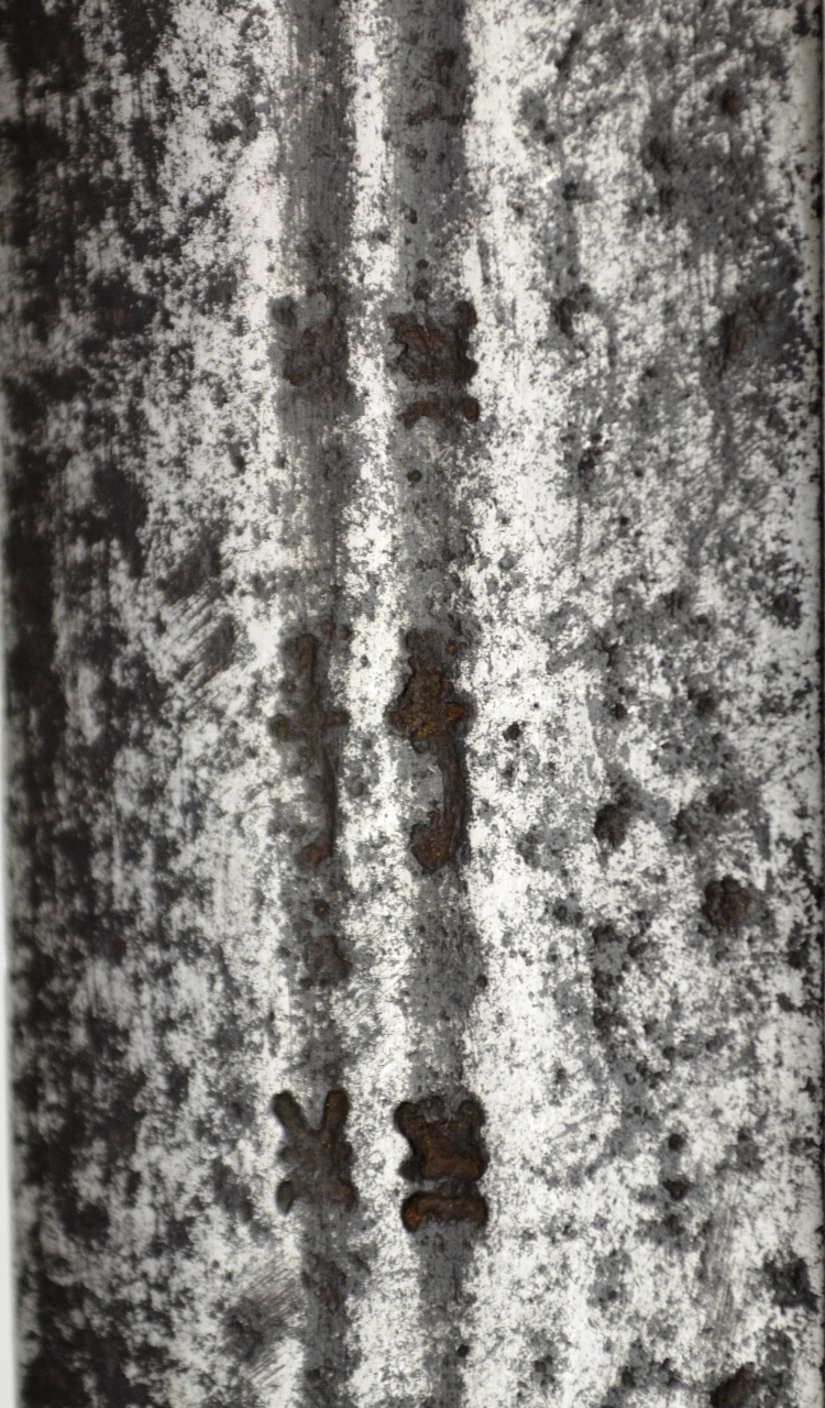

Old 6th June 2015, 09:27 AM   #178
ulfberth
Join Date: Jul 2014
Posts: 447
Hi Cathey,
Of the marks on the ricasso the one in the mid looks exactly the same,
the one above and below are different or put on from a different angle, horizontal vs upright.
Of the marks on the half of the blade the one in de mid looks like yours, however I can not identify for sure the mark on your blade.
What I am sure of is that the blade in the basket hilt is not shortened, because it is also 1,2 CM more narrow at the ricasso.
I believe that blade was made at this dimensions from the beginning and these dimensions are correct for a basket hilt :
Blade length: 87 cm
One and a half hand sword
Blade length: 106 cm
Blade widest point: 4.5 cm
kind regards
Ulfberth

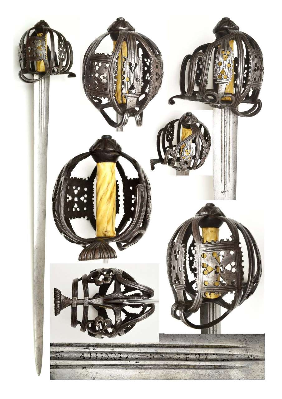

Old 8th June 2015, 05:35 AM   #179
Cathey
Cathey's Avatar
Join Date: Oct 2009
Posts: 286

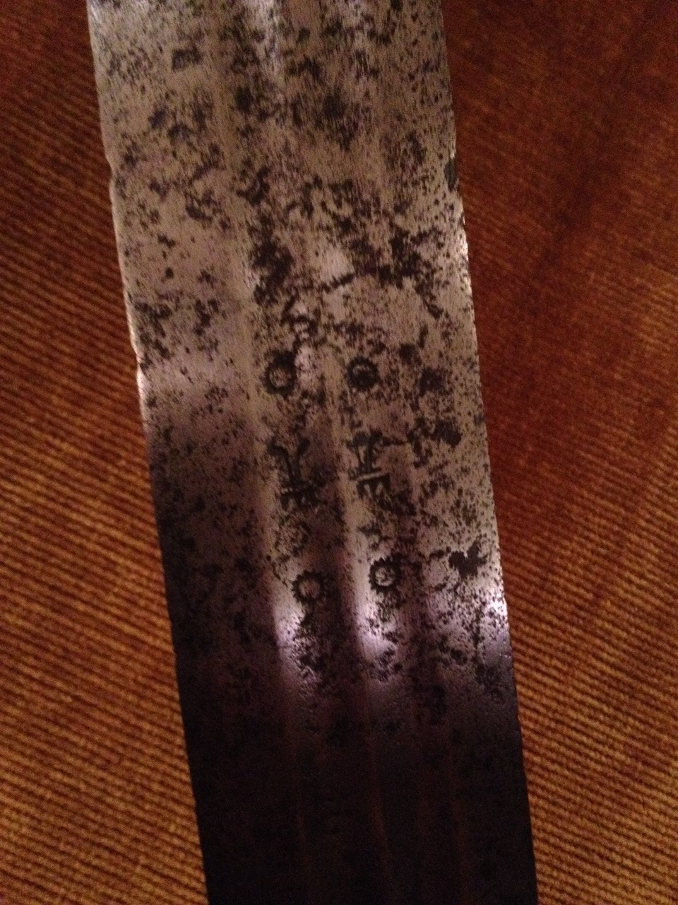

Default BASKET HILT Broad Sword c1740, earlier blade
Hi Guys
This is actually one of the first Basket hilts I purchased back in 1996 in Adelaide.
Date: Hilt Circa 1740 (18th Century), Blade earlier
Nationality: SCOTTISH
Overall Length: 36 ½” 92.9 cm
Blade length: 31 1/16” 79 cm
Blade widest point: 1 ½” 3.2 cm
Hilt widest point: 5” 12.7 cm
Inside grip length: 4 ¼” 10.8 cm
Marks, etc.: 2 short fullers containing remnants of inscription, only the letters I O H A N T can be read with any certainty. Blade is pitted and has dark patina, possibly predates hilt.
It has been suggested that the name on the blade is Johanus Cole, but with so few letters to go on I am unconvinced at this stage.
Description
BASKET HILT Scottish Broad Sword. The hilt guards are attached to a very prominent and board flat ring under the pommel, which is associated. The space between the rear and additional rear-guards has a very short transverse linking cross-bar, one third of the way up from the blade-end of the hilt. The margins of the plates and shields are scalloped to follow the outline of the piercing. These consist of large coarsely shaped hearts and circles, which give an open appearance to the shield and plates. This hilt has an oval ring on the inside of the hilt. The blade has 2 short fullers containing remnants of inscription, only the letters I O H A N T can be read with any certainty, followed by an anchor mark. Blade is pitted and has dark patina and a number of sharp contact cuts to its edge. I would suggest that the blade definitely predates the hilt.
General Remarks
The same hilt features on a sword in the National Museum of Scotland Edinburgh LA 140
References:
CAMPBELL.A. Scottish Swords from the Battlefield at Culloden. pp 54-55
CURTIS, T The Lyle Official Arms and Armour Review 1976 Pp21
MAZANSKY (C.) BRITISH BASKET-HILTED SWORDS: A TYPOLOGY OF BASKET-TYPE SWORD HILTS pp126 F20.
MOORE, W. Weapons of the American Revolution and Accoutrements. Pp 146, plate E33.
OAKESHOTT, E. European Weapons and Armour. (See Claymore) pp 175-182.
