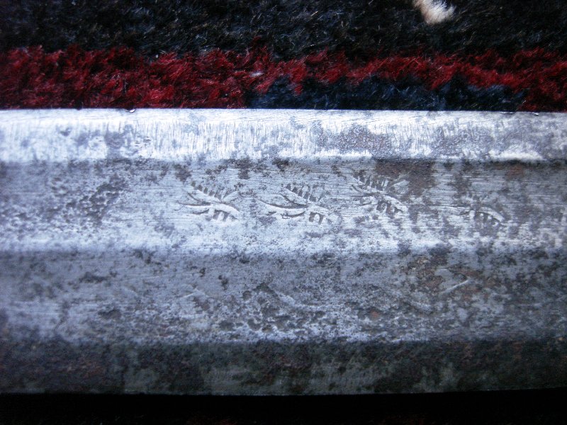

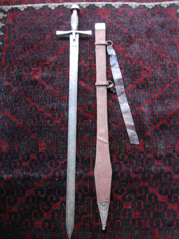

I recently got this Kaskara sword that apparently was brought from Africa in WWII and had since lied in a dark corner of the house (previous owner).
It is a little longer then 1 meter, blade has pitting but some kind of decorative etch can be seen on the upper 2/3 of the blade.

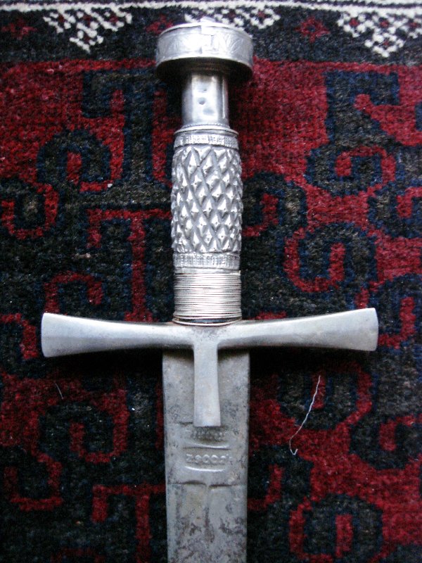

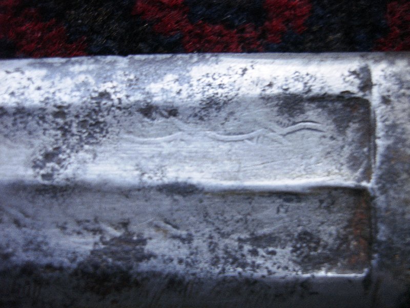

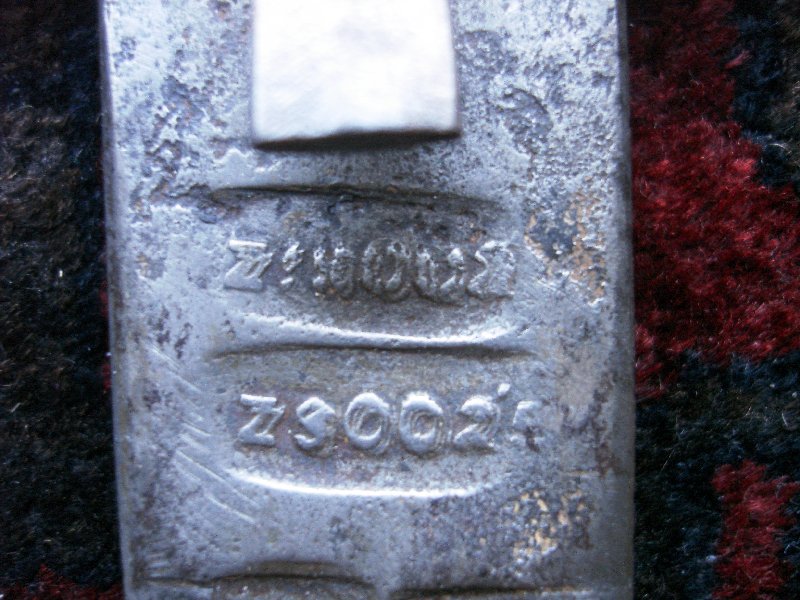

On both sides of the ricasso there is a stamp that reads something like "z3002..." or "zs002" I am not really sure.
I was told by a fellow collector that he suspects the blade is Ethiopian. Is it?

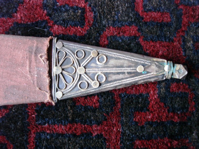

The Hilt is silver and so are the metal parts of the scabbard.
The scabbard however is not leather covered but some kind of cloth,
and all is left of the leather straps is a short piece.

Yes, that's a European blade made for Ethiopia. Not sure of the exact context of the numbered marking, possibly simply a batch identifier.
Nice piece.

I think when dating pieces like this, its important to make a distinction between the blade and the fittings.
The blade looks to be late 19th century. The hilt and fittings later, at a rough guess mid 20th century. But there are other forum members better at estimating that than myself. Ed is probably the forum member best suited for that and hopefully he sees this thread.

Nice kaskara. I'll defer to Iain on the blade. Looks old. The grip has a space at the top to attach the missing Beja/Hadendawa tassle so its from Eastern Sudan or the Beja parts of Eritrea.

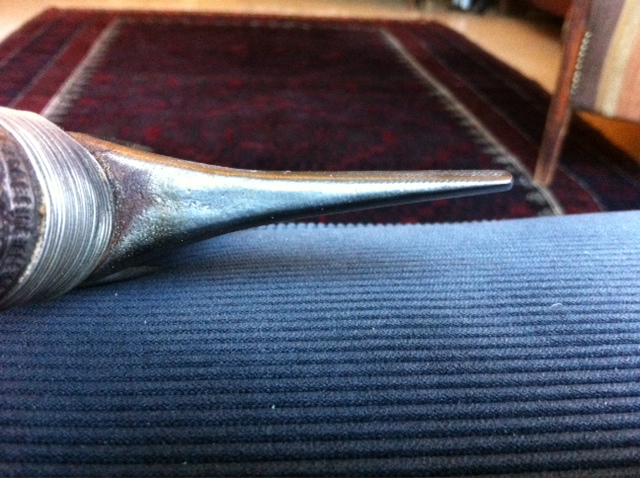

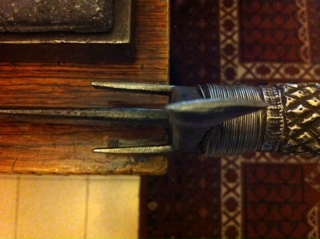

Is the cross guard chisel pointed? If so and looks like one piece construction its was probably made in mid-20th. Cent in Kassala where it one-piece unit was developed. If its welded together it could be earlier and made in Sennar (on the Nile) or Atbara or Port Sudan area (both Hadendawa territory).
The scabbard has a different angular shape and not like those typically made in Kassala. Probably WW2 and later era scabbards had thin wood next to the blade, then covered with cloth and on to was usually goatskin. (Since at least the 1980s they have used cardboard rather than wood.) I'd guess that the goatskin was in bad shape and removed or may have been in a stage of rehab when collected.
Bottom line guess. Probably assembled between in the 1920s-30s.

Ed, Since I havn't seen a 3D Kaskara before I am not sure where to look for the "chisel pointed" form, it does have hints on both angles of the guard but
I add two more photos for you to see, if that's OK.

Wisram: great photos of the cross-guard. I'd call it the chisel form favored from Sennar. Not that it was made there, but likely. Could be fairly old.
