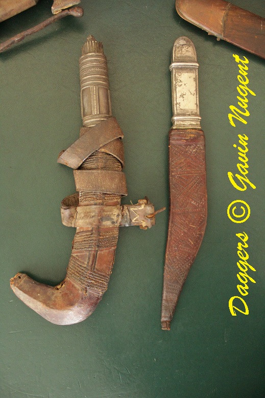

Here are a couple I have in my collections.
They are all Jambiya sized and individually mounted in heavy leather sheaths with one retaining its own original belt suspension. I suspect the one to the right was sash mounted.
Another sold some time back in the link below too.
http://www.swordsantiqueweapons.com/s813_full.html
I feel these had a special place in society but I can not place it.
They are in my opinion, certainly not servants of the owner to be hidden behind Jambiya.
Perhaps, although without foundation, a working knife for the wealthier classes?
Gavin
