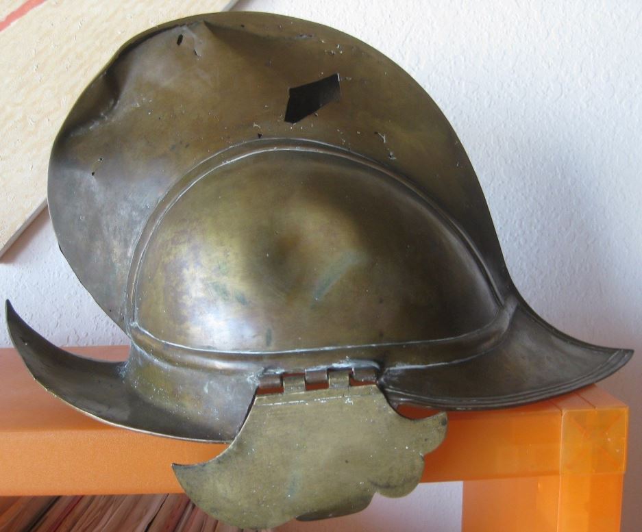

The opposite side of the helmet has some unusual damage, almost like puzzle pieces missing from its comb. I wonder how that type of damage could occur...almost looks like thay were punced out. Perhaps these were weaker areas of the forged brass??
Old 26th September 2014, 01:59 PM   #7
On the first picture you can see two old repairs at the ridge, maybe there has been a similar repair which break out again!?

Charles, the fractures look that way because the helmet is composed of brass-- although whether it is made up entirely of castings which have then been braised together, or is partially wrought, is not clear from the pics. In short, the fractures run along the boundaries of the microstructures in the metal:

Incidentally, this is what Charles is referring to:
Old 26th September 2014, 05:59 PM   #16
CharlesS
CharlesS's Avatar
Location: Greenville, NC
Posts: 1,854
This is not the best angle for study, but this is a very similar, if not identical, helmet.

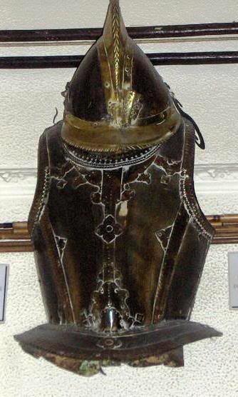

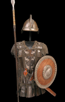

Here are three Moro armors. The first two should help contextualize the solid brass helmets a bit. The last pic is also brass, but made of mail and brass plates.

This is a very unusual example of earlier Moro armor in a Spanish museum (unspecified, unfortunately.) It follows the lines of a Spanish burgonet and cuirass very closely. Both are made out of kerbau horn, with brass mounts on the helmet. The contrast between the dark, polished horn and burnished brass must have been striking.

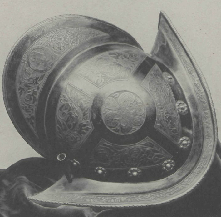

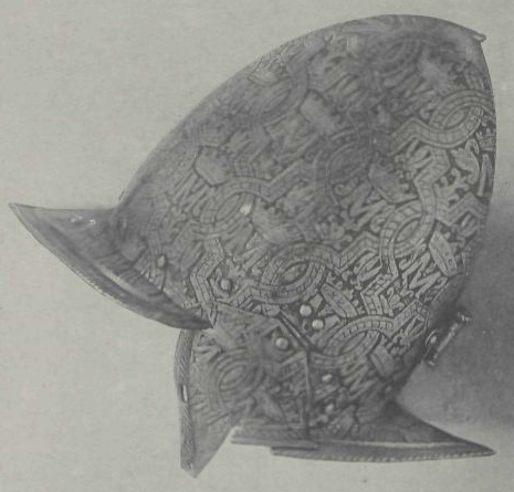

Old 27th September 2014, 04:44 AM   #29
Posts: 7,420
Folks, this helmet in question is very common and typical in construction and style. Yes these were based on 16th century Spanish helmets of similar construction. As shown in the picture of the Maranao data warrior the had a section for a plume of flowers and vegetation which would make it even more "costume-ish" for American/European eyes. Remember though that in this region of the world flamboyance was not seen as a detriment. Similar flamboyance was seen all over Indonesia, at once time in Malaysia, as well as the Philippines. Variations in piercing and okir would be present, but the basic form would be the same.
I do agree that the ear flaps are on backwards. And by the way, the Maranaos were and are still known as great artisans in brass/bronze working. Some of this is still being made today in Marawi City in Maranao country.
This went for a steal - wish I had found it....
Old 27th September 2014, 06:43 PM   #30
Perhaps we may conclude that 'theatrical' and 'flamboyant' are not so distant adjectives; which take us to conclude that the first was not so misplaced ... taken in the due context, of course.
After all, even the original examples where these helmets were replicated from, already had their touch of exhibitionism.
Oliver not minding, i am here attaching a few images of the original stuff for your perusal, presumptiously assuming that these are not so easy to find out there.
An woodcut of a European Captain of War (collection R. Daehnhardt) and a set of pictures of the period of Spanish King Philip II, both from the XVI century.
