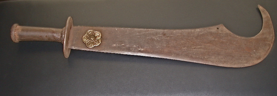

I just came across this "old friend" in the ongoing unpacking process from a move. I think I've owned this for the better part of twenty years.
It came to me through a man who was married to a Chinese woman from Tianjin, whose father had some political position which gave him access to some warehouses in that city. These warehouses held property that was supposedly rounded up during the Cultural Revolution, when anybody who thought they had something to worry about did their best to cut all cultural and material ties with the old regime. In today's terms, it was a Great Downsizing!
When I was studying in Xi'an in 1987 I repeatedly heard of this "warehouse" from contacts who were aware of things being very slowly filtered out for sale in the government approved antique shops.
The knife pictured is different from most forms because of its size, but it's vaguely similar stylistically to the Dadao. The quatrefoil guard is brass. The pommel part of the grip scales on the side opposite has broken away and is long missing.
Any ideas of a specific name for this, or even of one exists? Should I clean this conservatively and repair the pommel? Comments?

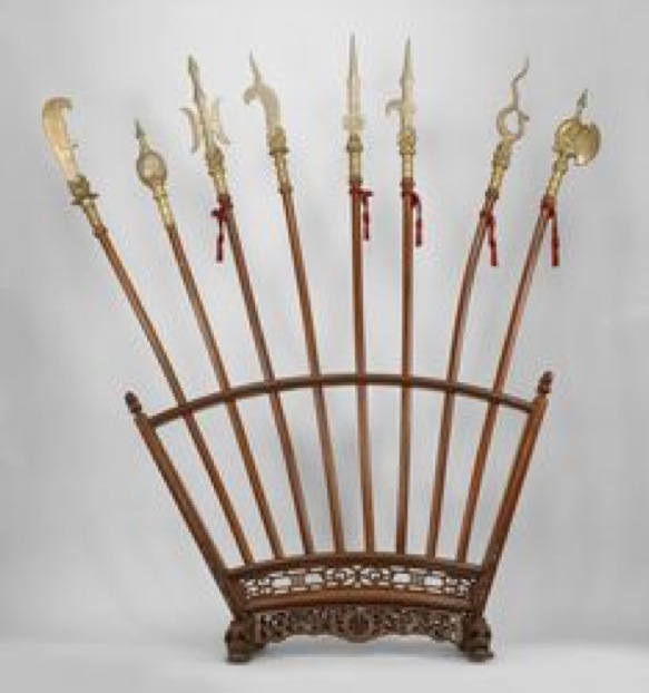

This is really great. I have a weapon with a very similar blade shape, but it is a polearm. I have been struggling for years to identify it. There are many different types of polearms from China. I may have more info to post soon, but for now here is a photo of mine. It is 27 inches in length overall and very heavy. I am also posting a picture of a Chinese pole arm with a similar shape (on the far left).

I began a new thread several months ago when I posted images of a pole arm called "guandao".
Your pole arm somewhat resembles both the knife in this thread and the guandao post of early October.
I think it's a form that, being flamboyant, is apt to be copied and imitated.
Yours appears to be fairly late, i.e. twentieth century. The pole is held by the socket-grip. Mine bears a tang, and has the crust of age all over.

The knife in this thread is Chinese and probably mid 19th century. It has the 4 lobed guard found on some Chinese weapons and the shape and form of the grip shows Indian influence. Indian arms were popularized in the mid 18th century when the Emperor received gifts from India notably jade hilted daggers and swords. Notice the similarity of this grip shape to those Indian jade hilted examples. Although a century later the style remained. The shape of the blade is reminiscent of pole arms of the period. These short knives were made for civilian use and were popular amongst the gangs that required something short and fast to handle combat in the tight streets and back alley ways of the big cities.

Yes, I agree. While the handle is in a style that would be consistent with the Qianlong period, the blade appears mid to late 19th c.. I have a large knife with a very similar handle that I always thought was 19th c., so it is nice to see another example.
The pole arm shaped blade mounted as one a handed a chopping weapon has a long history but the older examples tend to a different shape and are more finely made. I have seen them referred to as "podao", but there is some confusion with a two handed pole arm called either a "podao" or "pudao" depending who you talk to. Some people think the short form chopping knives were made from cut down pole arms, and there may be some examples out there, but I have only seen purpose made versions. In your case because the tang curves around to fit the handle, there is no doubt.

Thank you all for your input! One thing I neglected to mention is that the blade is of a fairly light weight, so I don't believe that using it to cut pole arm hafts would be realistic. I think this is strictly for hand to hand use, or for some other as yet unknown method.
The back of the blade is pierced with a small hole possibly for a streamer or ribbon, I would think.
So, possibly a WuShu weapon, but one not limited to just exercise, but combat?
