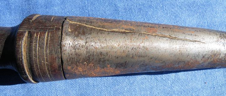

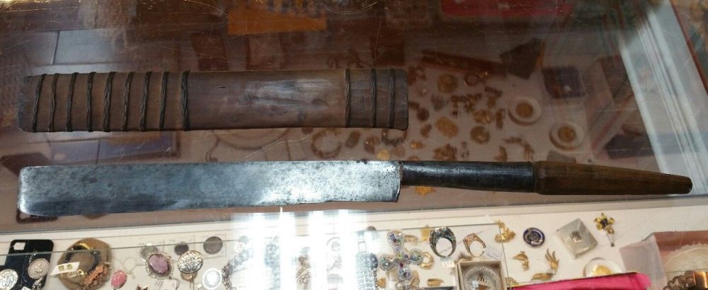

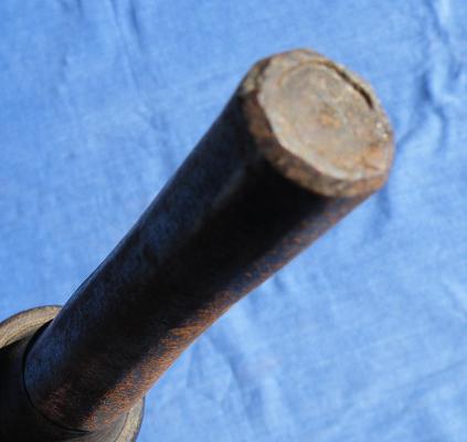

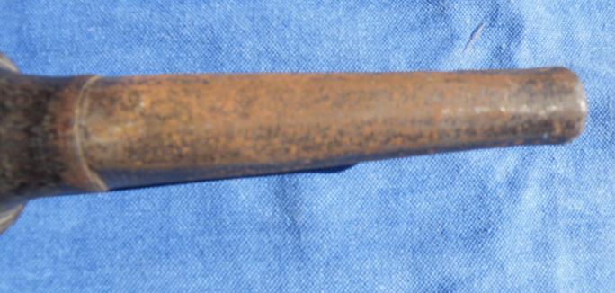

It is not often that I run across something I haven't seen before so when I do I tend to gravitate towards those items. This is a very interesting piece. It is about 21" long with a very thick and heavy blade. This is probably the reason for the long steel ferrule. The grip is of unusual form but is 8 sided. I would place it in the 19th century so it has very good age. The 8 sided grip reminds me of the Philippines but the shape of the handle is unique for that region. The blade shape is also a bit unique. Very thick spine, heavy and currently out of polish so unsure of the blade construction. The long steel ferrule reminds me a bit of Kalinga axe but the weld is nearly seamless where as you tend to have an overlapping weld on a Kalinga axe. The other region I gravitated towards was the Naga/Assam regions. Again, not an exact match to anything from that region but certain similarities can be found. I'm hoping the collective knowledge of the forum has seen this form somewhere in an obscure reference or can lend additional hypothesis to the mix to help on the road to discovery.

my feeling tells me somewhere from the mainland of SEA but frankly said I've never seen something similar.
Old 3rd July 2014, 09:13 PM   #3
Henk
Henk's Avatar
Posts: 1,209
First guess is a dha-like something, Could also be a malay or indonesian chopper.
Blade has something from a sikin panjang. Could be a rehilted thing from that area as well.
Same story as Detlef told you, and i haven't seen anything like this either.

Hello Rick, It sure is nice to know that I am not alone when it comes to not being able to pass up the odd item when it shows up. I wish I could help on this, but like everyone else I have never seen anything like this before.

That's definitely unusual. It appears to have been much used and resharpened many times. There is quite a deficit in the edge at the center of the blade, suggesting it has been used repeatedly as a chopper. So maybe more of a tool than a weapon.
Nothing about it really speaks to a specific origin.

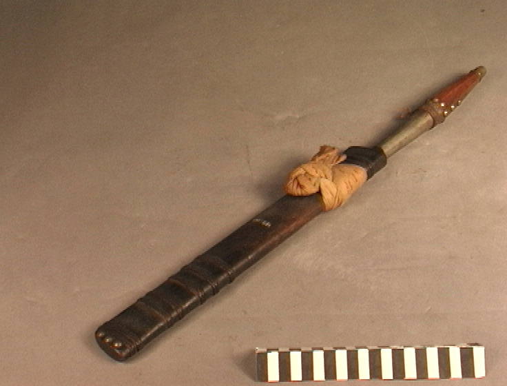

The structure of the piece reminds me a bit of this knife/chopper I had and posted on the forum a couple of years ago - the metal sleeve and faceted finial are both commonalities. My knife was thought to be from Java in the end.

On further reflection I think the clue to what this was used for lies in the thickness of the blade. You say "very thick," but just how thick? If the spine measures more than a centimeter across, then the overwhelming use for such a blade in SE Asia is for splitting coconuts or chopping branches and small trees for firewood. Yes, we do find occasional weapons with blades of that thickness (the parang latok from Borneo, some of the klewang from Aceh, etc.), but seldom the focused wear on the blade that this one shows.
Since the blade has seen some hard use, probably over an extended period of time, it is possible that the handle is a replacement. And the scabbard also looks fairly recent in manufacture, with those well preserved rattan strips and no obvious dings.
My best guess would be a coconut splitting knife from northern Burma/Nagaland/Assam.

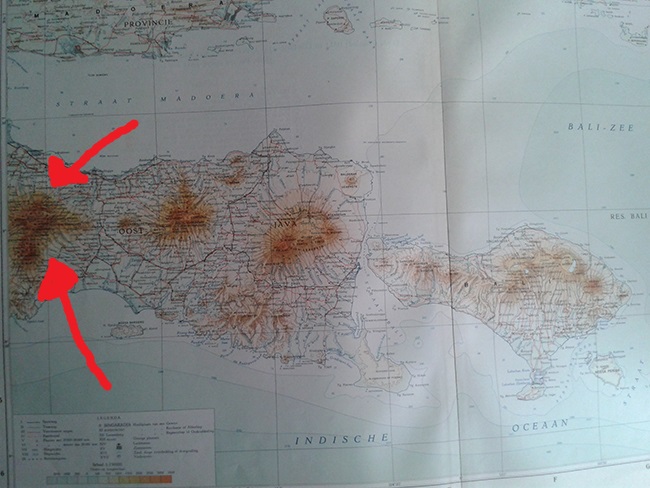

Hello Rick,
It is from the Tengger Mountains.

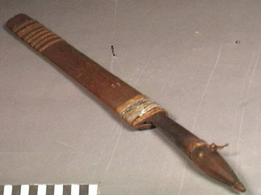

In the museum of Leiden are several of them, all from the Tenggerese..
A good Belgium friendcollector of mine, who alerted me on your post, has also one in his private collection and did some research before and knew what it was.
Regards from Belgium and the Netherlands!

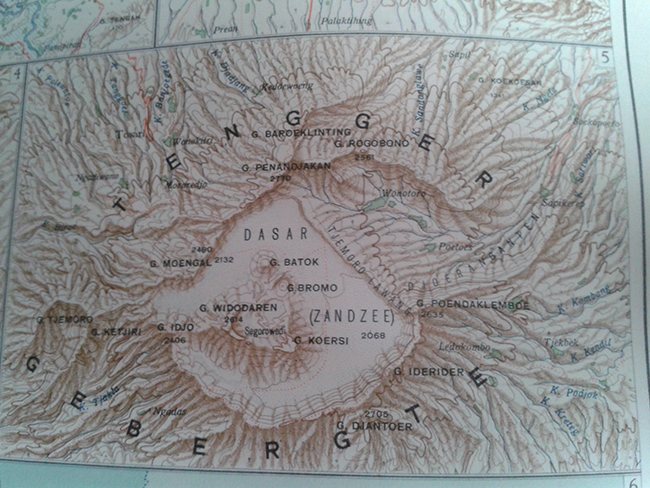

Where did you get those cool maps? They are very cool….
I have this very big Atlas "van Tropisch Nederland", 1938.
I made the photos with my cellphone from it.
Rg,
Maurice

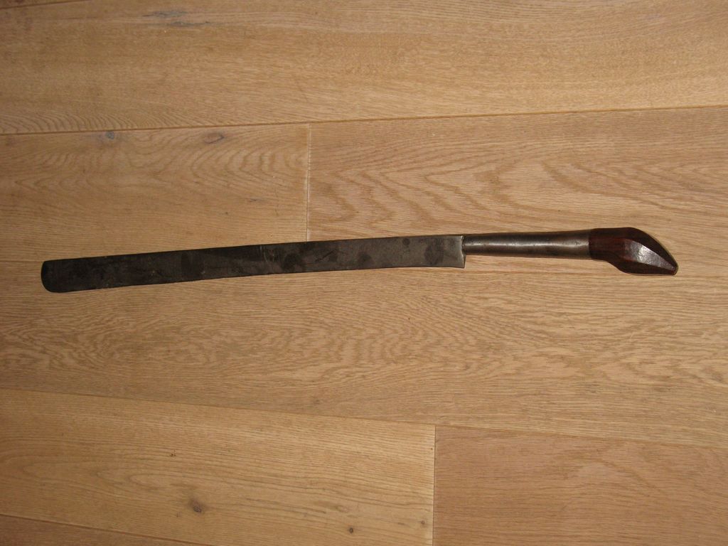

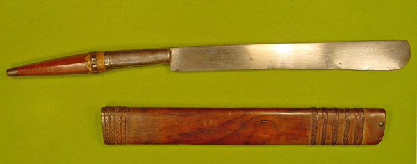

My friend didn't mind placing a photo of the sword in his collection.
So here it is!
Enjoy.....
Rg,
Maurice

Could this piece belong to the same group?.
Emanuel
Old 7th July 2014, 11:42 PM   #28
Posts: 4,748
Looks very similar Emanuel. I'd say the same group.

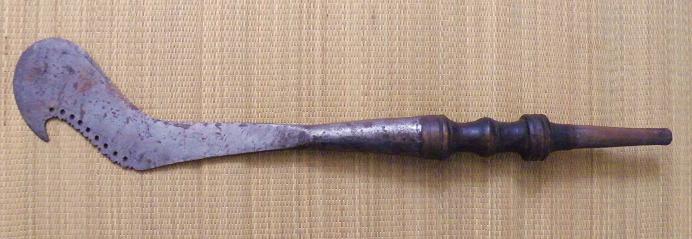

I have recently aquired this one, it was listed as Maasai seme!
