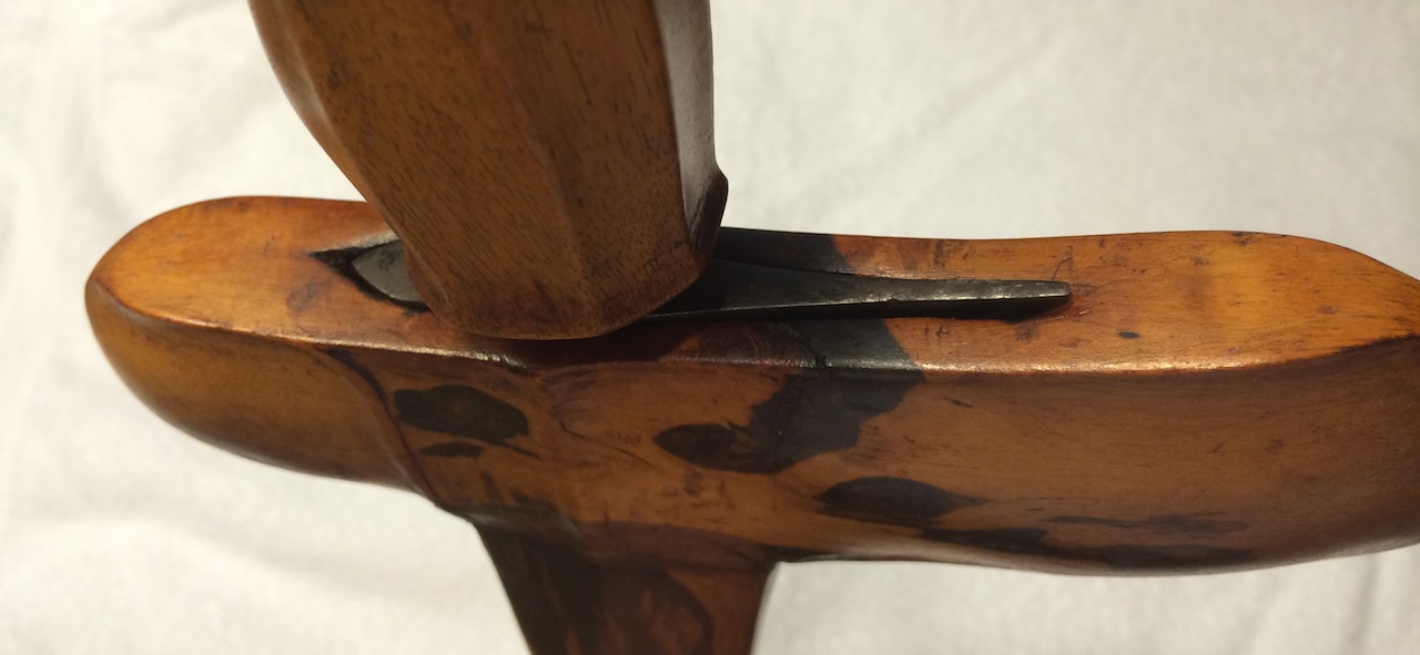

Can you show a shot looking at the fit of blade to scabbard ?

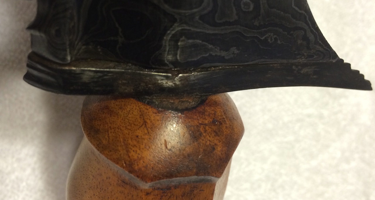

Sure thing, here you go. One other thing, the first pic shows the point where the wrapped peksi enters the hulu. It seems to be wrapped with a whole lot of some very fine material, but while it is very firmly set, it is a touch cocked in overall relation to the rest of the assemblage. I can't tell what the wood of the hulu is, it looks for all the world like sycamore, although of course thats really unlikely.
The fit in the scabbard is very good, no rattle at all. One last thing, the ganjah is loose on the tang. Not bad, but its a bit annoying.
You can see in that first picture how loose and cocked off the ganjah is, but the fineness of the akut, is it? has me hesitant. This hulu is really on there, and I am sure I could fix the ganjah, but….

The pamor almost looks drawn on the blade; but I know it is not .
The blade has a nice polish .
Bali or Lombok .

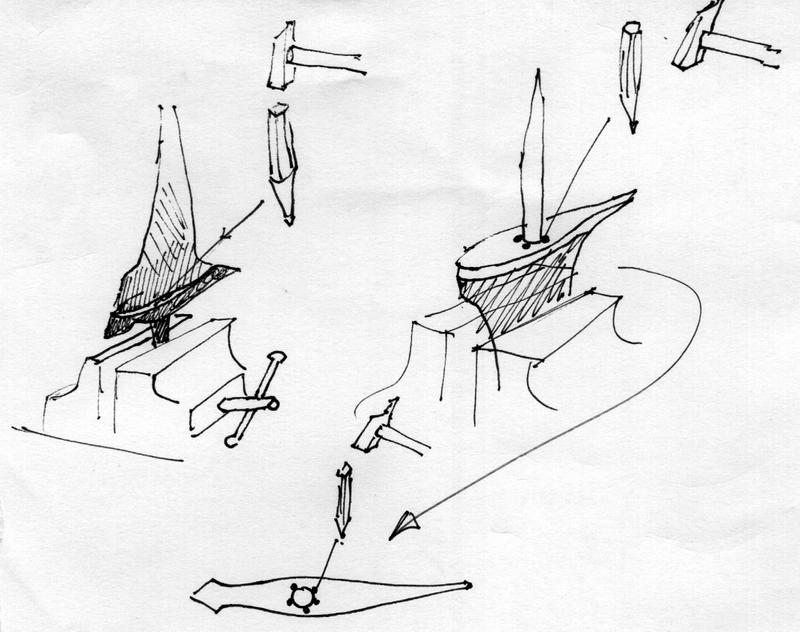

When I clean and etch a blade I always remove the ganja to eliminate the rust. I then cover all parts in contact between blade and tang with a rust converter to avoid future problems.
In the self-explicating drawing you can find the method I use to remove and re-fit the ganja. If possible I avoid using glue of any sort.
Be very careful and delicate to avoid any damage, especially when you place the blade in the vice: it must be very firm, so place two pieces of wood on both sides of the blade and close with strength the vice.
Good work !
That's a great drawing. This is exactly the method I used on one of my other keris. I had to make a new wedge out of a nail.

In fitting a gonjo I have never seen an original gonjo fitted with multiple pins, as GIO has shown. In my experience, the use of more than a single pin complicates the job and makes precise alignment difficult. The usual Javanese method is a single pin on the buntut urang side of the pesi.
The pin used to fit a gonjo should be cut square and tapered and fitted into a tapered square cut hole. You cut the square hole to accept the pin with a jeweller's file, you make the pin by using a jeweller's file.
Another way of fitting a gonjo is to make the hole in the gonjo a very neat, press fit to the tang, then tighten the gonjo around the tang with a hammer and punch.
Aluminium jaws for a vice are more effective and long lasting than wood, but for a quick fix, folded newspaper works well.

No, I do not use pins to secure the ganja. I get a small deformation on the ganja around the peksi, so that the ganja is firmly fixed.
The same principle is applied in Japan to adapt tsubas on the blades.
I am sure Alan has never seen such a system: it is my personal clumsy work to avoid the use of glue. In my defence I would emphasize that the result is invisible (also because hidden by the mendak) and reversible.
When a pin is present, I obviously use it. If it is worn out, I make a new one.
Old 14th June 2014, 09:13 PM   #22
Posts: 7,228
Please accept my apologies Giovanni.
I misinterpreted your sketch:- I thought that the black spots surrounding the tang were holes to accept pins.
Yes, tightening a gonjo by working around the tang and punching the top of the gonjo is a valid way to fit a gonjo, I've often found this method used on Bugis and Peninsula keris, but I cannot recall ever having seen it used on a Javanese or Balinese keris.

Alan, you absolutely must not excuse yourself.
In fact I am rather flattered becoming aware that the procedure I follow to fix a ganja is being utilized in Indonesia too. At the end my work is not so clumsy and rough !
Old 17th June 2014, 12:00 AM   #24
Posts: 7,228
Yes, I believe your finished job would be neat.
However, this type of fit can only be used when the hole in the gonjo is a neat fit to the tang.
