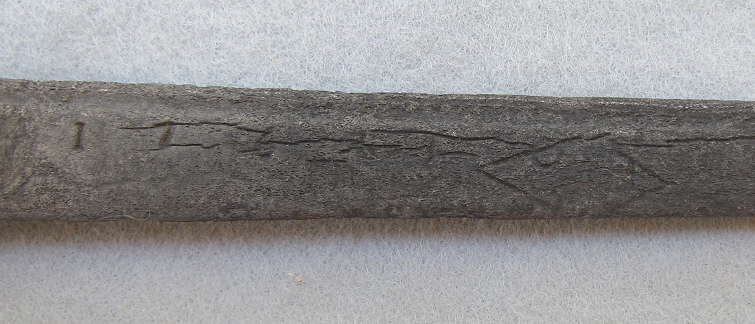

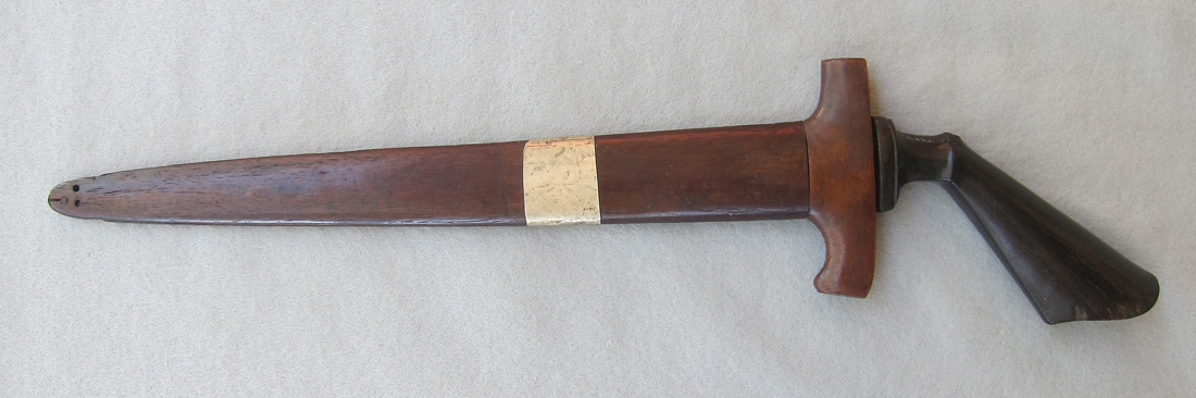

This badik came into Australia pre-1914, bought in Batavia.
I have only ever seen one bladed weapon with similar markings.

Hello Alan,
Thanks for the pics!
It's been heavily stained as expected for Jawa blades while the remaining fullering/etc. seem to point to a recycled European blade. How would you judge the metal? Can you exclude the possibility of this blade having been crafted by a pande Jawa? (Seems unlikely to me to be a Jawa-made look-a-like - just trying to take advantage of your experience and you having this piece at your hands...)
What kind of Indo piece was this other one?
These VOC-marked blades are slightly more common than that - will try to post pics of some more examples ASAP.

I'd prefer not to indulge in speculation Kai. I really only like to comment if I have some sort of evidence to form an opinion on, and all I have with this piece is the certain knowledge of when it entered Australia.
It looks old, but the technology used by smiths in old Europe and smiths in old Jawa was pretty much the same, so there is really nothing I can base an opinion on.
As for how common this sort of thing may be, I can only state my own experience, and I've only ever seen one other blade with a similar stamp. I'm uncertain where, but it was probably one of the museums in Central Jawa, most likely in Solo. I cannot remember what this other piece was, but it was very likely to have been a sword of some kind.
Sorry I cannot be more informative.

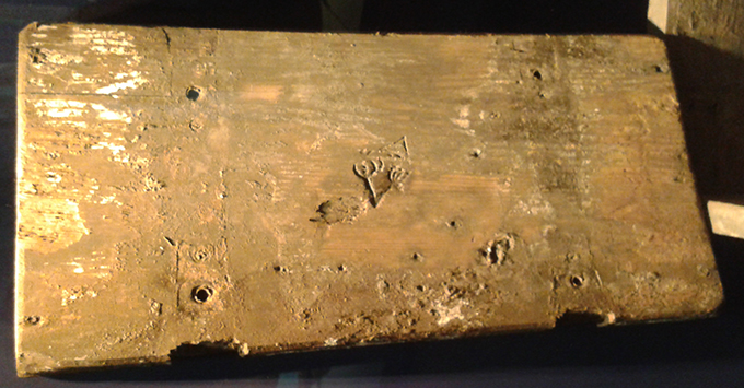

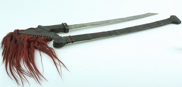

Some time ago I was trying to write an article about podang variations and also came across a few Batak pieces with VOC blades. I will try to retrace pictures of those.
My working hypothesis for that article was - based on the examples I had seen was that the VOC mark had "status" for the Batak hence that local made blades bore the VOC markings without any reference of them being used by the Dutch.
Supporting hypotheses were:
-Locally made blades with the VOC mark exist
-The VOC mark was not added for tourists
-The VOC mark has added value for the user
I found some examples that would fit the descriptions but nothing substantial unfortunately.
Here some pictures from a 1903 auction that included a Batak podang with a VOC blade.

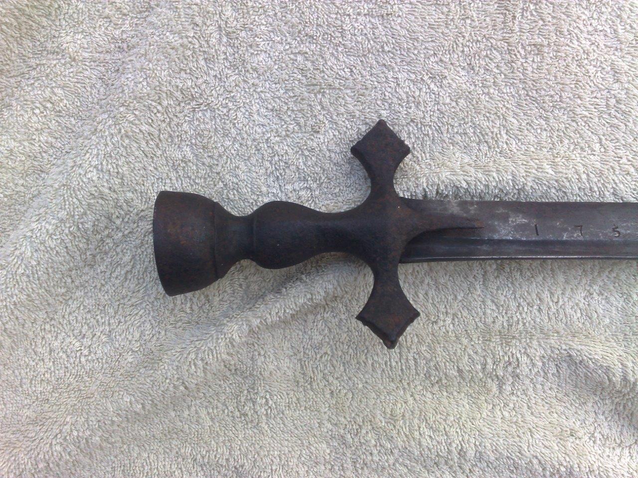

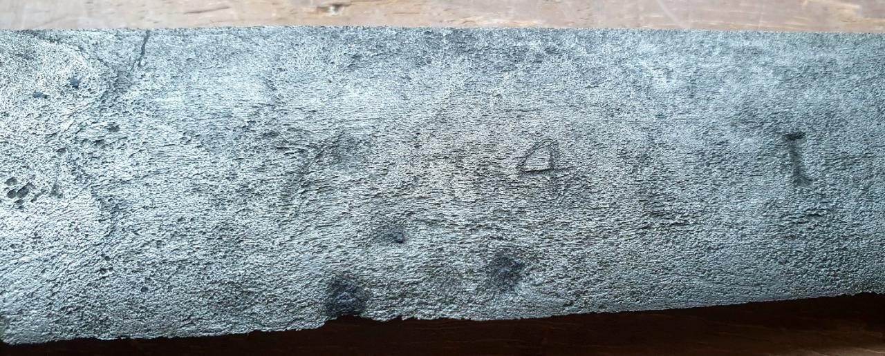

This example had VOC marking - unfortunately no close up.
I have used the same pic twice - two is a rotated detail of the first one
Certainly was not the A(msterdam) but I think H(oorn)
Date looks like 1763 but I am not sure and I don't have the blade anymore.

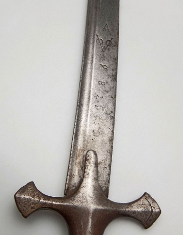

Default VOC blade
@ Erik: Thank you for posting this one. Now we have an example from before 1903! As we know Bataks allready made touristic items at the end of the 19th century, this is not the case here.
I don't think VOC marked blades where allready seen as treasures in swordcollectors collections.
I'm not sure about the provenance of this one.
A long time ago I copied the picture from a Dutch museum database. However I wasn't smart enough to write down from which database I copied it from.
I can not find so quickly where I got it from, but it's worth showing.
As far as I can remember, I thought it was coming out of the famous Visser collection, but I'm not sure.

Maurice, thank you for posting this! This is exactly the shellguard form I had indicated apparently made in Solingen (in many cases) for the VOC, and the one I saw was dated 1685 (with the quad lozenges on either side and VOC). I believe the Visser collection was mentioned in one of the descriptions.
Another like this was shown by Harvey Withers dated 1787, illustrating how long these were in use.
You are exactly right, back in those days swords were around everywhere and often these 'average' pieces were simply in heaps in old rummage shops etc. (as often described by Oakeshott) . The only arms in demand were usually high end rapiers and ornate examples. Even back in my early days (late 50s early 60s +) you could still get great examples for under 200 bucks of stuff like Scottish basket hilts etc. It is heartrending to look at some of the old sale catalogs and the prices as well as examples themselves.
Often these old acquisitions come out of estates these days, and of course with astonishing results at auction! These old cutlasses must have been around in many tens of thousands, but where are they now!!! ??

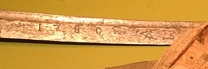

A VOC blade dated 1780 in the collection of "Zeeuws maritiem museum".

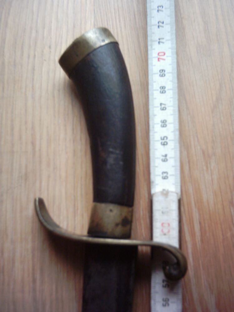

I owned a javanese pedang with a VOC blade a few(4?)years ago.
I found the pictures again, unfortunately not very good pictures.
But they give once more an impression of the blade form.
At that time I also sent these pictures to the dutch Army museum, and the curator confirmed that this was very likely an original VOC blade used for a javanese pedang.
To be sure he had to see the blade in hands, but I did not make the trip to the museum.

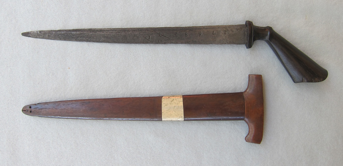

Thank you Willem for posting your Javanese pedang.
Most of the Indonesian swords with the VOC mark in the blade seems to be from Java.
As the Dutch were very dominant in their present overhere (we all have heard about Batavia, even some of you don't know what it exactly was) it can't be a coincedence to encounter most of the VOC blades overhere.

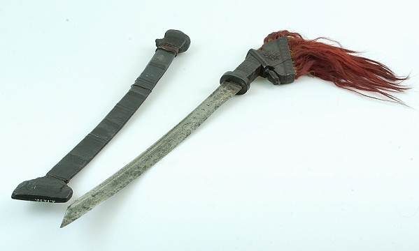

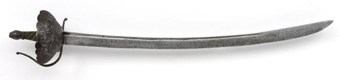

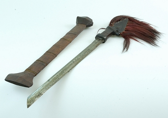

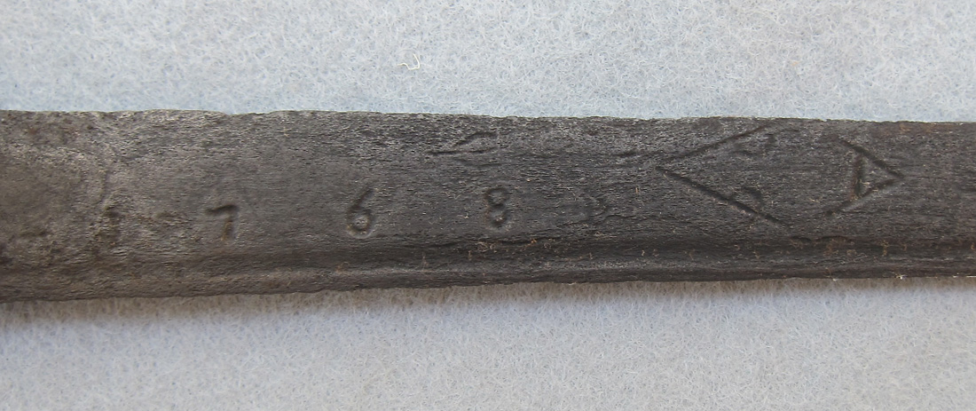

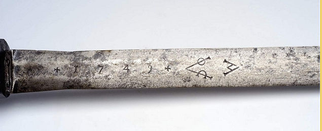

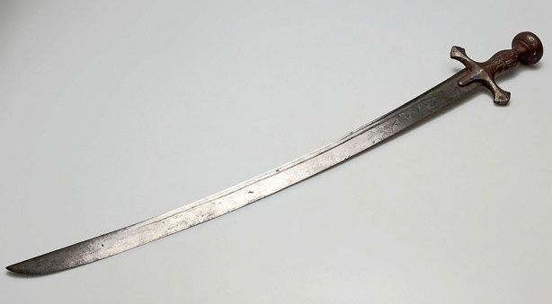

Here three swords with VOC dated blades in the Tropenmuseum collection of Amsterdam.
Two Timor swords, and one Batak sword.
One Timor sword came in the collection in 1887, and I think we can assume the other two also around that time as it's coming out of the same collection of the "Koninklijk Zoologisch Genootschap Natura Artis Magistra".
The VOC stamps, are all three marked with the "A" from the Amsterdam chamber, dated 1749, 1768 and 1786.
Maurice

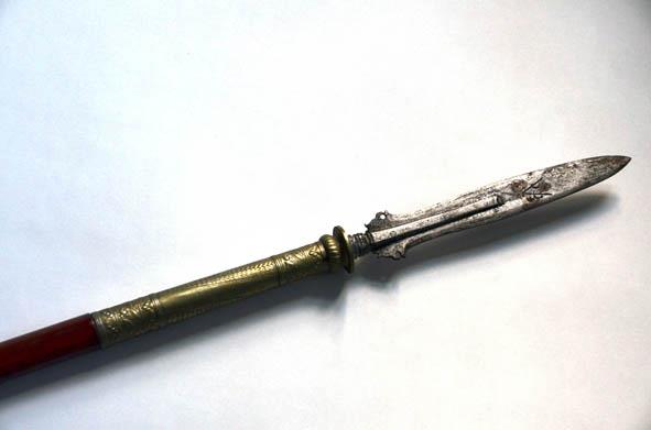

And a Borneo lance, donated by Herman Celosse to the Bronbeek museum Arnhem in 2012.

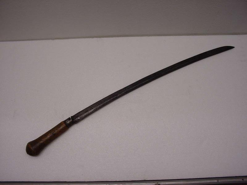

Default Just when you thought it was safe to buy on e-fake...
Originally Posted by Andrew
