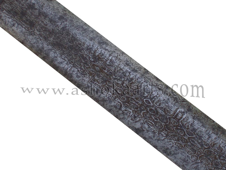

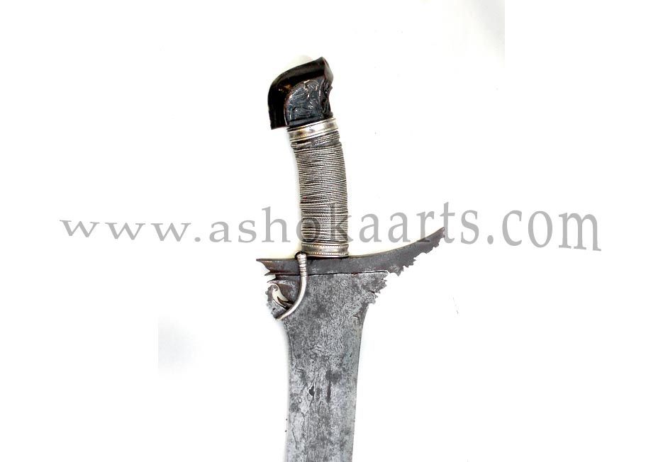

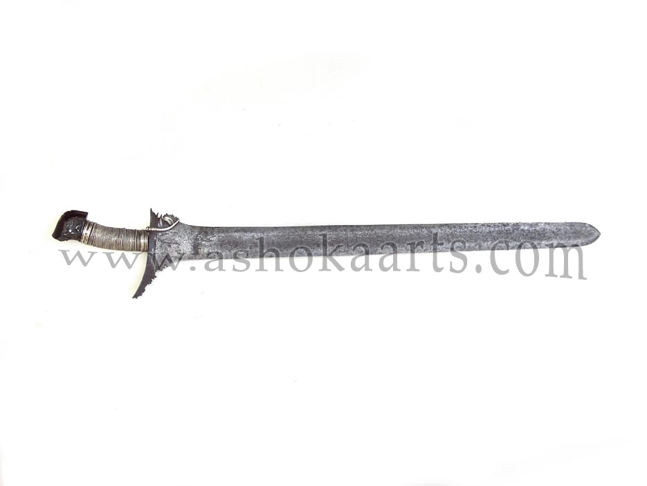

Sold example from Stefan's site:
IMHO Datu quality from Sulu; pamor more controlled.

Sure, the expertise originally came out of Indonesia; this is especially compelling for the twistcore pamor. Still, these are Moro twistcore blades (not hybrids, etc.). I'd posit the same for blades with this much rarer pamor type. What do you think of the example I just attached above, Dave?

Kai: With these types of blades it just seems to be more confusing with each one that comes up. I'll be the first to admit that with these so-called crossovers I just don't know for sure, and I don't think that any of us can be completely sure. I think there is not enough examples to study unfortunately. That Ashoka Arts kris is a real knockout!!!!!!. I would love to have it. That pamor is totally different than anything I've seen. Seems like every time I go on his site, I seem to miss ones like this.......Dave.
