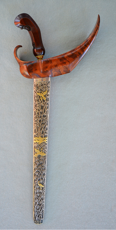

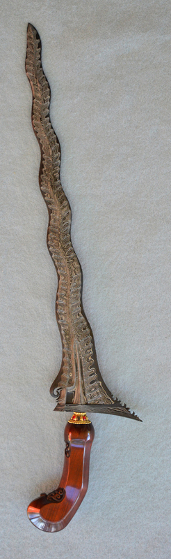

Here you are Peter, this blade has the pamor made from meteoritic material.
How am I certain?
Because I welded the pamor. Then I gave it to a gentleman in Solo whom I considered to be producing the best non-picture Surakarta style keris at that time and had him make the blade. It took him two attempts before I was more or less happy with the job. This blade is still not perfect, the sogokan are not as good as they could be, but he did the best he could with the tools he had. When I rejected his first attempt, I believe it was sold to a diplomat from a South American country, might have been Venezuela.
This keris was made a few years ago now, I forget when, but about 1990 I think. The maker has now effectively retired himself from making keris and out of respect for his wish to remain inactive I prefer to withhold his name.
The warangka is thuya burl, made by Sutejo, the pendok is the work of Bp. Dayadi (alm.), the jejeran is also by Sutejo, the mendak is an old one made of gold and set with natural stones.
Objectively, this could be regarded as a pretty fair example of a current era keris.

Old 21st November 2013, 09:26 PM   #12
Posts: 7,230
The colour caste in the blade is reflected light from a brick wall made of red and yellow bricks.
If I just photographed the bare blade I could remove the red and yellow saturation and you'd see the true colour, but I can't do that with the hilt attached or the hilt would appear without colour.
This was just a quick shot so you could see it. Around my place it doesn't matter where I take a pic there is a another colour comes in from somewhere. When I do a lot of photos at one time I can set up reflection boards and white sheets to block that light, but not for just a couple of quick shots.
There's another factor too with digital photos viewed on a screen, and that is the viewer's screen and its adjustment. In fact, on my screen I can barely see the red & yellow tints. My screen is recognised as a pretty good one for graphics, and I have it adjusted to around 70% brightness. If your screen is not correctly adjusted, or it is poor for graphics, you'll get an entirely different pic to what I can see.
The pamor motif is wiji timun = cucumber seeds. It is a surface manipulated mlumah pamor.
The meteoritic material used in this keris came from Arizona, I bought it as about a dozen quite small pieces, I welded these into a single lump and then washed it by folding and welding a further 7 or 8 times, then I passed it to the maker to use, what he received was a small, perfectly clean billet ready to use, just like a piece of commercial nickel.
