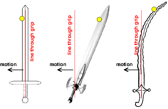

Thanks for sharing all your thoughts. Something quite interesting to ponder. With Dha/Daab it's interesting because there is quite a range in blade shapes from quite straight to more heavily curved. I was thinking that in some ways maybe that with curved blade the centripetal force would help to naturally orient the blade??? This would not help explain things with a more straight blade. Perhaps it just a matter of what you get use to...and with practice you learn to control edge orientation? Or perhaps given the fact that most of the armies composed of conscribed men of the city state who wore little to no armour this was not as big of an issue as it might be otherwise? Aside from swords, we've mentioned polearms and I can think of the Mak, which blade orientation would seem to be important but also has a round shaft...perhaps with the weight of the blade off center from the shaft this also acts similar to the curved sword blade in the the centripetal force helps to orient the blade?

It's not the centripetal force, but just where a straight line through the grip, perpendicular to the motion, lies in relation to (a) the centre of mass of the weapon, and (b) the point of contact with the target.
(a) If the line through the grip is forward of the centre of mass, then starting a swing will tend to align the weapon properly. No need to worry about it twisting in your grasp.
(b) If the line through the grip is forward of the point of contact, then the weapon will tend to stay aligned after contact. This is the same reason why bicycle stability depends on "trail", and why trailers are stable when towed, but unstable when pushed.
In the picture, a straight sword chopping is a little unstable, for alignment, since it strikes a little forward of the line. A straight sword used to draw cut, where the grip leads in the cut, and a curved sword, have the point of contact (yellow circles) behind the line, and will be more stable.
