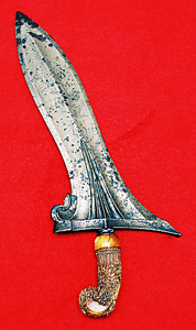

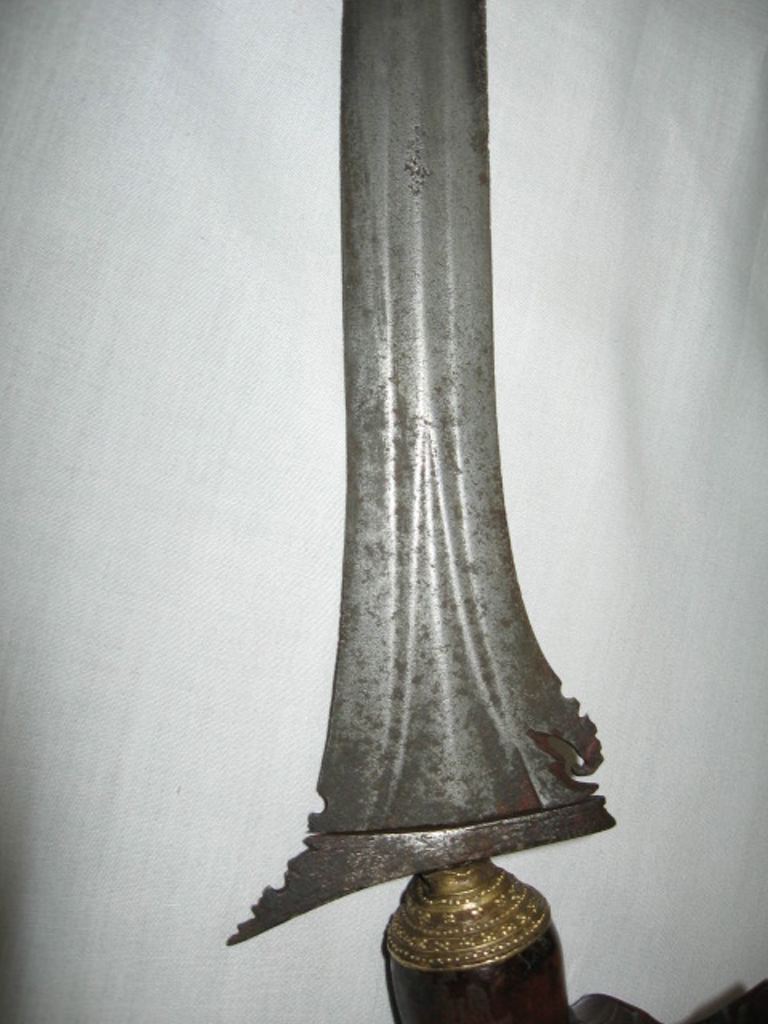

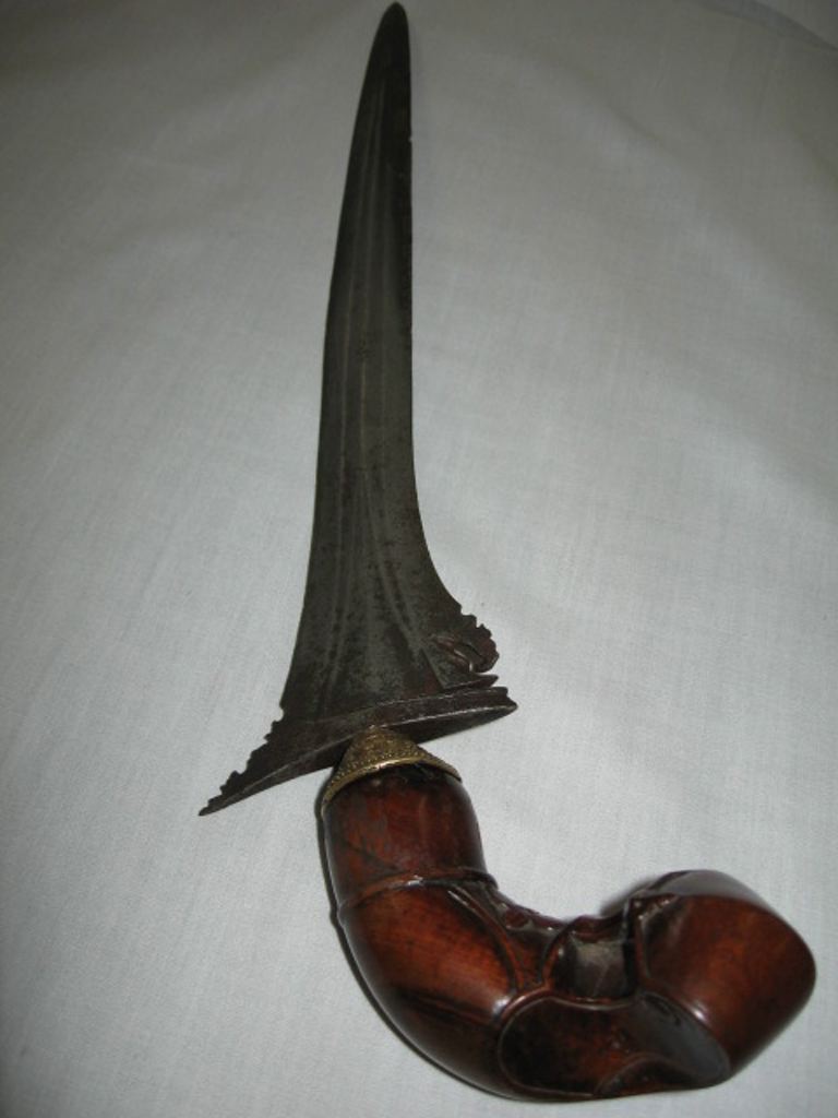

Dear friends,
This kris belongs to a friend and is supposed to be of Minangkabau origin according to the seller.
However there are several indicators that this may not be the case: the shape of the blade and sampir, the style and decoration of the pendok, and the style of Jawa Demam hilt. The blade was cleaned and stained in Solo and revealed some unexpected pamor. Any opinion about its origin will be welcome.
Best regards
Old 19th April 2013, 10:26 AM   #2
Hello Jean,
also when the blade have a Malay influence/touch I think that it is a Minang keris, pendokok is Minang, the handle and sheath as well IMHO. Can show you a pendokok from a Minang keris from my collection which is very similar when you wish.
BTW, very nice and interesting keris.
Kind regards,

Hello Detlef,
Thank you for your opinion. Regarding the pendokok, I did not comment about it because these pieces are common and from the pictures the cup seems to be made from silver but the bottom ring from plated copper?
Best regards

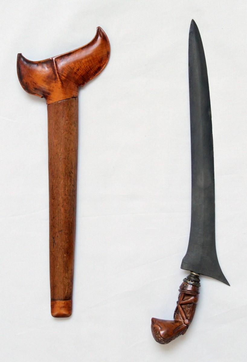

Hello Jean ,
I have a blade with some similarities but no pamor . I still think the blade could be Malay Peninsula .

Henri's keris has an upwards pointing triangular form in the sorsoran.
Does anybody know what this is --- maybe even why its there?

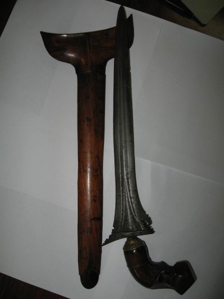

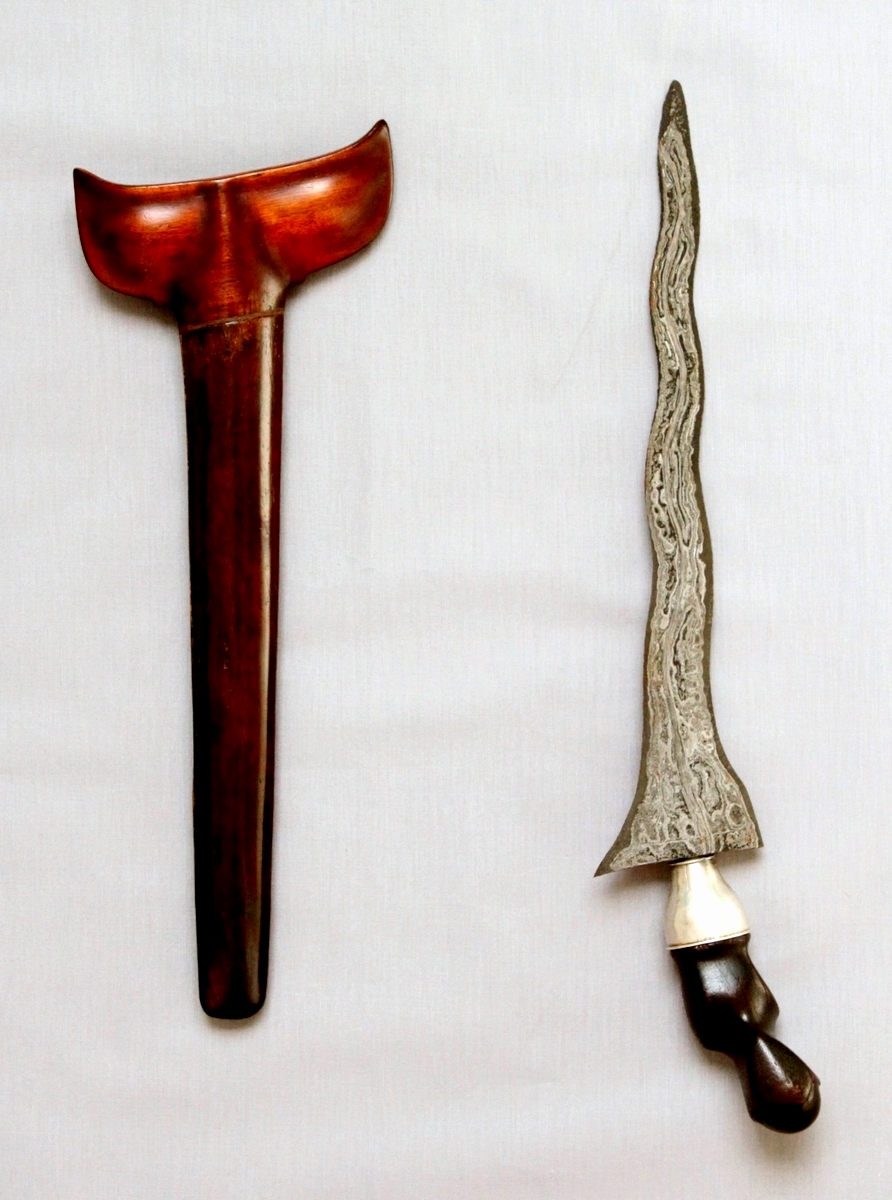

To briefly interrupt the thread of the conversation, I wanted to address the question of the origin of the keris which are a part of the conversation. Both, I feel, come from the area of Sumatra known to the Minangkabau as the "Pasisiah", that is, the intermediary region to the east of the highland core of Minangkabau territory. This is a fascinating hinterland area made up of large parts of what are today Jambi and mainland Riau (traditionally ruled from Siak (Indrapura). The area is a patchwork of Minangkabau, Malay and Bugis origin communities and the keris which come from this area show the complex interplay of influences from all three communities. It is almost impossible to say much of anything specific about the pieces beyond that. Jean's piece is more distinctly Minangkabau in that it mirrors the styles of the heartlands (Agam, Batu Sangkar, Solok etc.) and Henri's is more Malay/Bugis (which by the time these keris were made were largely indistinguishable). A great deal of further research needs to be done on this region before anything distinct can be said about their keris. However, to get a better sense of the immense complexity of the area and of Sumatra in general I'd recommend a couple of interesting reads...one is To Live as Brothers by Barbara Watson Andaya and the other is Leaves of the Same Tree by her husband, Leonard Andaya. Neither says anything about keris but they both give a great sense of the extraordinary interplay of cultures and communities within the region.
DAHenkel is offline   Reply With Quote
Old 13th May 2013, 06:30 PM   #18
Jean
Join Date: Jun 2009
Posts: 1,740
Thank you very much Dave for this very informative post. If you have other typical specimens of krisses from this region to show, they will be welcome!

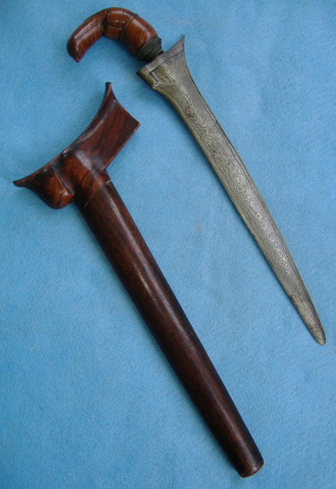

Hello Jean,
have a look to this link: http://www.vikingsword.com/vb/showth...ighlight=jambi
I believe that this keris is from the same area.

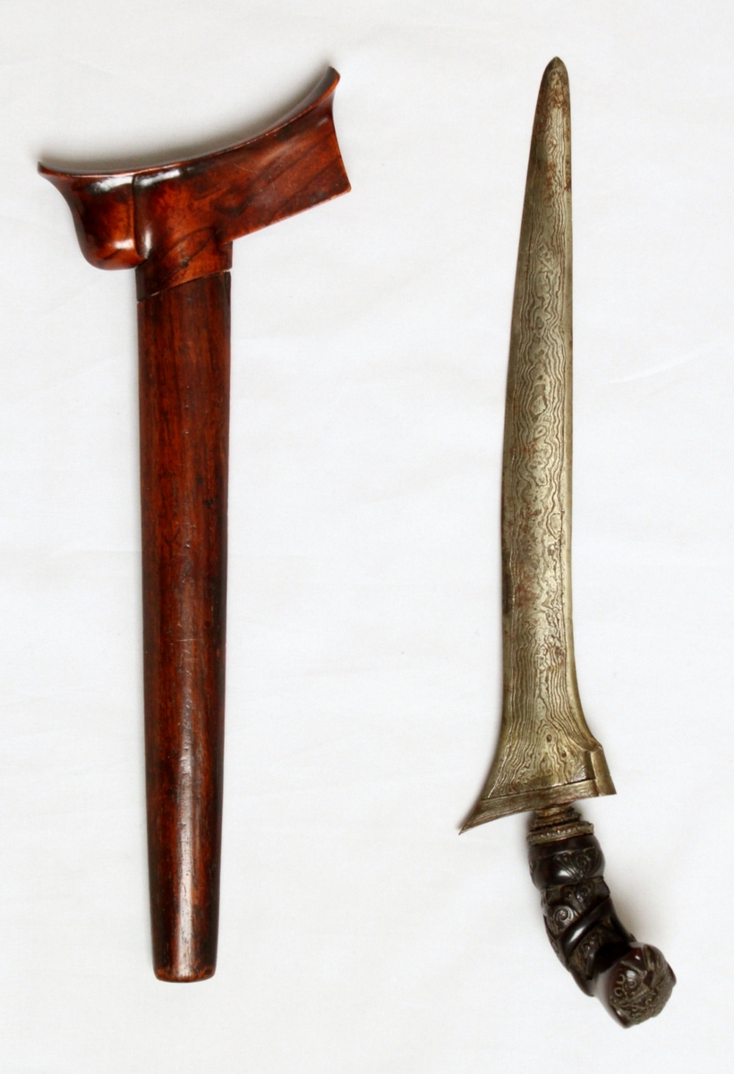

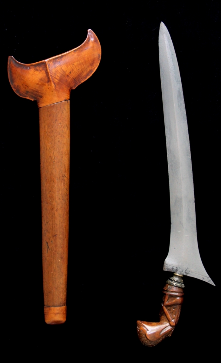

I recently bought this kris on Ebay from a respected forum member and I also wonder about its origin. It is different from the 2 pieces shown above and the kris from Detlef but it may originate from the same area in Central Sumatra (inland Riau or Jambi). Any opinion? I received it with the Bugis pistol grip but replaced it with a large Jawa Deman one, may be a mistake? Sorry for the pictures quality, the blade is not with me at present.
Best regards
Jean
Old 14th May 2013, 07:43 PM   #21
Hello Jean,
beautiful keris, have watched this one as well. I like the blade with it's fine pamor. I think that it is very good possible that this was the original hilt since it hasn't the typical Bugis kerdas form, just my humble opinion.

Definitely a mistake to replace the hilt Jean - I hope you have kept the original. Jambi I'd say and a very nice example. Congrats!
Thank you Dave and Detlef, no problem and I will revert to the original hilt!

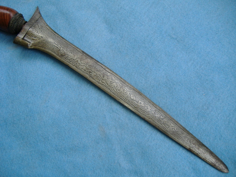

And I take the opportunity to show you another kris may be from the same origin but the blade has no pamor (it was cleaned and lightly stained, see top picture), ganja iras (just a line drawn at the base), and the warangka is in moon crescent shape. I received it without hilt and fitted this small Jawa deman piece but may be it is not appropriate again, opinions will be welcome.
Best regards
Jean

I originally thought these were from Palembang but I've also seen evidence that they may be from Bengkulu. The hilt you have is unfortunately not right for the piece. Afraid I don't have a good photo of my example and its dark out so I can't shoot one now...maybe this weekend if there's time...I attach a photo I stole off of ebay a long time ago. Hopefully nobody recognizes it

Thank you Dave and I have a similar piece to yours attributed to South Sumatra and with a "Durga" style hilt also; however the other one was supposed to originate from Jambi because of the wide and strong blade but I agree that Bengkulu is a more likely origin and so I will also replace the hilt!
Sorry for the picture quality, the good one magically disappeared!

As I understand now, the sheaths shown in the last 3 posts could be also typical for Lampung.
Old 5th June 2014, 05:34 PM   #27
Jean
Join Date: Jun 2009
Posts: 1,740
Thank you Gustav so from South Sumatra for sure!
