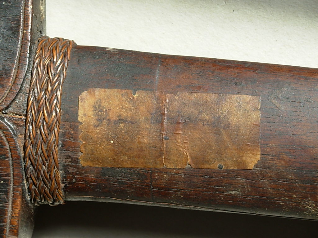

So most probably 1900 would be the latest date Walter S. Crosley could aquire this kris. The tag on the sheath says "From Cottabatto".

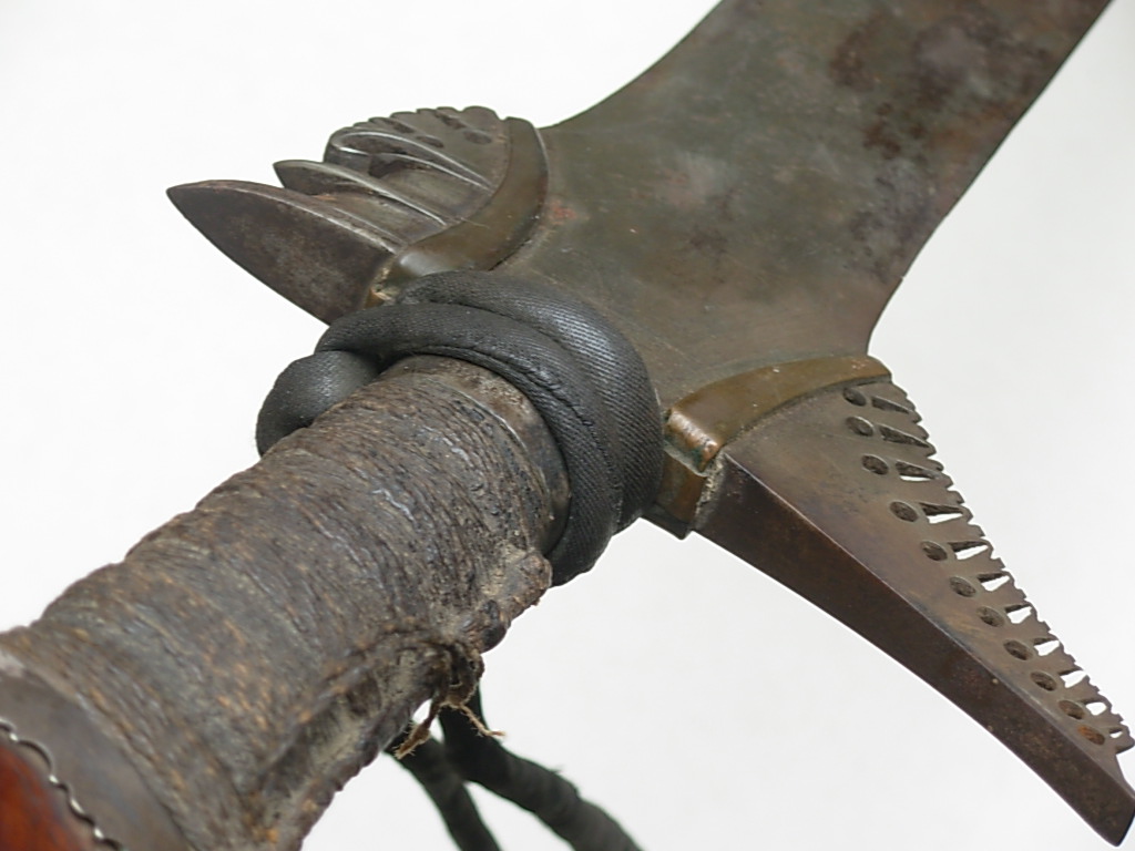

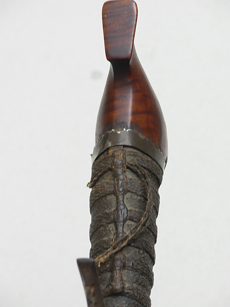

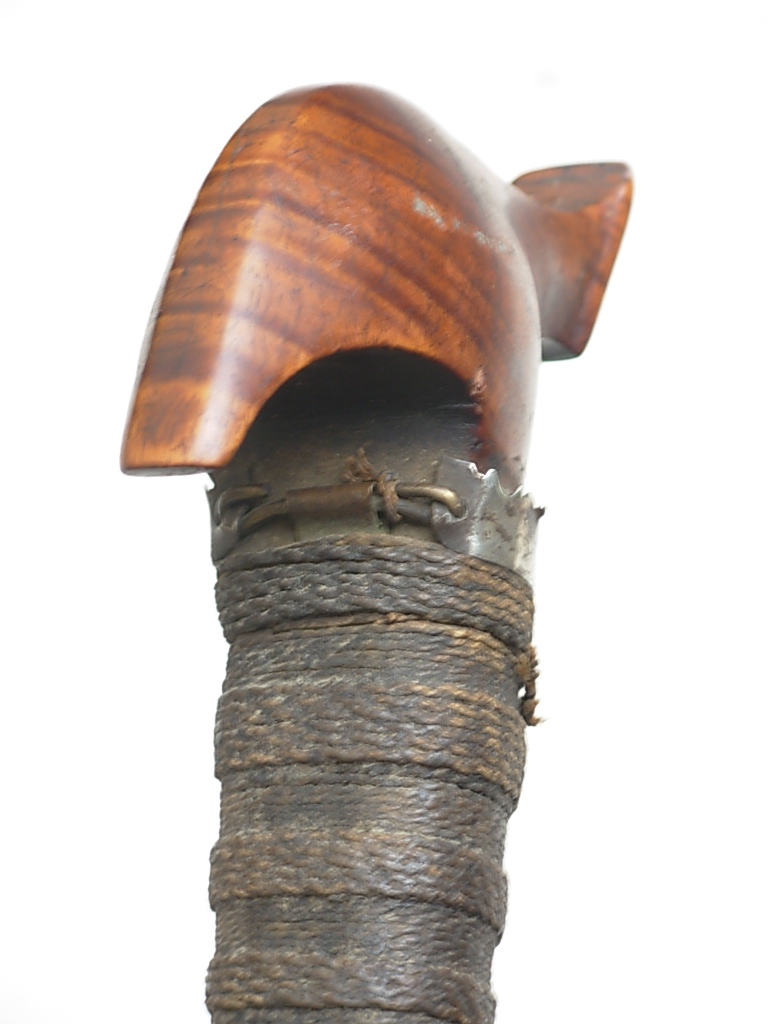

The kris was attractive in my eyes becouse of nice fretwork on gangya (with 13 the highest number of holes I have seen with this kind of fretwork), the nice and big bunti wood Kakatua hilt, the complete scabbard and the cord attached to the hilt.
I wanted to post some pictures before I will start with the cleaning and repair of the sheath.
The length of the blade: 60,5 cm, overall 76 cm. Enjoy!

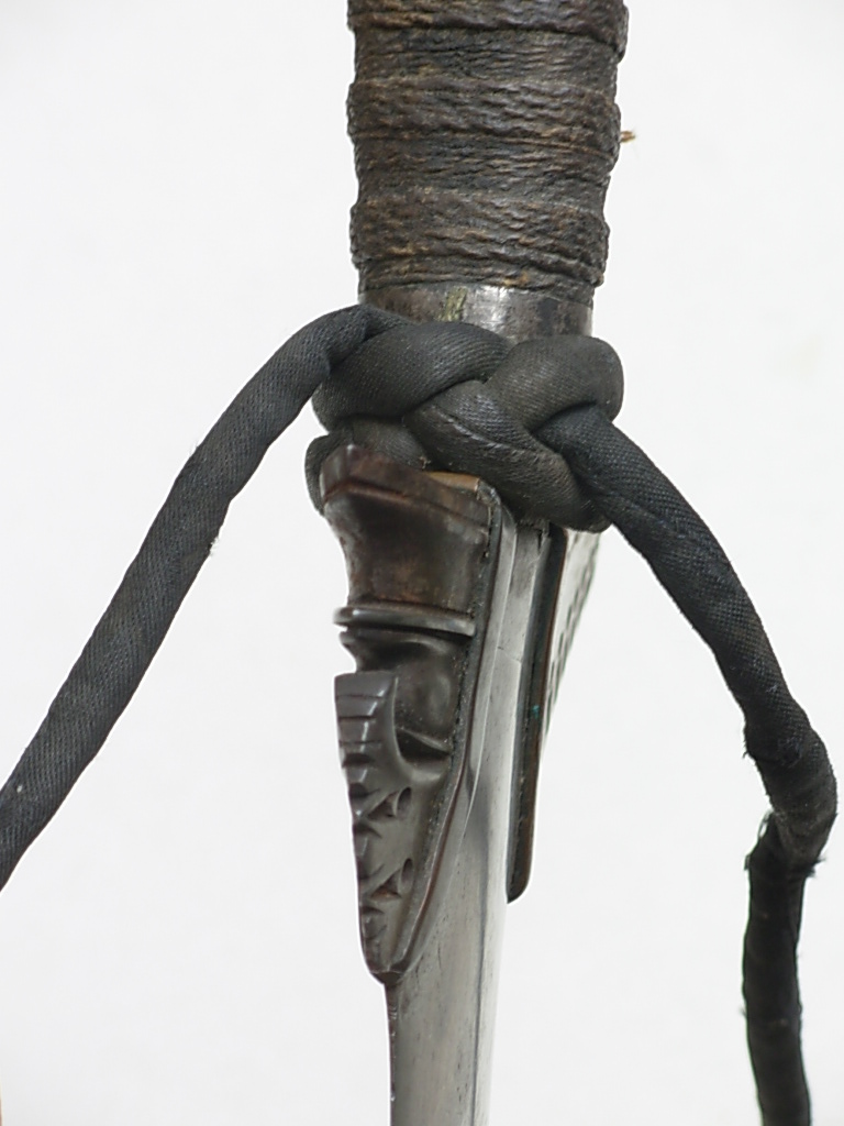

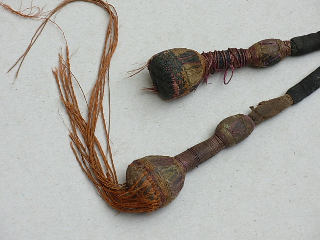

The ferrules of hilt are silver, baca-baca looks like copper. most interesting is the cord attached to the hilt. I only once have seen very similar one in this thread, post#50:
http://www.vikingsword.com/vb/showth...aranao+sundang
Is there some newer information about these cords? As I understand, Cato says they could be Anting-Anting like Munsala or designed to tie the kris to the hand.

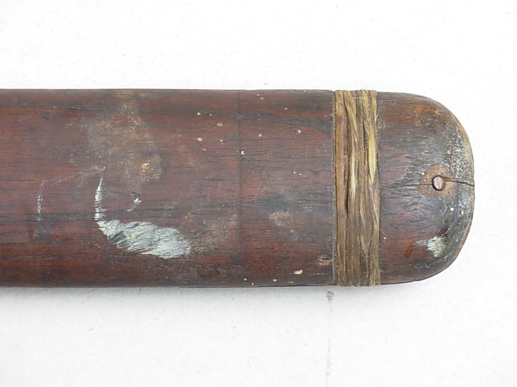

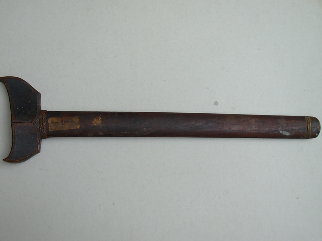

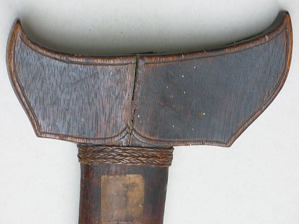

The sheath has an old repair, which I intend to do oncemore in a more careful way. The binding at the bottom end of stem seems to be an old fishing line. the both halves are secured with a small dowel, which could be original.
There are two markings (lines) at both ends of the stem. Perhaps metal bands were intended.

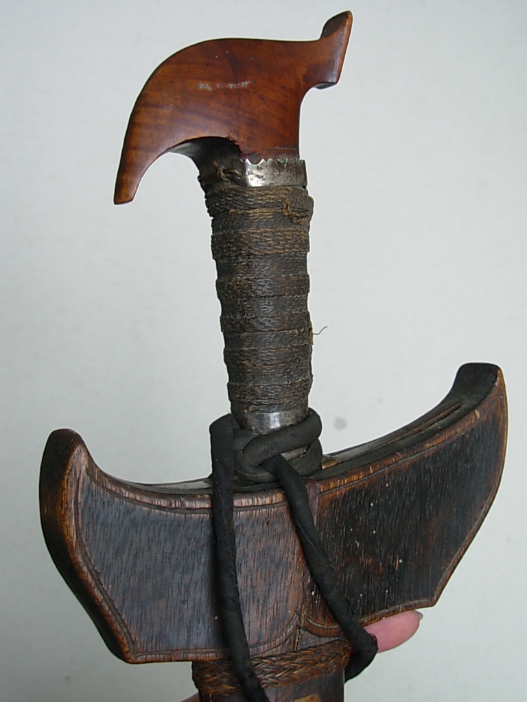

I were also very thankful for any professional advice regarding cleaning and preserving this kris, especially the cord, becouse it is VERY fragile.

Hello Gustav,
nice kris with great provenance! I have watched this auction as well and when I decided to give a offer it was sold!
Be careful by cleaning the silver ferrules at the handle, most probable they are only silver plated. About the cord bands: I would let them like this and handle them careful, I have had the same problem, look here: http://www.vikingsword.com/vb/showthread.php?t=11830

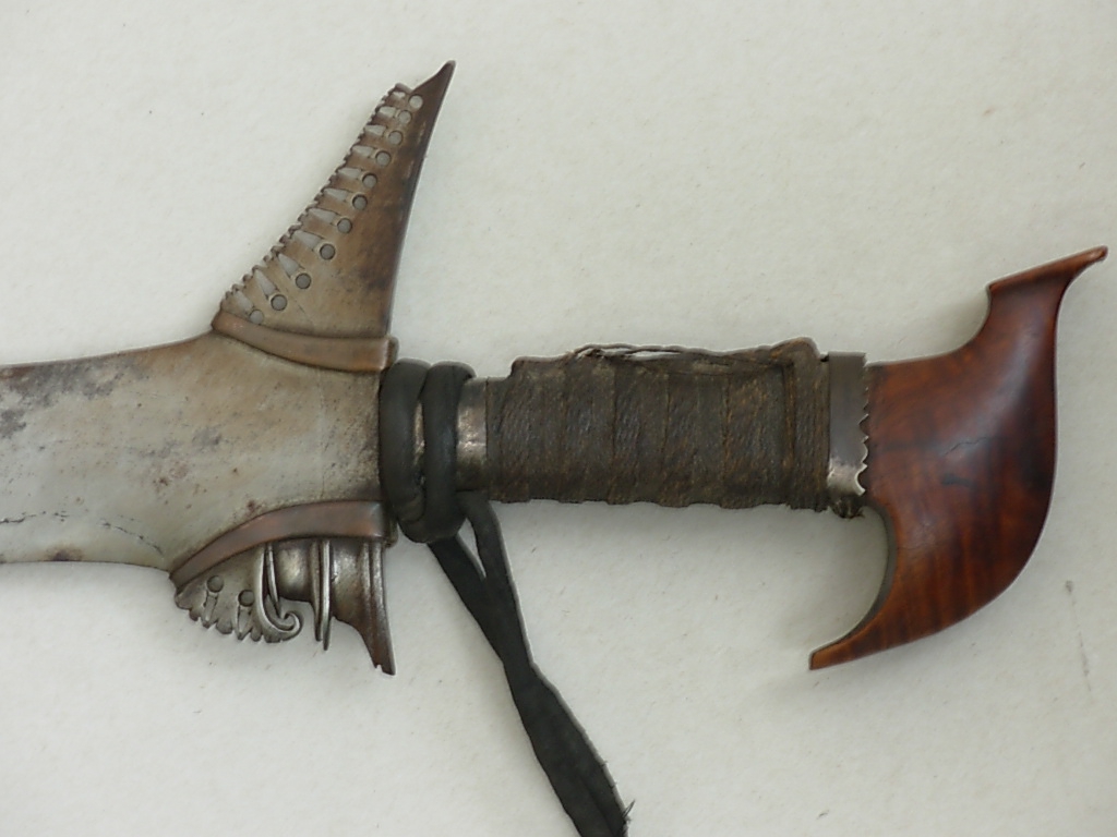

Thanks for posting this with the provenance. It helps so much. Supports the look which is Maguindanao (very close to Maranao).
As far as the cord is concerned, it may be both a mansala and a way of wrapping the hand around the hilt.

Dear Detlef, Jose and PepperScull, thank you very much for your comments.
About the cleaning - I am inclined to preserve a certain "museum look" and clean the silver and wooden parts of it very minimaly. I just feel some discrepancy when I see an old hilt wrapping together with absolutely shining silver ferrules. It seems to me, this is the place, where the preservation of tribal art, where patina is very important, meets the keris culture.
Jose, does it mean, we see this kind of fretwork (Greneng) with holes only in Maguindanao?
Old 17th August 2012, 04:39 PM   #9
Posts: 7,397
So far I would say yes, although I may be looking into this...........
