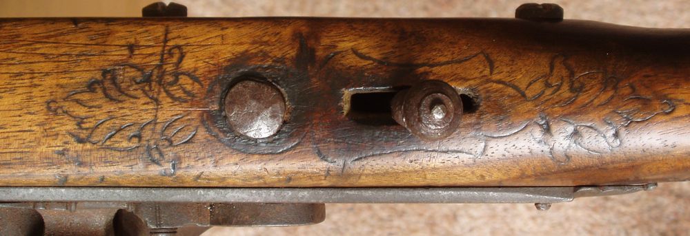

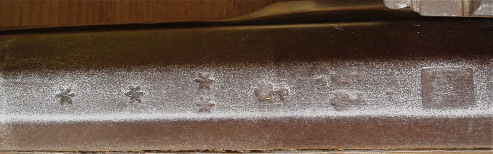

Some more photos of the barrel stamps and the underside decoration around the trigger. Barrel length 31 3/4 inches total length 44 1/2 inches bore just shy of 3/4 inch.
Norman.

Just noticed the two holes in the stock. One at the wrist, and the other where the middle barrel band use to be. This indicates that this gun may have had a sling installed at some point in the past? Rick.

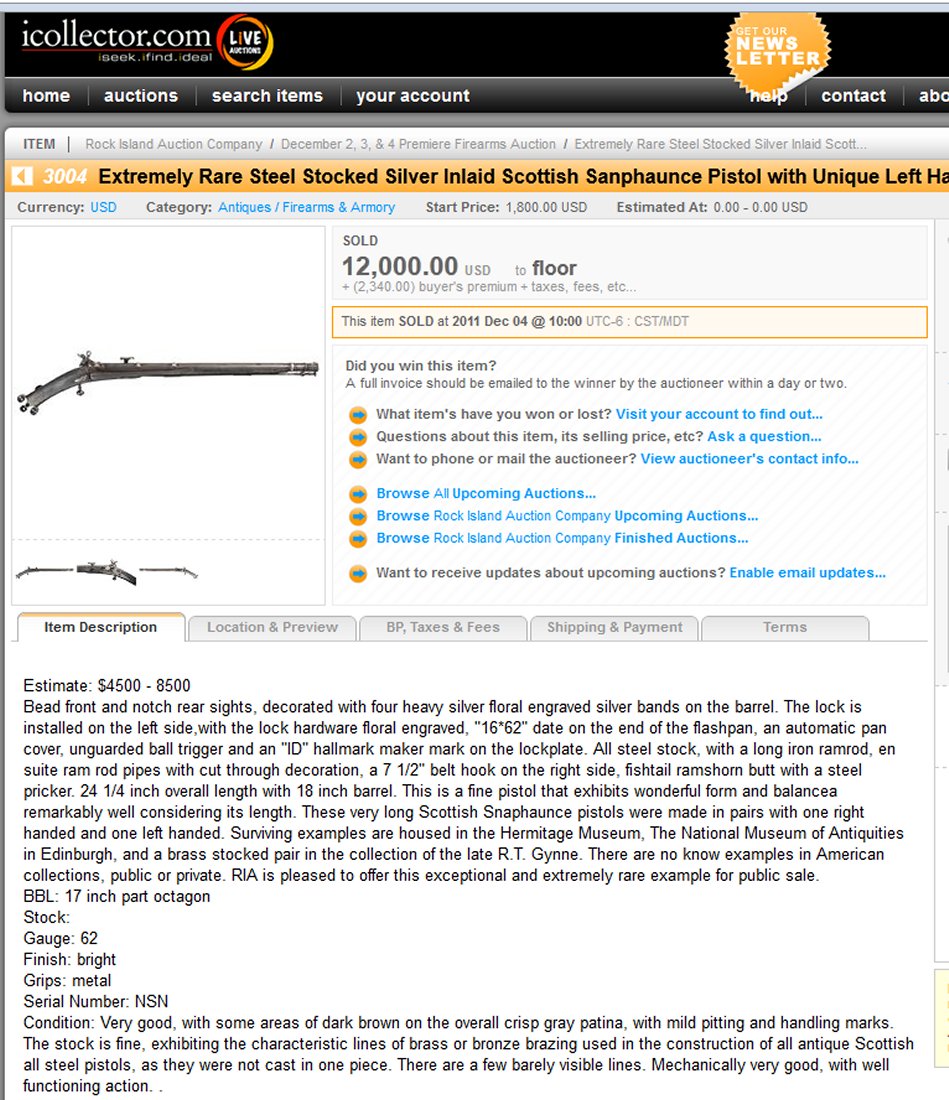

What a fascinating plate. Is it yours, Norman ?
Old 8th July 2012, 09:03 PM   #10
Norman McCormick
Norman McCormick's Avatar
Posts: 1,657
Hi Fernando,
Unfortunately not, found it on the net and I think it it was a sold item from one of the better auction houses but I can't be sure, wish I had taken more note of the provenance. I think it may be contemporary i.e. late 17thC.
Kind Regards,
Norman.

Hi Fernando,
Found the plate on an American auction house web catalogue. Catalogued as Chinese export plate C1745-50. I think the depictions of the people are a bit earlier and this would probably make sense as Europeans contracted Chinese workshops to make goods, porcelain especially, in the Western taste for sale in Europe ( not a lot changes ). Who knows how old the original artwork was that they were copying?

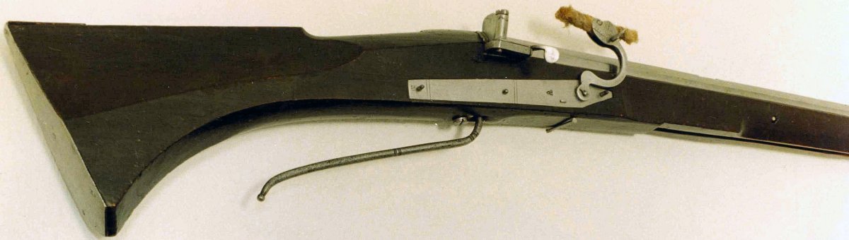

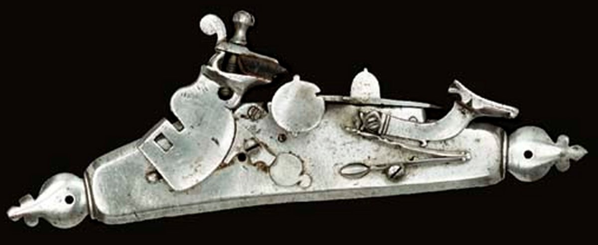

Hi Norman,
This sure is a most interesting find for a Scotsman, and quite early as well, and I am glad I was able to lend a helping hand. For a comprehensive description however I should add that it is a composite piece, not belonging together originally and having undergone several alterations, including the sear and spring on the inside of the lock.
As the three holes in the tang, two of which have been riveted, denote the barrel was in at least two other stocks before the present. Additionally, the crude brass filling of the touch hole makes me wonder whether it was only burnt out or maybe worse, and why it was 'repaired' that rudely.
Two iron bands are missing from the forestock, and maybe an additonal band from the muzzle, where a few splinters of wood have gone.
I remember seeing the decorative and wavy (pyrography?) foliage of the stock on other Scottish firearms before but cannot tell exactly where.

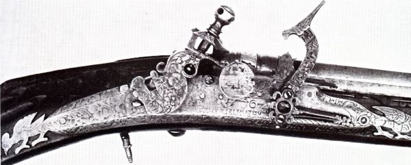

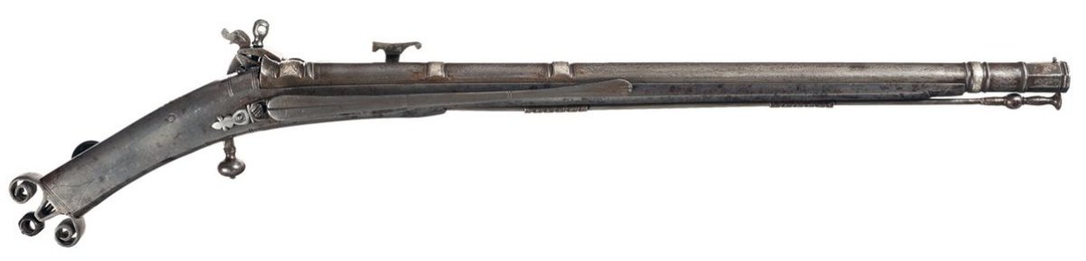

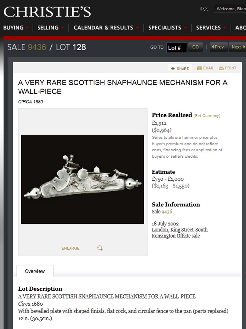

I attach a couple of information on Scottish snaphances for the community which I sent you earlier privately.
The first shows a detached lock mechanism, ca. 1670-80, sold Christie's, and the other a long 'ramshorn' scroll but pistol in excellent condition, the pan shield dated 1662, from a dealer's page, and marked sold. The ends of the first lock terminate in the same acanthus-leaf shaped decorative finials as on your musket.

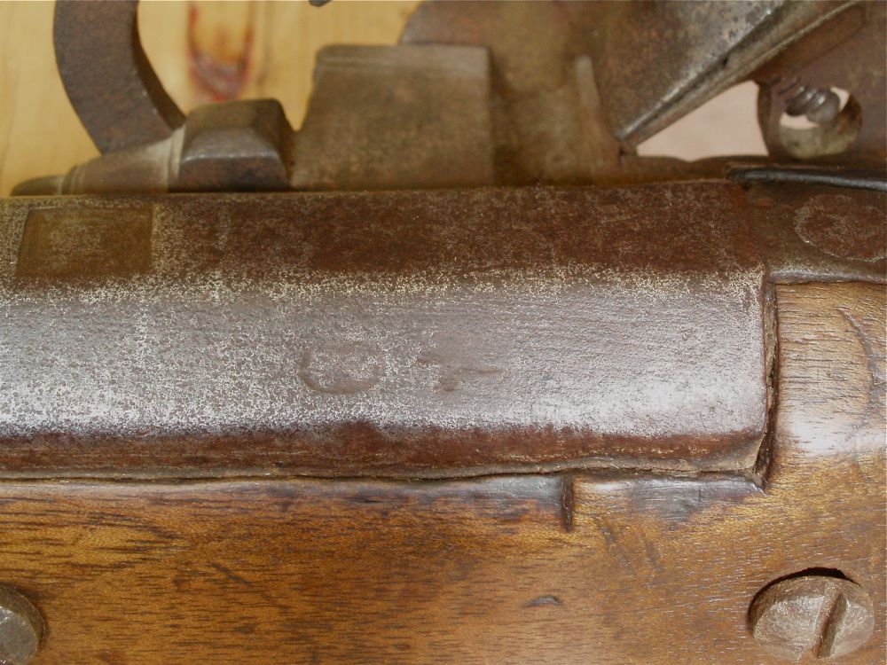

It would be great if an expert in Sottish firearms could identify the now indistinct barrelsmith's (?) marks on the left side and perhaps assign the star-like punched decoration to some locally confined provenance. As I told you, the quadrangular recess above the breech formerly probably held either a dove-tailed back sight or a brass lined mark.
What baffled me at first was the fact that the buttstock of your gun is not of the characteristically bent, bellied and hollowed form associated with most Scottish arms but rather shows an English/Dutch or European musket design. On the other hand, I like the identical design of the top jaw screw and the typical Scottish trigger, without a guard.

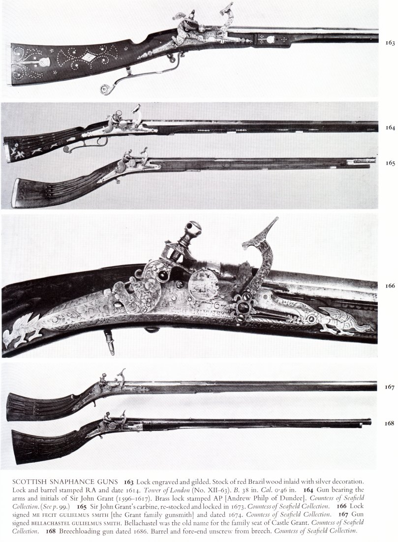

Anyway, I attach some characteristic Scottish snaphance guns, all scanned from Howard L. Blackmore, Guns and Rifles of the World, 1965.
Most interestingly, of all these instances only the detached mechanism on top shows the same rectangular piercing above the toe of the cock as your musket, as a rest for the nose of the sear.
Enjoy your find!
Michael

I was hoping you would come in with a detailed description. Having had more time to look at the piece I get the impression that the lock may not be the first that has been on this gun. The attached photo suggests to my untrained eye that a large washer or a larger headed screw/bolt was once there but this may be as a result of the screw/bolt being replaced rather than an attachment for a different barrel, as I can see no evidence of a trigger guard ever having been fitted to the stock it gives me more hope that the stock may originally be of Scottish origin rather than continental. I have sent photographs to Mr Jonathan Ferguson curator of firearms at the Royal Armouries who is going to confer with Mr Robert Woosnam-Savage who co-wrote a book on Scottish firearms so hopefully definitive information may be coming soon. Many thanks for your kind words and interest.
Kind Regards,
Norman.
P.S. When I think about it the composition could be any combination of lock,stock and barrel

Hi Norman,
Agreed: in the worst given case the item may be composite from three different main parts, and the brass-filled touch hole may conceal the fact that the barrel was converted to (and rebuilt from) percussion - in which case the lock cannot belong.
Also the crispness of the surfaces of barrel and stock differs greatly from that of the much better preserved lock, showing that the first two have seem much more use (and abrasion).
Telling from your lines, my intuitive initial premonitions seem justifiable.
From all I have learned in over 30 years of closest study is to be extremely careful as soon as an item does not look completely characteristic in all its single aspects; riveted screws or pins and crude alterations have become amber lights to me: the only explanation is that somebody intended to prohibit others from dismantling the gun for research - which is completely contradictory to the fact that all main parts of a gun must be easy to dismantle in case when cleaning or repair is needed.
On the other hand, you certainly did not overpay the piece, and some of the scans I attached show that trigger guards were used on both English and Scottish snaphaunce guns from the end of the 16th c.

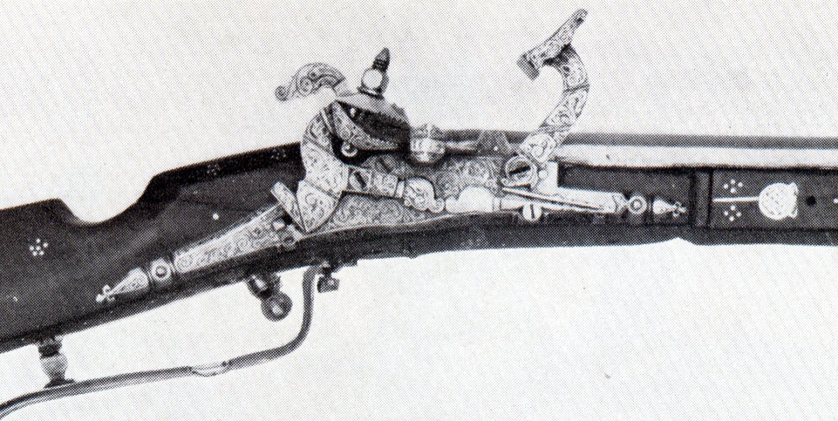

Old 9th July 2012, 07:18 PM   #21
Norman McCormick
Posts: 1,657
Hi Michael,

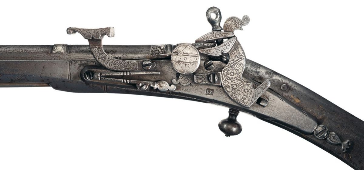

Apart from the obvious the lock on this rifle is the closest in details I can see to mine. On a separate note, there are two small square holes, non identical, and two very small round ones in the rear of the butt. Are you aware of this style of butt occasionally having a separate buttplate maybe attached with hand made square nails, or could it have been a butt extension as we have these days for different sized shooters. Being a regular shooter I know just how important this sizing is. Just some thoughts.
Kind Regards,
Norman.

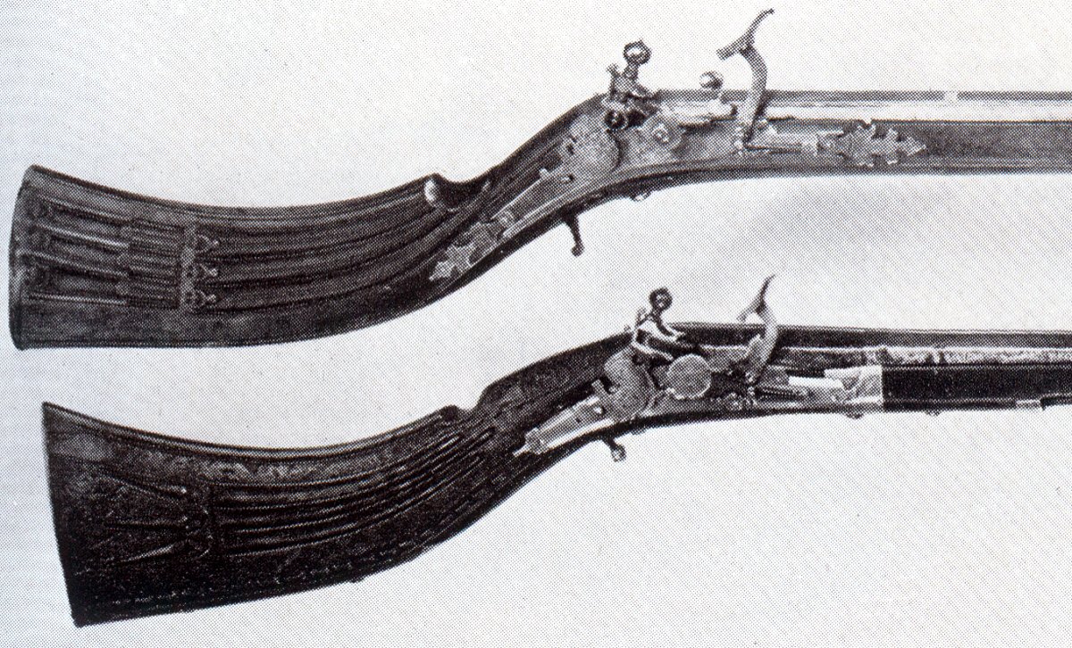

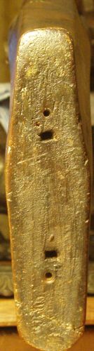

Butt plates did not normally appear before the 1580's on European military muskets, and they were made of very thin hammered iron attached not by nails but by tacks, with small, irregularly shaped but mostly rectangular heads.
Attached are details of a very fine German (Suhl) matchlock musket, ca. 1590-1600, overall length 1.67 m, weight 8.4 kgs, preserved in as-new condition; author's collection.
Only during the first half of the 18th c., butt plates got thicker and more figured, made of either iron or brass - depending on the material employed for the rest of the mounts.
Michael

Photo of the rear of the butt. Got it too, iron butt plates used to protect the wood rather than an aid to shooting.
My Regards,
Norman.
P.S. You can see where the bottom edge has been knocked off at some time and repaired.
Old 9th July 2012, 11:29 PM   #25
Matchlock
Matchlock's Avatar
Join Date: Sep 2008
Posts: 4,310
Yeah,
These look like tack holes.
m

The brazing at the touch hole area is curious. Could it be that the barrel was used on a previous gun? The current gun and lock combination requiring the vent hole in a different position? But, as Michael said, it is curious that it was done so crudely. Hmmmmm.

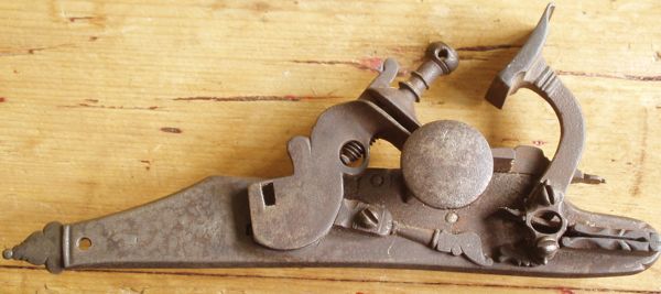

I have now received a reply to my enquiry from the Royal Armouries in Leeds. British snaphaunce C1700 based on lock style and barrel, what appears to be London private proofmark on the barrel C1702 although I get the impression that this is probably open to conjecture. Clearly not classically Scottish therefore not necessarily Scottish. The Scottish aspect is obviously not provable either way but I would like to think, based on info already received, the possibility is there. I'm in the process of arranging the removal of what I think is a ball and charge still in the musket with a muzzleloading member of my rifle club and I will post the results. I am delighted to have this piece in my collection regardless of pedigree and I would like to thank you all for your kind words and continued interest. Should any further information come to light I will of course let you know.
My Regards,
Norman.
P.S. A light application of gun oil and 'hey presto' the lock is working just fine sliding pan cover and all.
