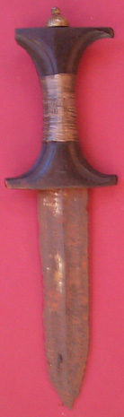

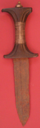

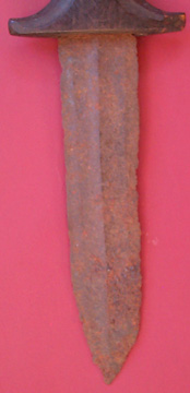

I took "before" pictures of the blade. It looks as if it was stored in a New England boat house for a few winters.
Let them come!
At one time this was a good quality piece so hopefully I can restore it to some semblance of its former condition.
I'm sure the blade will be ok (i.e. better than before ). Let's hope that there's not too much pitting though.

Five hours in the electrolyte solution removed all red rust from the blade. This is pretty remarkable considering that the entire blade surface was colored various shades of red. Although there are patches of bare grey steel, most of the blade is covered with black oxide (magnetite Fe3 O4 ?). This is proving very difficult to remove, especially since the blade is severely pitted. I don't know if another stint in the electrolyte bath would help. Any suggestions? (The methods given in the article aren't suitable for blades.) On a positive note, I have seen no fresh signs of rusting. In any event, I intend to work on the blade a bit more before posting before and after pictures.

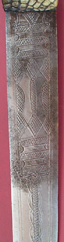

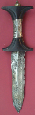

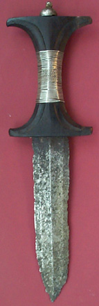

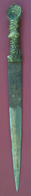

I am posting before and after pictures of two African daggers that have undergone electric rust removal. The first, a Hadendoa dagger, has been very badly consumed by corrosion. The second, a Tuareg dagger, was rusted on the upper half of the blade and only lightly pitted. After immersion in the electrolyte bath, both blades were rubbed down with a 3M abrasive pad. Even though Ann cautions against this method, it appears to me that the proceedure yields good results. Perhaps the preservation needs of archaeologists are different than those likely to be encountered by the average blade collector? I would appreciate it if members would take a look at the results and offer feedback. I would especially welcome the advice from members that have successfully gotten rid of the grey staining that remains on blades once the rust has removed. Is there perhaps a poltice of some kind that can take care of this? The last image in this post is the Hadendoa sheath. For those that wish to see the Tuareg sheath, it can be found on the thread titled "Large Sudanese Dagger for Comment" by Louieblades.
Sincerely,
RobT

The result is very good. You are correct to point out that the needs and requirement for restoration and conservation can be very different. I will be looking into this more again, when I get time. I will let you know the results so each of us can decide when it is an appropriate treatment, and when not. By the way, nice blades.
Ann
