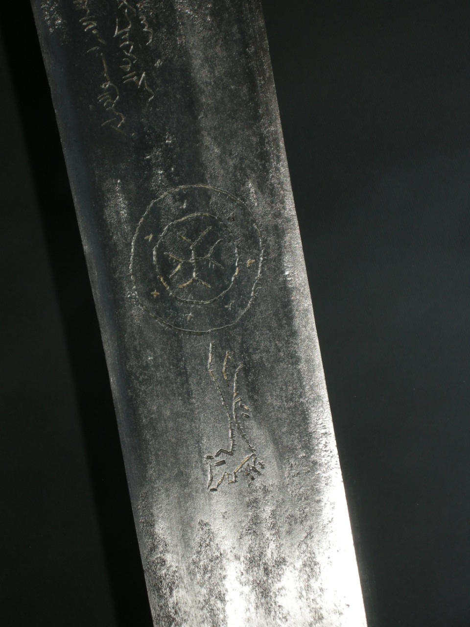

Pag. 13: Origins European Blades examples
2 “Second sword from Jean-Paul Cazes, wolf appears to be a locally imitation. Other mark appears genuine. Likely Solingen.” I suggest you to add the details of the marks and the reason of your statement because otherwise it is difficult to confirm it. I do not want to be misunderstood. Most probably you are right but I would like to understand which is the reason of your attribution.
3. “Third sword from Chris Topping, formerly in my own collection. Possibly a European blade but the half moons almost certainly applied locally. Likely Solingen”. Why you says the half moon was applied locally. Which evidence ? Half moon symbols are also found in European blades and , according to many authors, also copied locally but I would be able to distinguish. Do you have a key ?
The attribution for the sword with the wolf and the wolf being a local imitation is based on a few factors. Usually the wolf is not off center in the fuller, this one is. The depth of the mark is much different than the maker's stamp at the base of the blade. Compare to the first sword on that page and you will see just how poorly done that wolf is. But it is always tricky trying to tell with these blades and I could be wrong! However in this case the sword owner agreed with me and had similar feelings.
With the number of fake stamps applied in these regions, it will always be a bit of a guessing game I think.
The second sword, it may be an entirely native blade, but the steel quality is well above average. The reason I think the half moons are local is for a couple reasons, the depth of the stamp is uneven, the mark was applied to almost everything locally and Briggs if I recall correctly suspected that most if not all of these half moon stamps were applied locally. But I'd need to dig up Briggs' paper again to be sure. I would say there is no real key to distinguish, I wish there was! I am very cynical with any sword from the Sahel and usually assume its a fake.

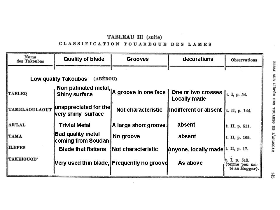

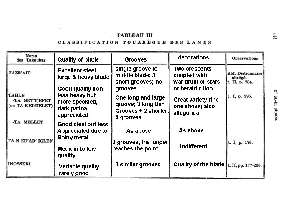

The classic pommel of the takouba, according to Morel (1943) that collected data in the field, has the form of a shield, a miniature shield-amulet, called darôr, that indicates a magic metal created to protect the owner. The use of copper as talisman is also well known and again confirmed by Morel. To the talisman effect of the copper in the pommel, copper or brass is frequently used in the pommel and the scabbard. Morel also explain that the symbols decorated on the visible face of the guard and scabbard are all talismanic used to protect the owner and to reflect the bad eyes and the evil spirits. He also specify that the maâllermin (the Tuareg smiths) usually repair and model the blades that came with the caravans from abroad. May be you will like to know that before to choose a good steel (elhend) it is a common practice to keep the blade in water for 40 consecutive days in order that a series of small reddish dots appear. They will be removed in a later time, The Tuareg also have a classific of the blades according to their properties and I enclose my translation from French.
Mauro is offline   Reply With Quote

I've read a bit of Morel before, it is of course an important work but entirely Tuareg centric while the takouba form is not. The Tuareg beliefs regarding the need for talismanic brass and copper elements were obviously not shared by all the other takouba using peoples although many of the designs found on leather were.
Yes, the vast majority of blades used by the Tuareg were imported, mainly from Hausa cities like Kano.
The note on the idea behind the pommel for the Tuareg is interesting. I wonder which pommel form it refers to though? The stacks? Or the earlier flatter pommels? Or the oval pommels? I think you have seen them before but the earliest Tuareg swords I am aware of, where we have true dates for the hilts, are these http://blade.japet.com/takouba.htm (scroll down the page).
