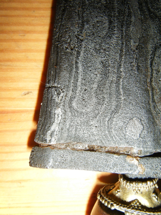

Dear members,
may I ask you what you think about this keris blade? Do you think that it is a modified blade or original like this?
Excuse the quality of the pictures, I will take better ones soon but I think all what you need to see is to seen.

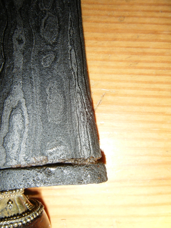

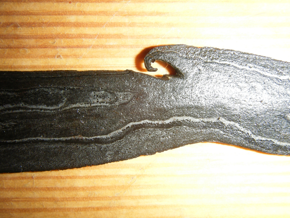

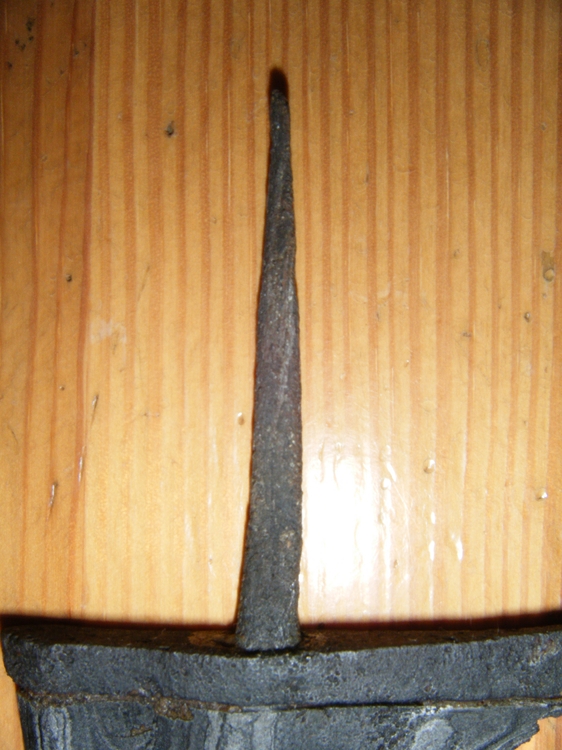

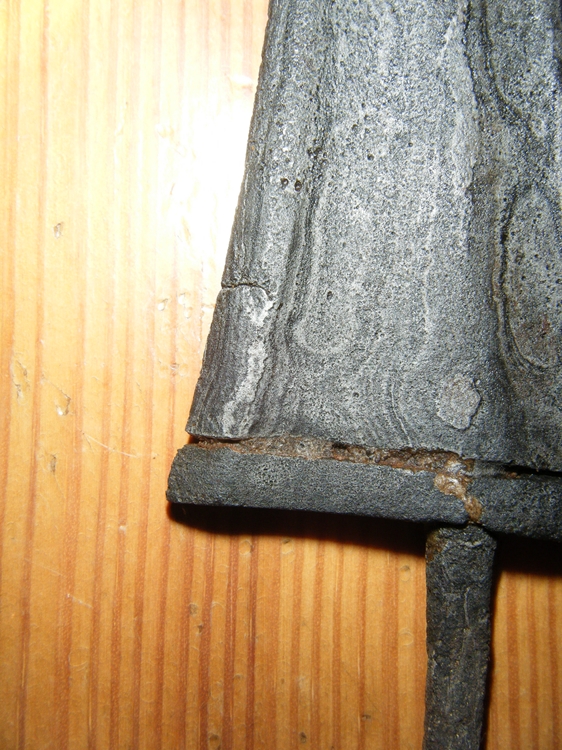

Old 23rd October 2011, 06:36 PM   #3
Hi Rick,
thank you for fast respond.
I am very unsure, it is obviously an old blade with an old gonjo repair and an old worn pesi. I have taken some close ups now where you can see (I hope) why I am a little bit distrustful. Look at the first and fourth picture! And I never have seen before a blade with such a shape/dhapur. I have learned here and by years of collecting to be suspicious.

Old 23rd October 2011, 11:17 PM   #8
Originally Posted by David
Well, it looks like a variation on a dhapur i have seen called Kebo Giri, though all the ones i have seen, including the one i own myself, are stictlly a lurus dhapur. I have never seen one become a luk blade above the sekar kacang.
All of this form of Kebo blade are exaggerated and have the sekar kacang way up high on the blade.
Hi David,
I am as well never have seen a Kebo blade where up from the sekar kacang luk added. But your hint that the sekar kacang is every time way up high on the blade would mean that the denting seen by my first and fourth picture mean nothing and be caused by forging!?
