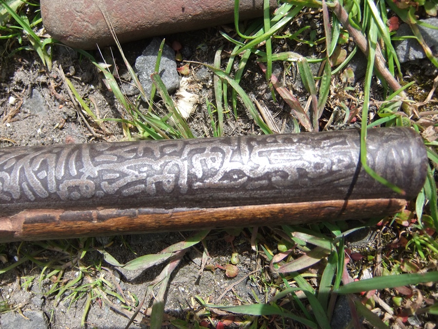

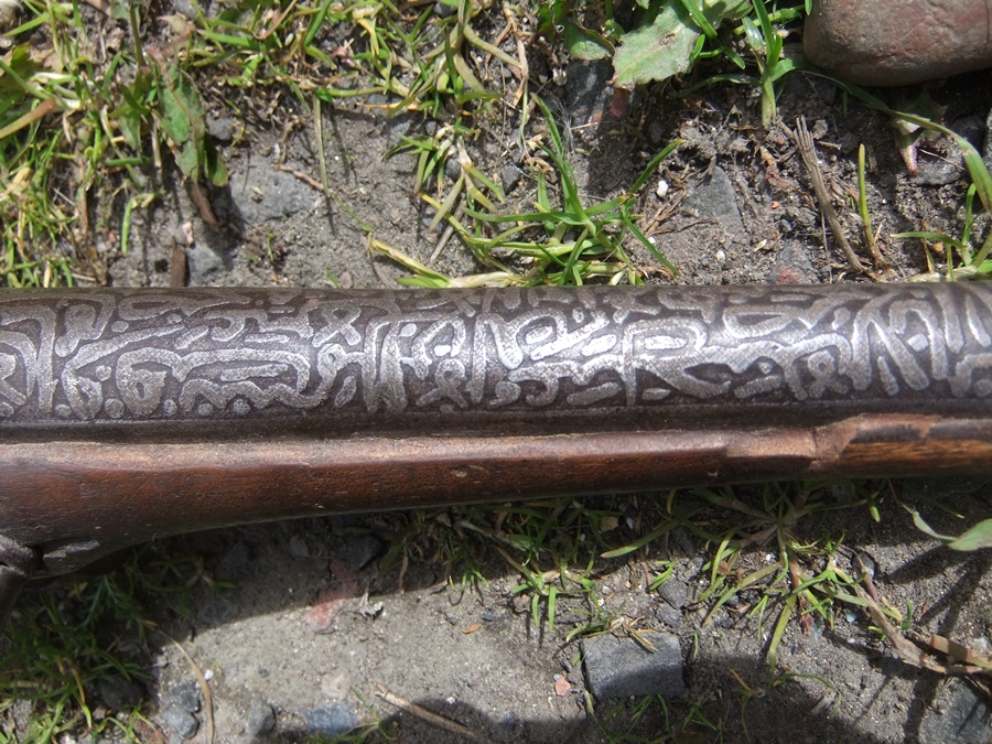

Post some pictures of the inscription and I think we'll get it translated soon enough.

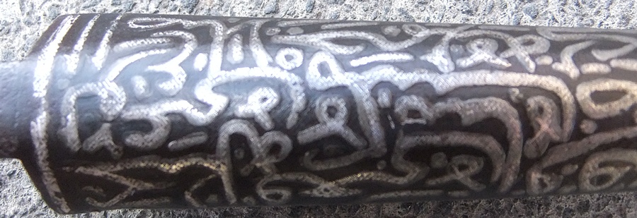

Such a beauty, congratulations. Welcome to the forum :-)
Thanks for the warm welcome

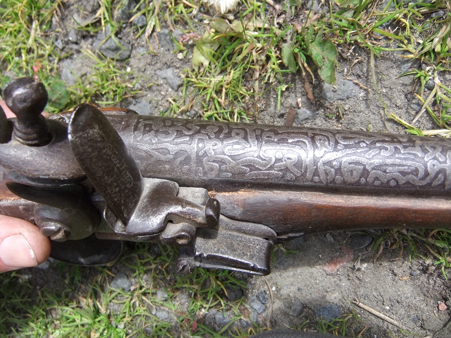

i have attached pictures of the text .. hope you can help

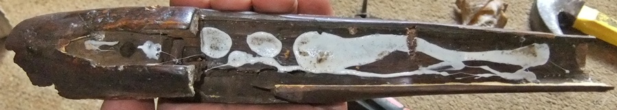

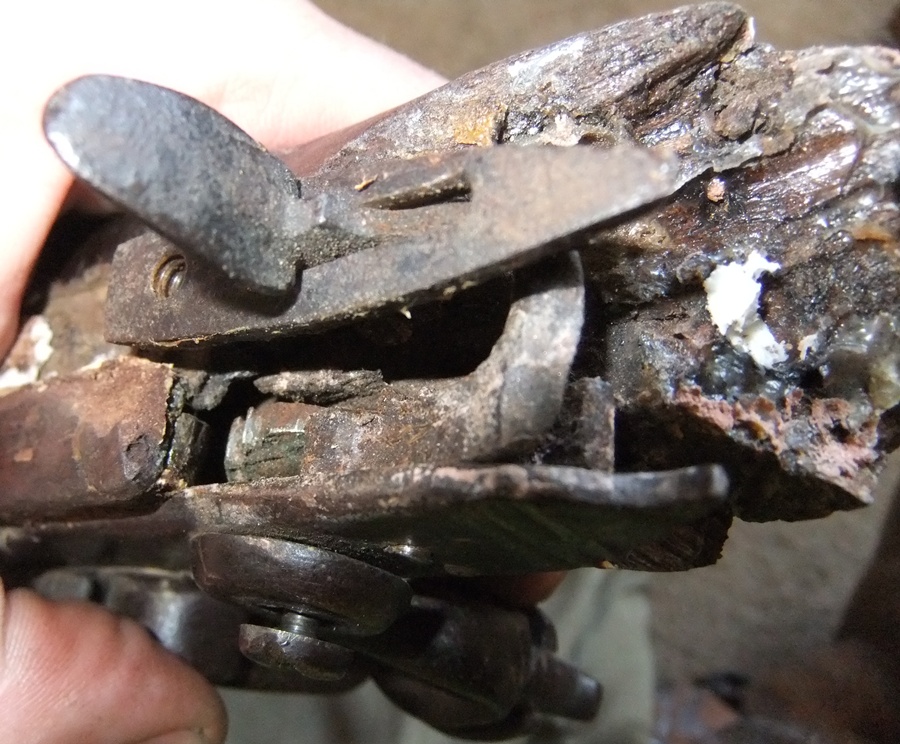

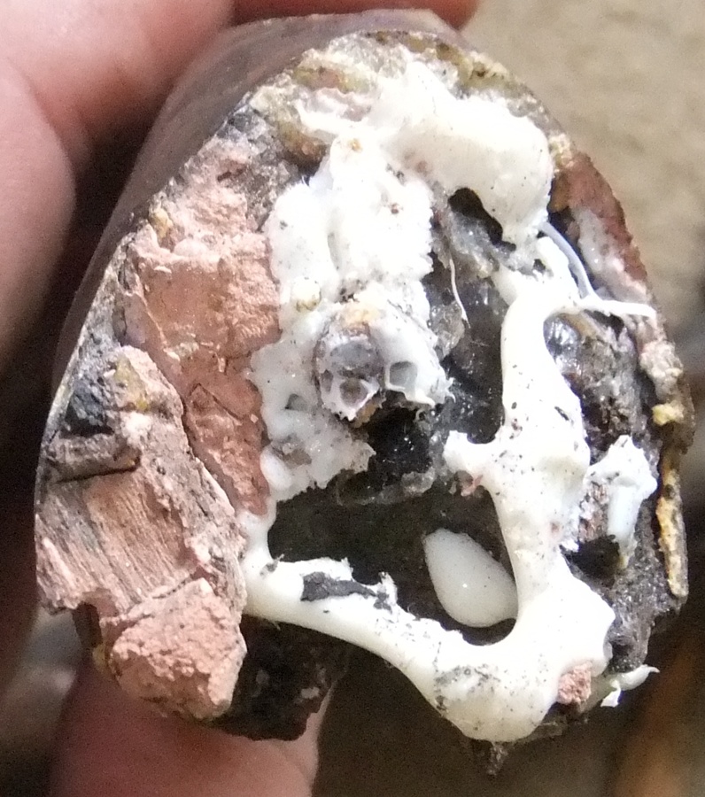

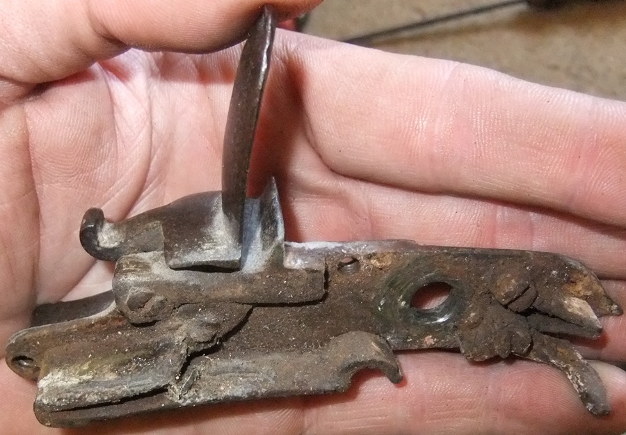

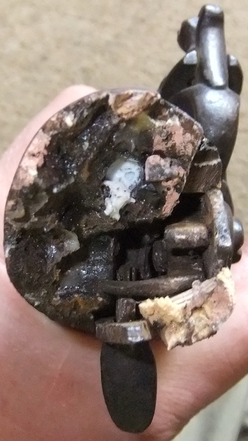

Whoops sorry .. had to be done when i saw the state of it inside ..
check out the state of the wood when i opened her up

More "yuck" photos
Hi Dooly
I know the damage is mostly modern, but often we see repairs and filled areas on these 'ethnic' guns. I would say that you have either the option of replacing the woodwork, or repairing it with infill and replaced areas.
Whats your plan?
Best

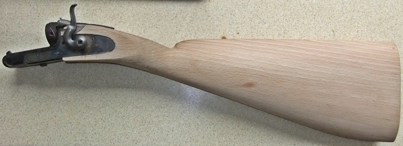

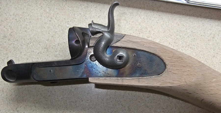

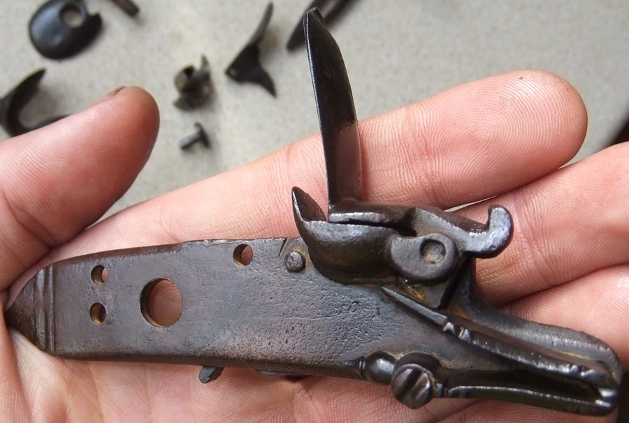

Hi .. I do restore my guns .. but i try to be sensitive And the wood work on this one could not be saved .. almost fell to bits in my hands.
I have attached a couple of pictures of a early hammer gun which was found in a farmers shed a few weeks ago .. totally rusted solid and the stock was snapped and rotten .. this is where i am at with it at the moment .. i have decided to "rainbow" the metal on this one and the hammers will be browned .. the stock is in the oversize stage and needs lightning once all the metal work has been fitted .. the wood is steamed beach and will be stained the the correct color once completed .. Luckily the Farmer had stuffed the barrels with oily rags before dumping it in the shed and the barrels are still in proof so hopefully this season it may bag a bird or two for the pot

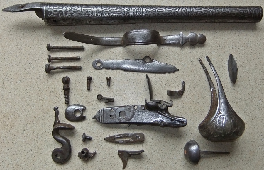

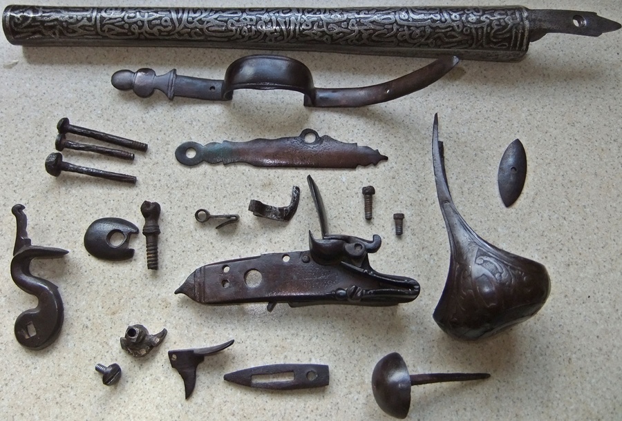

Now stripped and initial dip done

Well all done bar the barrel .. looks like the lettering was silvered or something .. will think about what to do with it ..
all barricaded now just let the oil soak in and next the stock .. still need to work out if i should make it with a ramrod holder .. what do you think
dooly is offline   Reply With Quote
If for instance it's Ottoman, then it may well not have had a ramrod (or have had a short 'false' one). Is there a recess on the original part of the stock in front of the trigger guard?
I'm suprised nobody has come in with an opinion of origin. I was thinking Ottoman?
What have you done so far? Cleaned with an etchant, and browned with heat and oil?

...I think the writing is Arabic - acid etched thuluth script.
stephen wood is offline   Reply With Quote

hi thanks for the response .. The script is very similer to "ottoman" coins i have in my collection .. but they have been no help to me..
Rust and blue removing solution then heat and plum brown with fast cooling then barricade oiling .. i have also spent the last couple of hours hand blueing the barrel .. to late to do pictures tonight and it is in the proofing oil .. will sort a picture out tomorrow .. then i guess i will start looking for the wood for the stock .. thanks for the response
all the best
thanks for the link i can see what you mean .. i was thinking it was Scriptures or something simmiler..

IMHO get rid of the "rainbow". Obviously done with heat. English locks of this age were not as far as I am aware "case coloured", so need to be browned to match the hammers. Similarly all other metal should be browned. Vintage looks about 1880.

The acid etched script on the barrel is Islamic calligraphy known as 'thuluth' and seen characteristically in the Sudan on weapons during the Mahdiyya period in the latter 19th century. This was also known in Ottoman regions in Egypt and others in degree, though it had been largely been superceded elsewhere in Islamic inscriptions of Qur'anic verse by the Naskhi script.
This appears to be a trade produced flintlock made in the English style and the pistol is mounted in a style which appears much in Balkan style with the sharply angled neck and butt. These were often produced for native consumption , and these type guns were entering Cairo centers, often cheaply made in Leige in the 1870s or so. Apparantly mostly muskets were coming in, but it would seem flintlock pistols did as well in some degree.
The thuluth etching on this barrel suggests the pistol may have been handled during Mahdiyya times (c. 1884-1898) but as these were not commonly used by these forces, it is possible this may have been a special case issue or award.
Yes the rainbow .. was an optional extra i liked .. it came about when i was heating the springs for re-fitting .. you do get a few which were colored at this period but usually top end guns .. the workings are by Stanton & Co .. and the retailer is R.W Richards .. who i have not been able to find (i dont have the London book) but i would also put it about that date

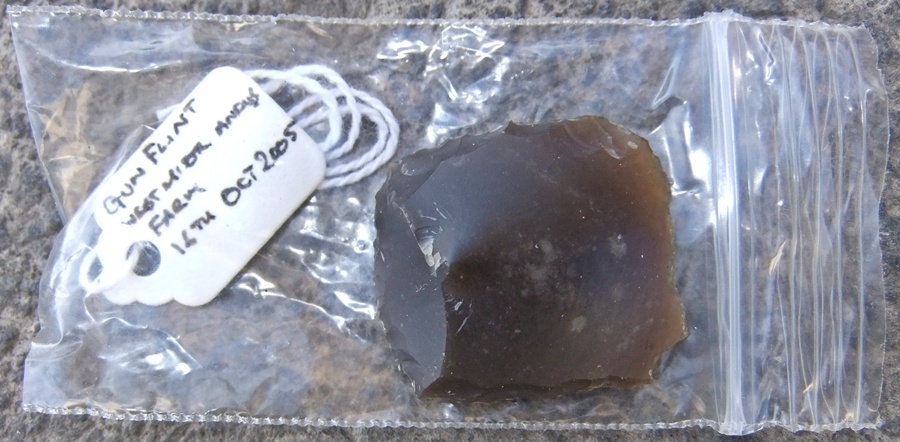

Hear you go .. a couple of shots of the hand bluing .. I think another 4 or so coats and it will be ready to buff it up
the second is of one of the flints i have found field walking ..

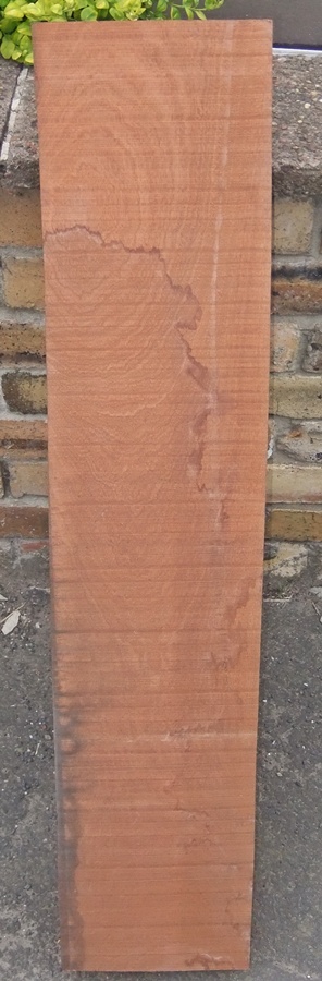

Hi Jim .. just a note on the arrow heads and tools i find .. hear in Northumberland .. all my finds are handed over to the finds leasion officer at the Hancock museum in Newcastle who records the site of the find (my metal ones as well) on a national data base .. so far i have found 9 unrecorded sites of neolithic activity and 6 Roman sites .. there is very little information from this high up in Northumberland and Rob is very happy when he sees stuff from up hear .. .. I have some videos on youtube if anyone is interested under doolybottleking .. why not have a lookin some time ..
PS all my digging and detecting is with the landowners permission !!!

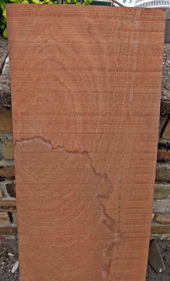

Now back to the gun .. well my timber man did not let me down .. I have attached a couple of pictures of the bit (1 meter) of Cameroon Sapele i have chosen for the gun .. (the timber is FAS registered). I think this is as close as i can get to a appropriate re stocking timber for this gun ..
link to the tree
http://en.wikipedia.org/wiki/Sapele
Now the next hard bit .. pick the bit to cut out the new stock out .. !!!

Great news on the timber!!! please keep us posted, and this pistol is gonna look great!!
