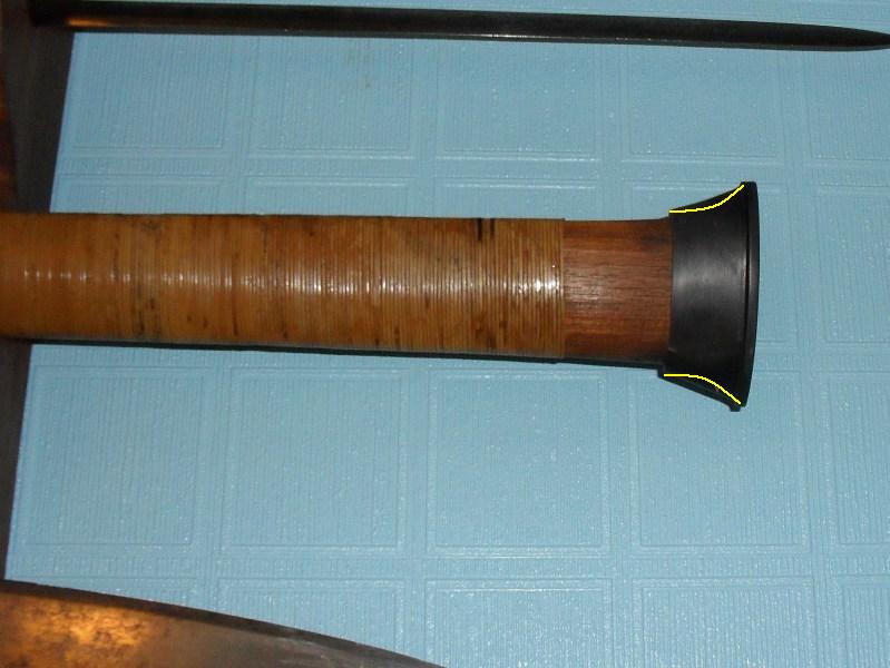

Hi all,
You may remember that this sword had some scabbard issues.
Hope you approve of the restoration.
New scabbard end is carved from a single piece of buffalo horn.
I think at the moment it needs to be a little thinner, what do you guys think?
Before and after photos below>

Good work already but agree with you and the others, work it a little bit thinner and it will fit perfect!

Hmmm, difficulty is, the top mount sits into a recess and the bottom doesn't. So it's always going to look 'fatter' than the top.
Also The horn I'm using is darker
Does this look any better?

Hi Amuk and Jose.
I've thinned it as far as I can. It's a difficult thing to get right. The lack of a rebate means that even the original piece must have looked noticably thicker than the wood.
How does this look guys?

Looks much better now. You have done a remarkable job on this one and brought it back to its former glory.

Hi Gene,
my compliment on the work, I know how its smells ( mostly my wife and kids are not enthousiastic when I do such restores )
about the shape ,take a good look at the pictures of the original. You made the lines straight but they should be lightly curved, I think if you can fix that It will be perfect.
Arjan

I'm hoping this now looks OK.
Two last questions:
1: Held on with horn pins like the top mount?
2: Drainage hole in the bottom?
And for comparison, here it is before the reshape:

Hi Gene,
that looks much better now ! One more question , did you also reshape the long sides or only the short ones ? ( it looks if you only did the short sides but its difficult to see)
I would say horn pins and no drainage hole....

Hi Arjan,
I reshaped the entire piece, it's difficult to see in the pics, but I reduced the whole thing by over a third in weight.
The scabbard and the top mount both have a flat 'end' and a rounded one. So I followed that on this mount.
The scabbard isn't exactly symetrical, so this mount has to follow that slightly irregular shape (slightly flatter on one side).
Have a look at these pictures of the mount 'off' hopefully it'll show it better.
Any comments welcome.

Hi Gene,
It looks very good now ! My compliments ! Do you have rattan for the missing part ?

Kino,
I used a bench grinder to get the rough shape, then a dremel with a sandpaper cylinder grinder to shape it a bit more. Dremel with small circular cutter bit and cylinder grindstone to route it out, back to sandpaper cylinder to get the shape a bit closer, then over to hand sanding on a block and files to gradually (very, very painfully slowly) reduce the shape again and again until it's as you see now.
Polish with fine silicon carbide as if its metal.

Hi Gene,
yes I am sure about that and it will be the finishing touch .
do you know how to get it and make a patina on it ?
