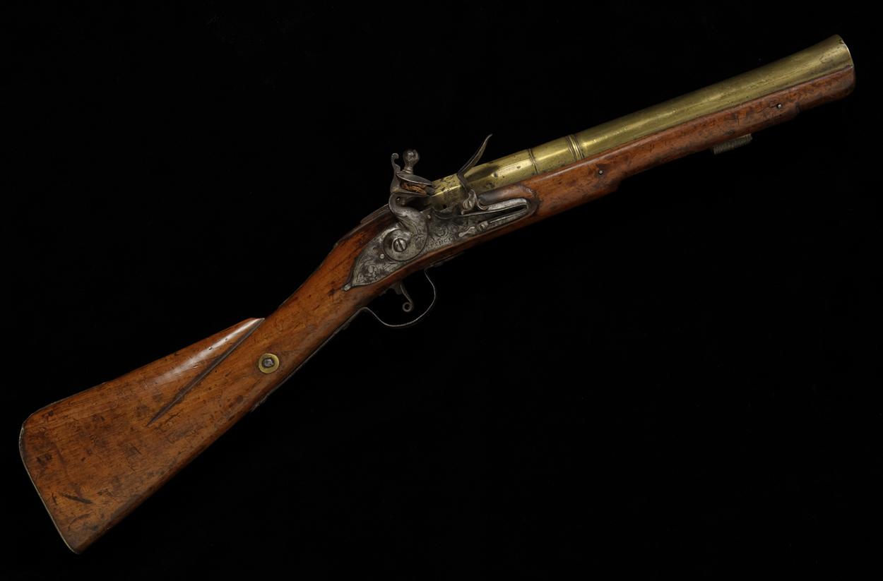

This is a blunderbuss in the collections at the Pitt Rivers Museum, Oxford.
Seems in terms of shape and proportion to be similar to yours and with a brass barrel. As you can see it's a flintlock as I presume yours was - the lock plate looks like it once housed an external mainspring.

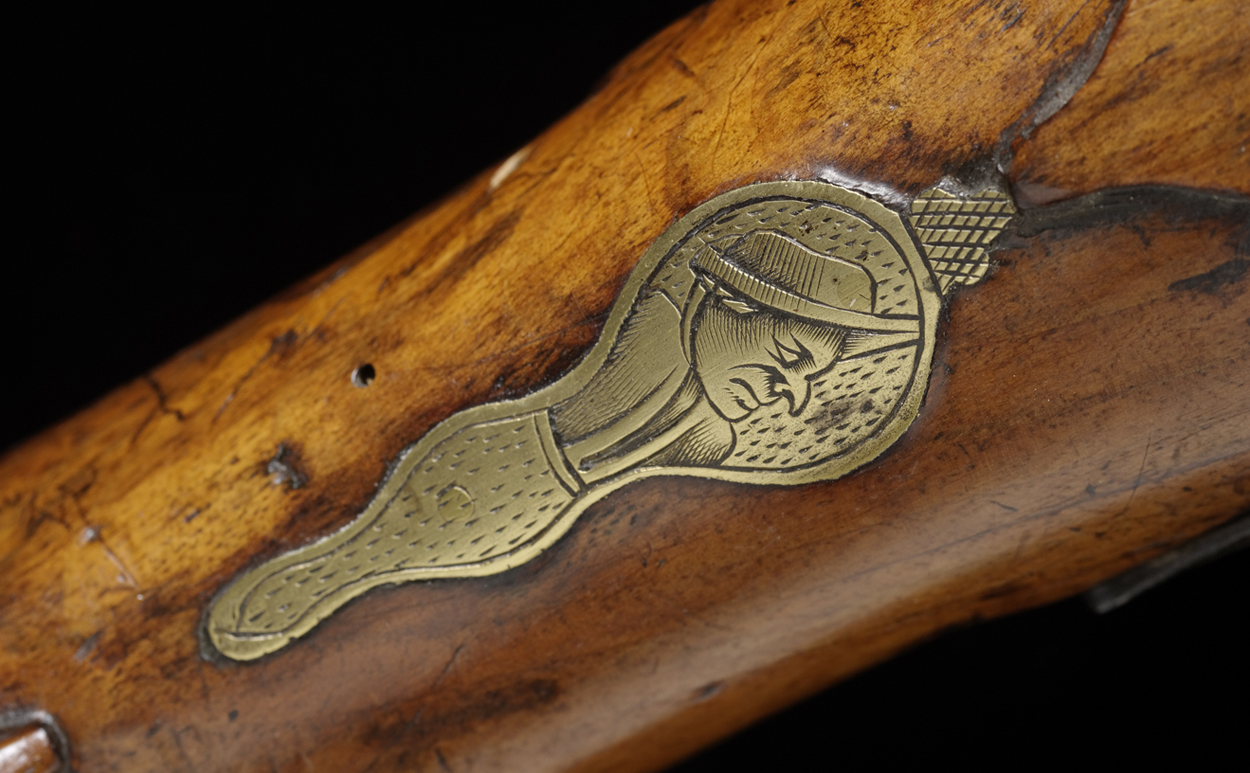

Finally, there is an engraving of a hook-nosed gentleman on the escutcheon plate. I thought at first might have been Mr Spencer but apparently this caricature (and other versions of it) were common on civilian guns of the period.
