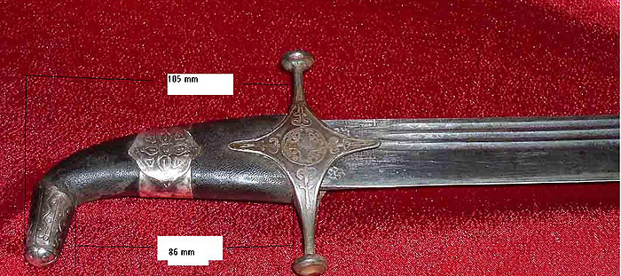

Attached is a crosslike floral design from a georgian sabre - also quite similar to tatar sabres ?

Kirill,
Excellent!!! What a beauty!
Yes thats pretty much the same type 'cross' effect I was referring to. It is interesting to see how widespread was the Persian influence on so many cultural spheres' weapons. While discussing the connection between Mughal India and Arabia with the commerce in weapons, it is important to note that there were profound trade connections between India and trade centers in the Caucusus as well, via Central Asia.
Thanks very much for posting this.
All the best,

Kirill,
Is it really old or a modern manufacture?
If the former, I am acutely jealous....
