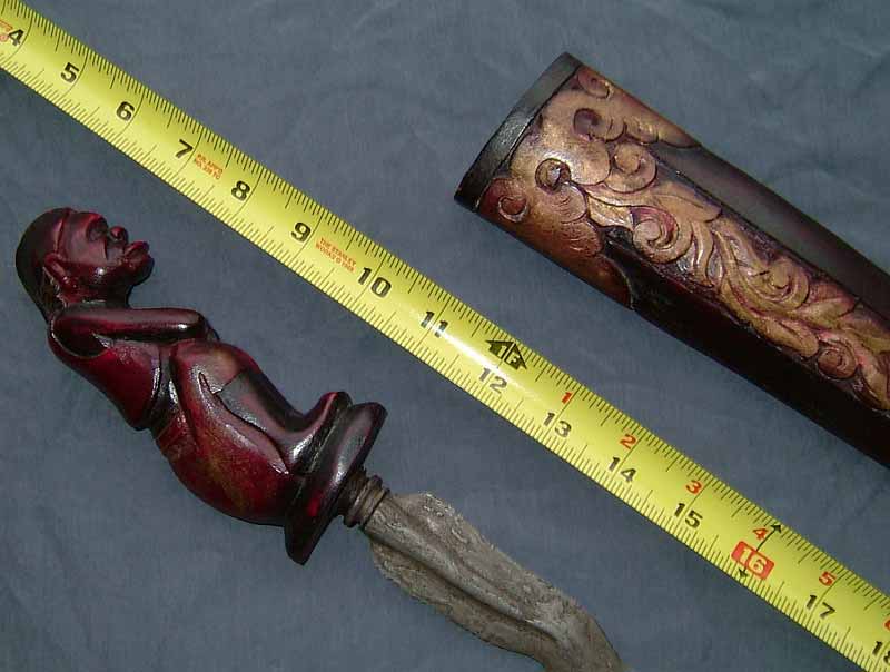

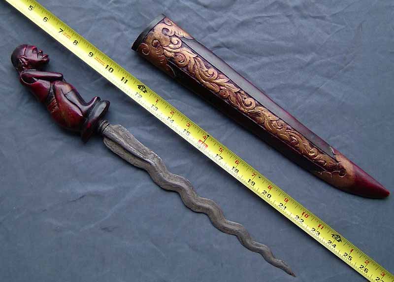

[IMG]http://[/IMG] I got this at a charity market because it was only a few pounds.The spear type blade looks older than the rest of it,which are not new.The scabbard is dressed in a slice of horn ? glued and pinned with a wooden peg .Might it be a so called {lading terus}?Any comments Please.Tim

Tim,
It is a bit hard to say but my first opininion is not to call it tourist work. It is a tombak and sometimes they are mounted in a keris dress. I've seen one lately and the scabbard was made to fit the tombak. I suppose in your case it is the same. The ukiran is made in a figure and seems to fit well.
Some close ups from the scabbard and the way the tombak fits in it can tell more. My first opinion is a nice tombak in a keris dress specially made for this tombak.
The horn, is it turtle?

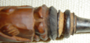

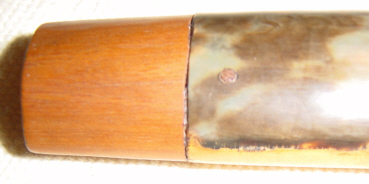

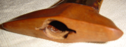

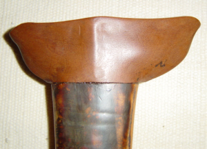

Well I say, I only bought this because the money was going to charity.I do not know if it is horn or shell or where it may come from.Here are some more pics.I do believe in father christmass after all.Many thanks to you all Tim

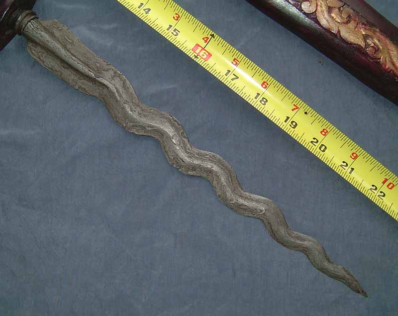

Talking This Probably Is ... Tourist
An early purchase that Paul must surely remember .
The blade needs staining to say the least .
The blade may be old .

Tim,
Vandoo made a good adding.
Thanks for posting some more pictures. This scabbard was made for the blade. I think it is turtleshell and for a tourist piece they wouldn't give much effort to make such a piece.
Take a look at Rick's one, that's something different.
BluErf however makes a point. A tombak mounted as a dagger has a completely other look. But the tombak I've seen lately mounted in keris dress was a very old one. A real antique dress with the scabbard mouth made in the same way like yours.
So like Vandoo mentioned with a spear I'm a countryboy. Mounted like a dagger is less, so give it a keris dress.

To spell it out is very difficult. I suppose you mean to spell out the differences between your piece and Rick's one.
The blade of Rick's tombak might be an old one as well. But when you look to the dress you can see what BluErf said. It is done roughly. Look at that grip. It is carved in a hurry. It is not smooth and delicate like we use to see on oriental art. The scabbard too. The painting is too gold. and it is done very careless. Did you ever see a polychrome painted keris or golok, and I mean a real one? Then you would say I see what you mean. If you take a look at the pictures on the forum and compare them you will probably get an idea what we mean with tourist stuff and a good piece. But the best way to find out is, and it is said so many times, so it is not new, to hold pieces in your hand. If you really want to find out you should come to the "Pasar Malam Besar" in Den Haag, for the English The Hague, in june I believe. An excellent place to see differences. Real old antique pieces and the tourist stuff in one large oriental market. This Pasar Malam takes a whole week.
