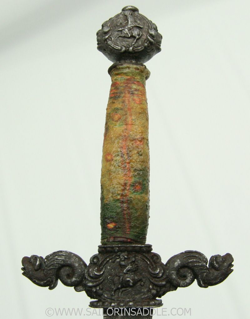

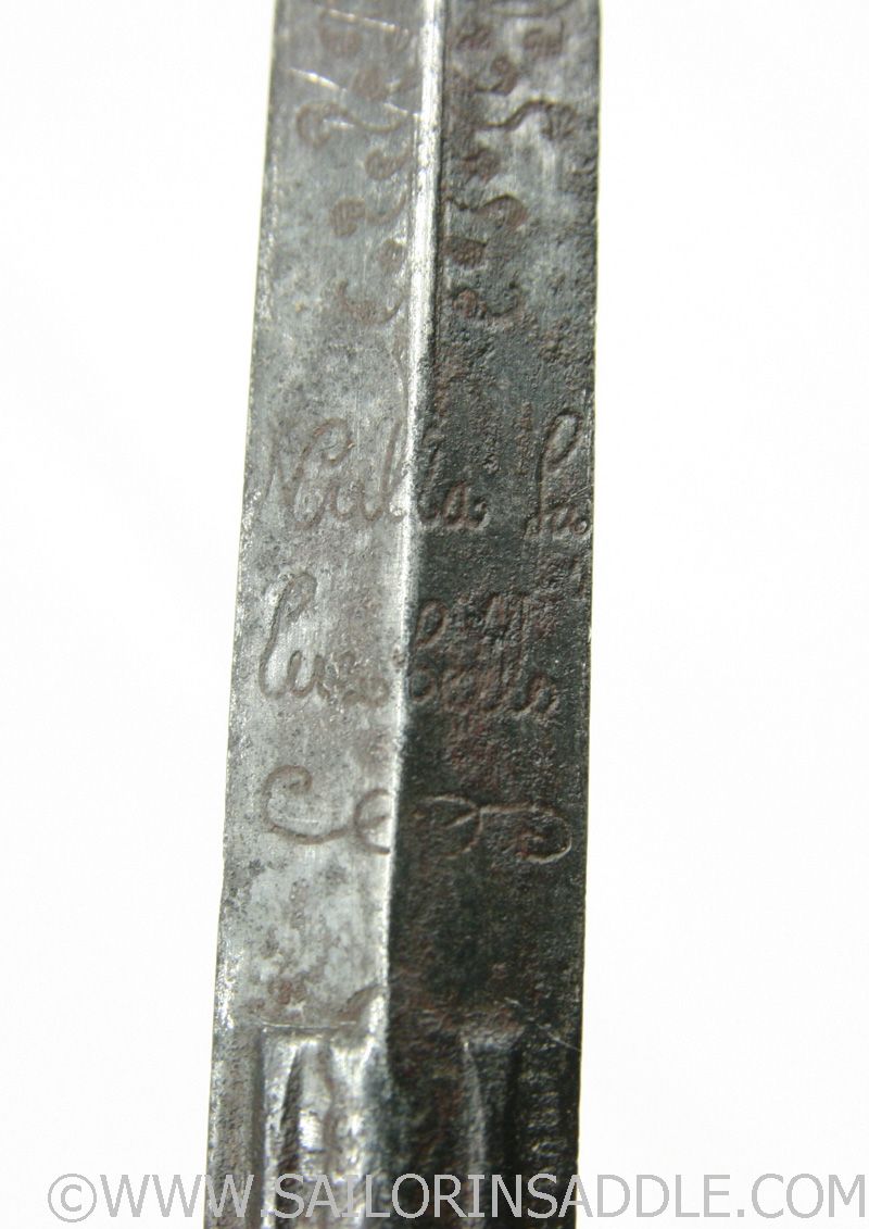

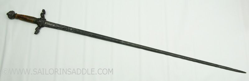

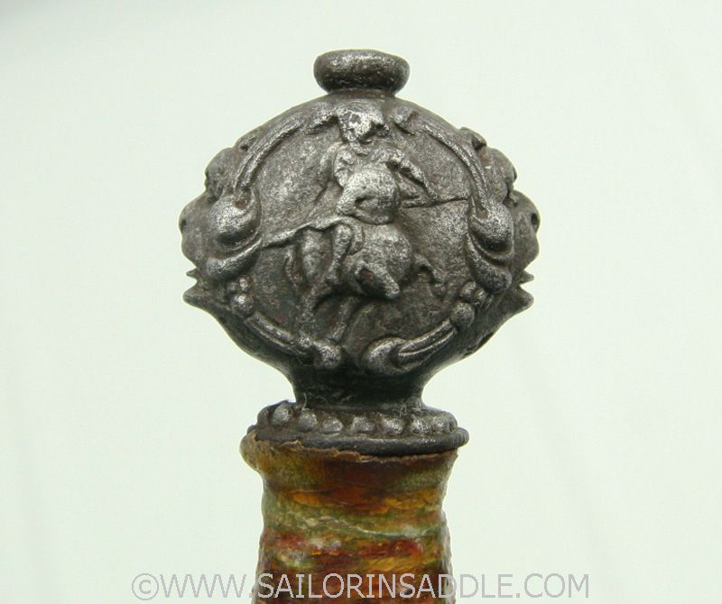

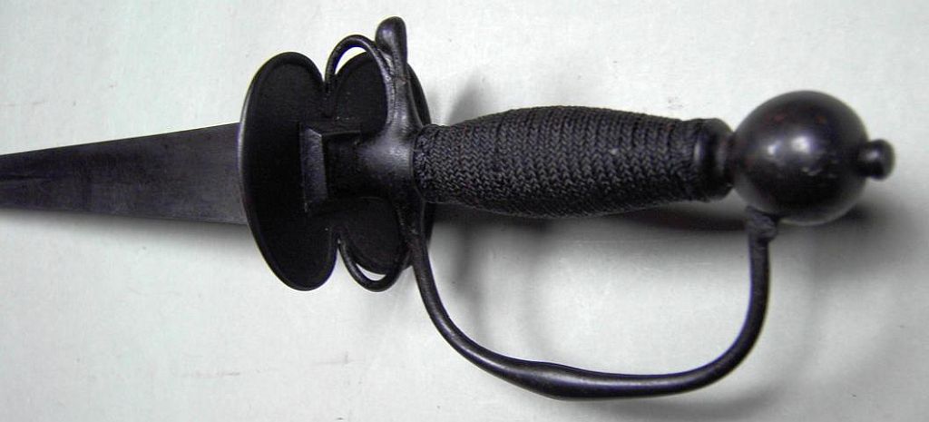

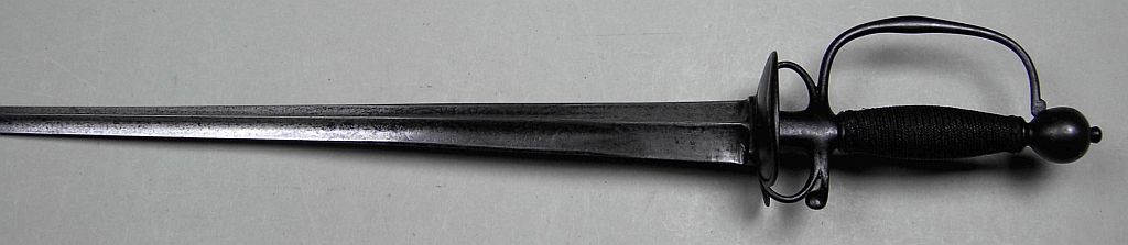

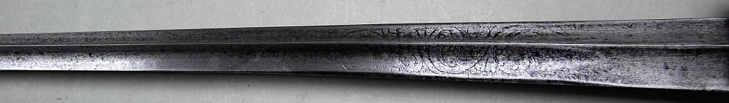

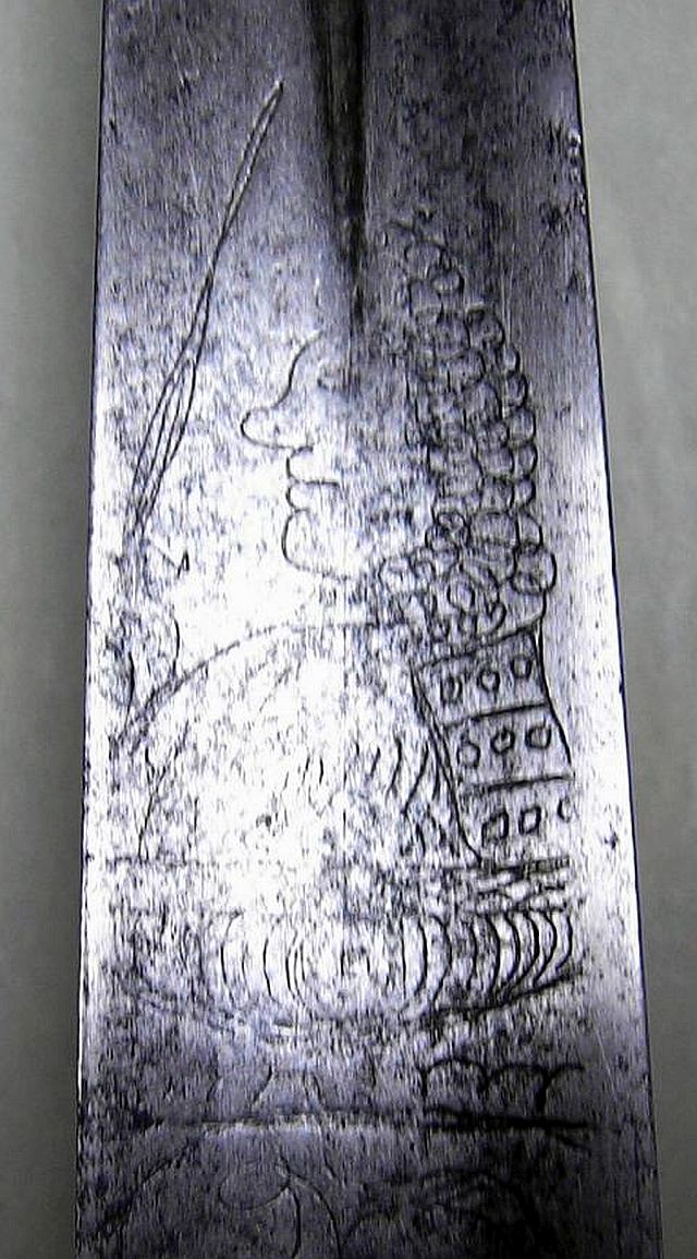

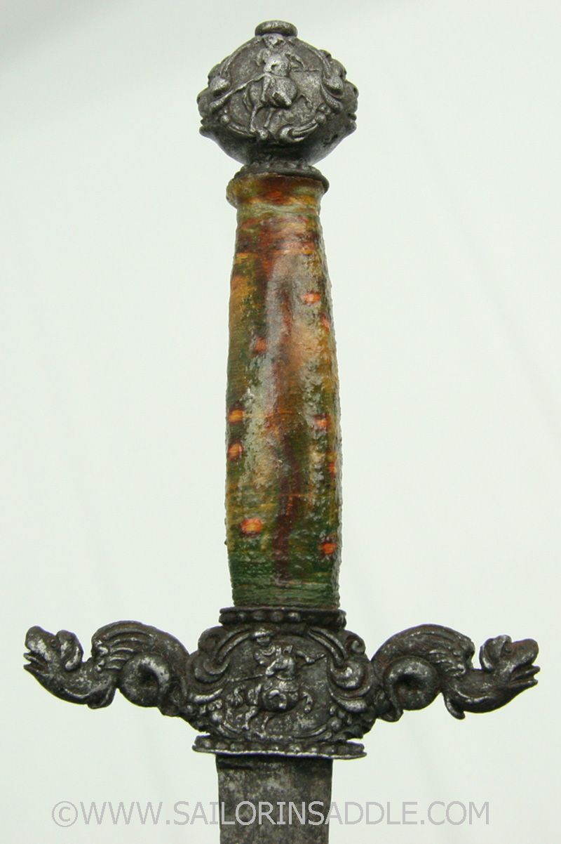

Here's a sword from my collection, ca.1660, that would be called a pillow sword by some, or a town sword my yours truly.
Sword is feather-weight. Even in this condition one can see that the quality of the cast and hand-chased steel hilt is quite good. Blade is inscribed on both sides, one side worn more than the other. It reads something like NULLA LA ...BELLO. Blade is 69.5 cm.
Any help with reading the inscription would be greatly appreciated, of course.

BTW, very nice town sword! I especially love the crossguard, with its Dutch designs...

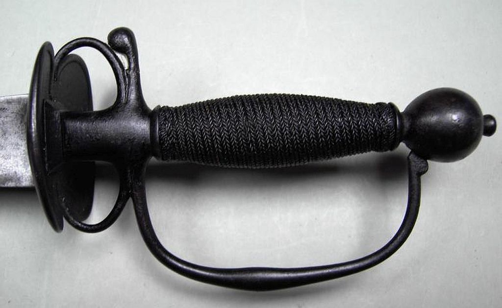

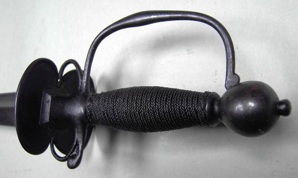

This is what a japanned small-sword hilt looks like. It's a French sergeants hanger from the mid-1700s.
No officer or otherwise a person of means would have a sword like this, as Jim writes, the darkened appearance of the hilt was done by other, way more expensive means than the asphaltum-based paint [i.e. japanning] - blueing and russeting.

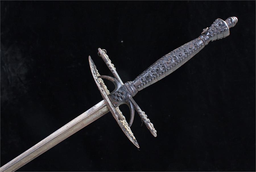

Here are some chiseled steel pommels from around the same time< or just a tad earlier, than the one on my town-sword. Some of them are classified as French.

Mentioned earlier By Jim at #19 George Washington's portrait and wearing a sword... as below.
