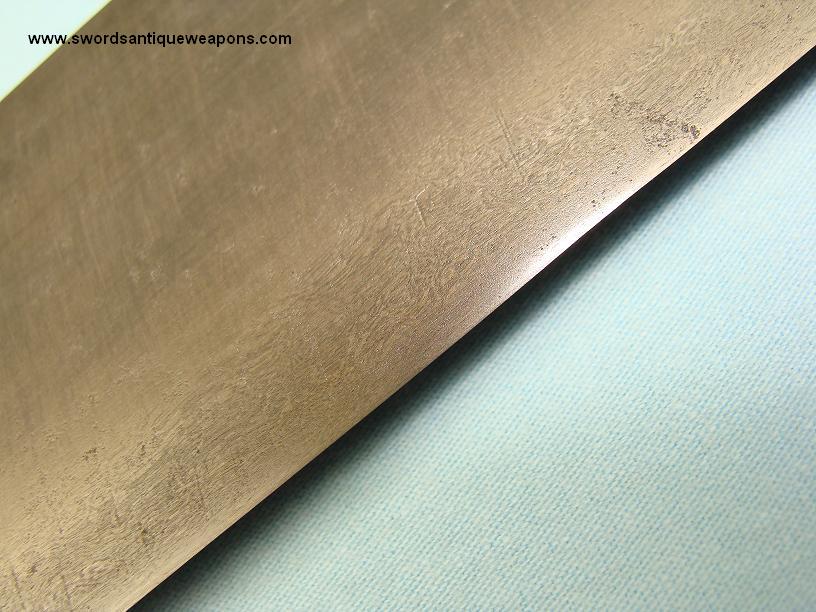

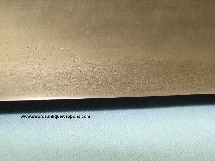

Ariel, Alex is indeed correct, this method works well too, though I fast tracked it a little...I'm not the most patient man. See the results of one Amanremu I have here from the Kelling Hall collection. This is a method I used to show the 'Wootz' or 'Wootz like' Inserted edge.
Fine 0000 grade steel wool is my choice.
