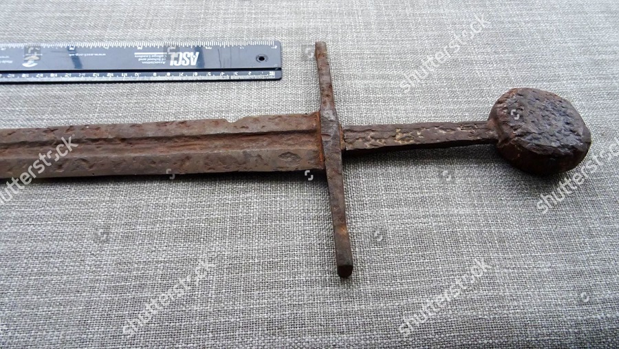

Default Sword 12/13 century or not?
One collector from neighbour country has this sword, i like it very much, it has a great balance in the hand, but it is, or it is not, that is the question, an artefact or piece of trash, if someone could help.

Posts: 314
It looks OK to me but but but fakers are fakers because they fake.
Any idea as to provenance?

Posts: 1,266
I'm not an expert on edged weapons, but the piece just looks too good for me! An iron object that is said to be 700 or 800 years old will certainly look different in terms of surface structure. My opinion.

Posts: 303
Too many fakers out there to risk it I'm afraid.
This one has a couple of red flags to me, not least that the corrosion looks too consistent and 'fresh'.
I would give it a wide bearth personally.
Provenance, curent owner got it after old owner died, he got it fromriver near their town it was in a mud in the river.
As he stated.

Posts: 248
It handles wery well in the hand, i was 50/50 on its originality, so i didnt take it.
But will examine it further on xrf and then i will compare with similar specimen allso localy found that is in museum.

Posts: 467
The uniformity of corrosion, and the apparent lack of actual use, push me to suspect its bona fides.
On the other hand, if it is offered at a reasonable price, a handsome, well-balanced fake has its own interest.
I don't know if analysis of the metal would be informative, but I suspect that it would tell the tale.

Posts: 431
We have two problems here, one is we tend to assume it's fake and secondly using digital photos online cannot tell us everything one needs to make a good assessment. Corrosion levels are dependent on a number of factors and we don't know this either. Expert research may be required.

Posts: 447
This sword is a fake there is absolutely no doubth about it, some may need further hands on research but not this one.
XRF examination can show the composition of the alloys used in steel but nothing more, it can not show you if its original or not, it shows the composition of the steel.

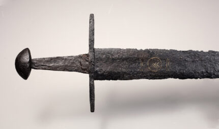

First photo of a 13th century sword found in 1980s in a cave in Beckbury, Shropshire U.K. and authenticated through expert sources.
second, of the Linschoten sword in Netherlands from 1050-1150 and indeed found in a river bed.
It seems to me that the metals and impurities that existed in those days would be notably different than modern processing would produce and harmonize, and the chemical reactions that would occur based on the physical contexts in which the item was found would present dramatic inconsistencies especially over hundreds, nearly a thousand years.

By the story of current owner of this sword, it was excavated from mud from river of near town, i saw several swords excavated from that same river that are in a museum, and they are in excellent condition, so it wont be such problem to analyse and compare with those swords.
There are few red flags to me, ne damages, even surface, those two can be explained, but to me bigest is handle or better to say hilt pattina, it should be diferent and wood and lether should be partialy preserved in that perfect conditions, or shoud leave a trace, but it is all uniform pattina, who knows, analyse will tell.
One needs to be patient and listen to himselfe, his feeling, and offcourse check and analyse things, and be aware of "all knowing experts" that sell you their offcourse "original" swords....
serdar is offline   Reply With Quote

Regarding those two swords posted by jim, i saw several like those that look worn out, old, perfect, genuine, in one european auction house, deemed fakes in origin from Hungary, they refuse to put them in an auction.
Sometime perfect condition antique are real, another time worn expected condition antiqe isnt, who would know.
