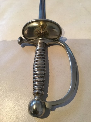

This is a most unusual example of officers sword which indeed does appear to be likely of French origin, but hard to define without comprehensive references on the swords of the Napoleonic period. The inscription does suggest the sort of inscription often occurring on Mexican swords of the 19th century in this case with what appears commemorative date 1720.
Mexican officers from the time of Santa Anna, were highly influenced by French military and Santa Anna himself was a great admirer of Napoleon. The spectrum of Mexican swords recorded in references is less than comprehensive as well. Without comparative examples on this, I would suggest it may well be to a Mexican officer of mid 19th c. possibly earlier.
The quillon arrangement in the guard here illustrates the influence on locally made Mexican swords of the Revolution of 1810 and later, with multi branch guards, often four rather than the three of regular cavalry hilts.

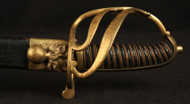

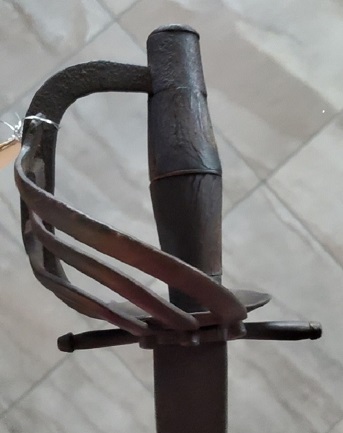

The illustrations are a French artillery officers sword c.1800 with flaming bomb on guard. The more elaborate neoclassic hilt on the example posted here is with the kind of baroque neo classic decoration much favored by the French , on this multibranch guard.
The obviously crudely made Mexican example shown is c.1810-20s reflects the influence of these more elaborate French hilts.
The blade on the posted example resembles blades of French cuirassiers forms of Napoleonic period, but would have French markings.
There were sword makers in Mexico, Oaxaca, who produced swords well through the 19th c.
I have never seen the flaming bomb used in Mexican sword designs but may well derive from the strong French influence. Understandable reference to the Springfield arsenal who used this device during WWI on the M1913 Patton sword as well as other 'ordnance' materials.

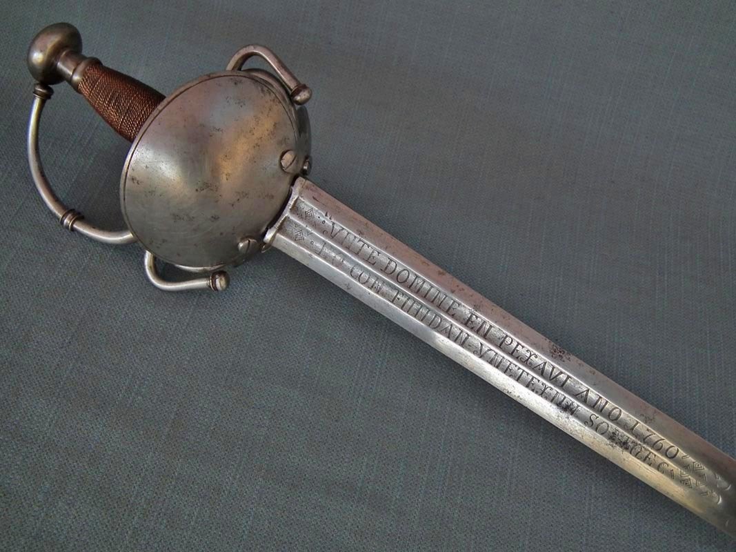

A further note on this blade, the deeply channeled double fuller on the model ANXI cuirassiers sword of First Empire used 1804-1816 ran the full blade length.
It does seen quite possible this might, as suggested, be a German version and perhaps during the Confederation of the Rhine 1806-1813 when Solingen was impacted by French control under Napoleon. He was having ANXI swords produced in Milan as well so I wonder if this might be a possibility when he took over North Italy in 1805 until he annexed to Austro-Hungary in 1814?
While I am no linguist, the phrase on the blade though Latin in the manner of the familiar 'Spanish motto' seems to have an Italian ring to it, 'ME SENAL ES EL CAVISCO= my sign is the 'cavisco' (what does cavisco mean?).
DEL VOY=of I go? ENALEMANIA SOLICE ANO 1720= refuge in Germany in 1720?

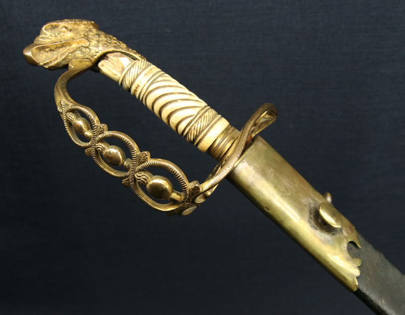

Mounted, or infantry grenadier? The theme comes up a lot in the lowlands, UK and Iberia. The grip and basket a bit Spanish in my mind.
Here is a neat hanger and an American eagle in British guise, with a knuckle bow. Dmitry had one.

Thanks Glen, that makes sense. Through the 'laws of diffusion', since the French were Bourbons, as was the royal house in Spain it seems plausible to have been present on some weapons' motif.
With Great Britain and the Holland, there were of course strong ties as well, and often weapon forms and motif became transcendent.

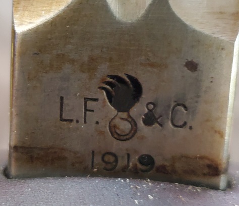

The grenade is a simbol for the French Gendarmerie too.

I finally received the copy of "Treasures of the Caribbean" by Rodney Hilton Brown (2023) and it is an intriguing compendium of various stories and circumstances in Caribbean history often with cited references .Unfortunately this entry showing what appears to be the same pattern in hilt and blade, does not cite such reference, (p.279).
The blade with same fullering carries the Spanish motto, suggesting the swords were apparently inscribed independently.
While the date/period indicates c. 1720, this is incorrect as this is a Napoleonic period sword.

I did find that the flaming grenade device was indeed notably present on various hilt form, typically amidst hilt guard assemblies in cartouche, some singular on stirrup hilt sabers, of grenadiers and gendarmerie, as noted.
However I found no cases of these grenades used at root of arms of multi branch hilts as seen here. The style of the branch system suggest in my opinion that this is most likely a limited issue of Spanish officers sword c.1800-20, and of course clearly influenced by French forms. As yet, no match in references on Spanish or Mexican sword form references.

A blade with SOLIGE written on the channel, and the (fake) Toledo mark on the ricasso.
Check post#8 in this thread:
http://www.vikingsword.com/vb/showth...oledo+Solingen

Great entry!!! reminds me how long we've been on these topics on Spanish swords here! Over two decades now!
Well noted, the dual fullers clearly a Solingen offering in 18th c. and with that keeping in mind the numbers of Solingen smiths who went to Klingenthal in France.
