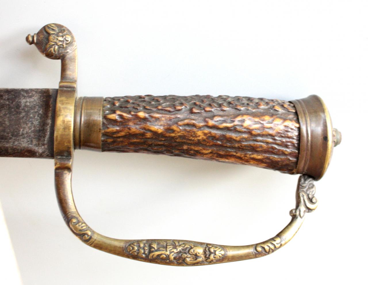

Yep! I went and did it again! Can't get enough hangers, I guess.
This amazing piece comes from the Lanes Armoury. It's a late 17th century hunting hanger with brass fittings, stag hilt, pierced guard with foliage, German made 21" curved blade with false edge and faint stamp which I suspect is the 'knight's head' for the Wundes family of smiths.
The truly amazing thing about this sword is that it has King William III (with crown) and Queen Mary cameos cast into the beautiful brass pierced guard. The two were married in the 1680's, Mary died just prior to 1700 and Charles followed in 1704. Thus, I would place this sword in those two decades.
William was the Prince of Orange (in the Netherlands) before marrying the English king's daughter, Mary Stuart. The Dutch were an embattled nation, fighting off the English in trade, with France advancing on their border, the Spanish attacking their navy and even the German Republics harassing them. Admiral de Royter, acting under William, did an amazing job with strengthening the Dutch navy and even took on the Brits at sea (and won!). When it became apparent that England was not going to stop their tactics, William invaded the UK, sending Charles fleeing the country. In the peace talks, William was offered the crown and became ruler of Great Britain, Scotland, Ireland and Wales with his queen at his side. They had a popular rule and apparently many things bore their image (but I have yet to see a sword with them prior to this example!)
This early hanger was used by the affluent gentry for status and in hunting, but they were immensely popular with naval officers for their durability (brass doesn't rust in salty air) and short length (to prevent getting caught in the rigging when swinging). In Annis' Naval Swords, you will see two famous portraits of naval officers of the era wearing the exact type of hanger (Admiral Benbow and Admiral Shovell). Other examples can be seen in Gilkerson (Boarders Away) and Neumann (Swords and Blades of the American Revolution).

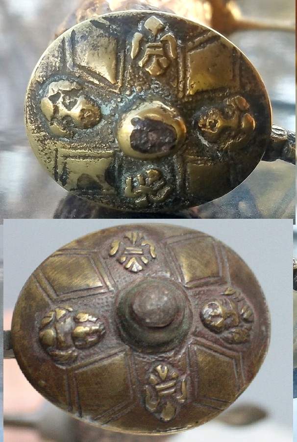

A close-up of the cameos- Note the pommel cap has very interesting cherubs and odd symbols. These are classic for this period and I'm told were used by the German smiths for mystical purposes (have to do some research there. Something about the river they quenched the blade in being holy?)
Those "odd symbols" on the pommel cap look very much like fleur-de-lis, no?

David I just noticed your post and we crossed posts......those are indeed fluer de lis, which appear surprisingly frequently in English motif of these times and even in blade markings in the 18th c. .

The fluer de lis really does throw people off as it is typically regarded as strictly French. Actually the three fluer de lis existed in the Royal arms of England until 1801. ….and as such did represent France in the heraldic circumstances that go back to Edward III.
It seems to have a lot broader connotations of course. Regarding the fluer de lis you mentioned as a makers mark in England, I dont think it was a makers mark but possibly a quality type mark. I believe there was a street named flier de lis street somewhere in England where blades were sold in bundles to 'sword slippers' but cannot recall more, but it was about mid 18th c. It might have been in Aylward or one of the references amidst the Shotley Bridge research.

Some things I notice about the heads on this sword which may or may not have significance;-
William and Mary were made joint monarchs, but only one head is crowned.
The crowned head is on the inside of the guard when I would have assumed, being presumably the more important, it would be on the outside.
The head on the inside of the guard appears to be the wrong way round i.e. with the crown towards the grip. Certainly both heads are not the same orientation.

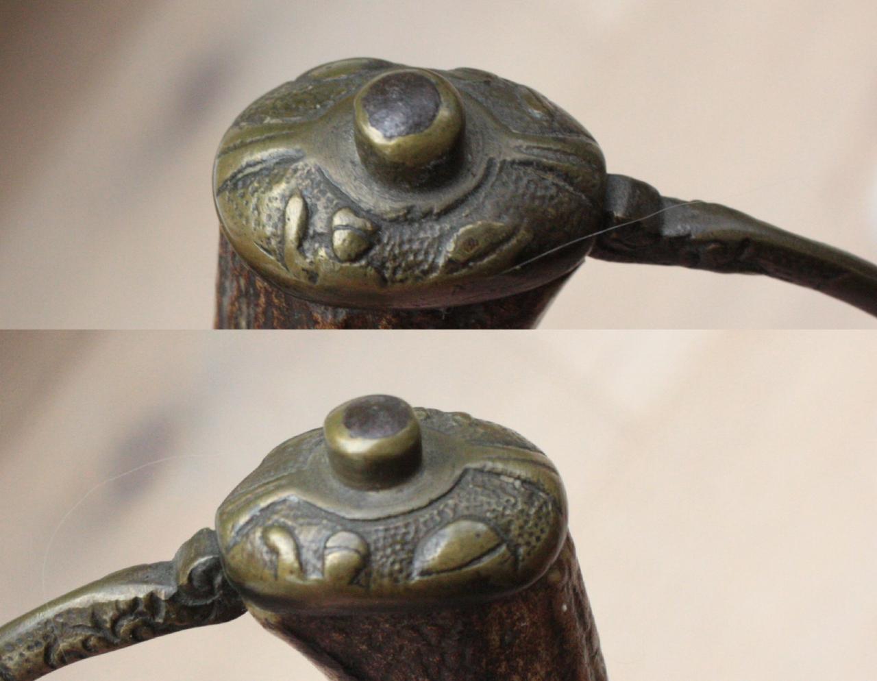

Revisiting this old thread with one possibility for the 'missing crown'. Just to add clarity to anyone coming in now on this thread, this hanger is 100% made for the English market and dates to 1690-1710 period based on style, construction and the historical record. During this time period, there were many articles made with the cameos of King William and Queen Mary. Items in the colonial Williamsburg museum collection reflect this, as does the sword I mentioned retrieved from the QAR shipwreck. I have seen references of swords with these likenesses, but unfortunately never seen actual pictures of them.
So...if these depictions truly are of William and Mary, why doesn't the profile of Mary bare a crown? One more possibility I came up with and seems to make sense is that Mary died in 1694. William continued to reign until his own death in 1702. I think it is therefore possible that this sword guard could have been cast after Mary's death, showing the living ruler's face in profile wearing the crown of England.

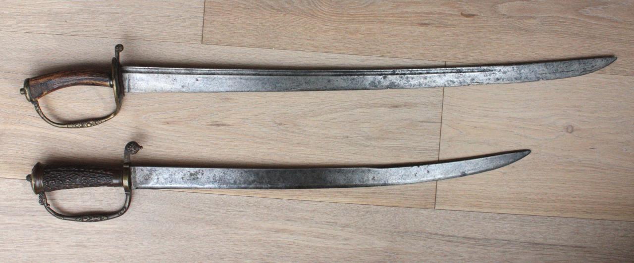

Mine has only a knuckle bow. Very similar to the sword in the op.
Ed is offline   Reply With Quote
Old 6th November 2025, 02:53 PM   #25
Ed
Ed's Avatar
Posts: 315

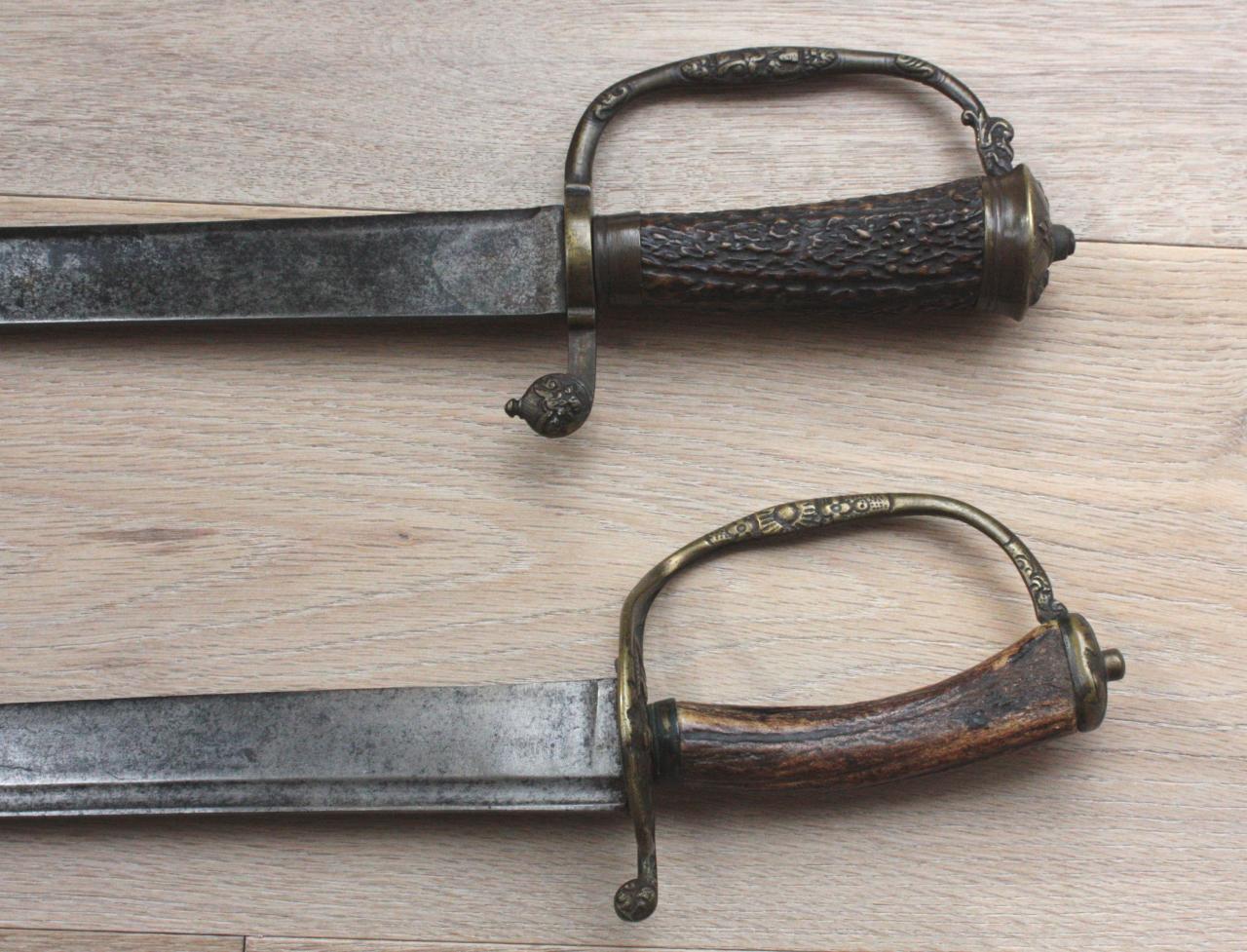

Rather than start a new thread I'll continue on with this one so the info is in the same place.
I have not examined my hangers in some time. I had thought that they were German hunting swords. The shorter one 17th c. the longer one a bit later.
Shorter on is 20", longer one 25".

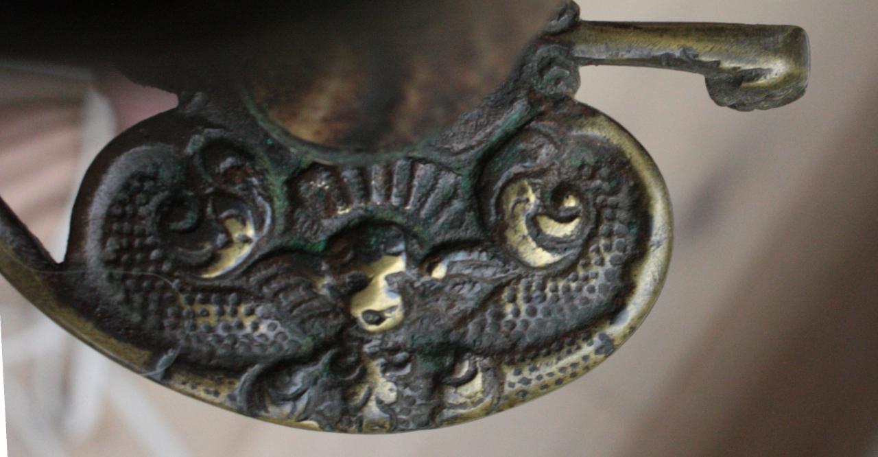

Longer one has a worn cherub on the guard.

Wow, Ed! You have a couple of very nice hangers. Both of these examples date to the 1690-1720 era. Although these hangers were made in Germany (as were most swords and certainly sword blades dating from this period), these types were popular with the English military forces. As such, they could have seen usage by esteemed gentlemen during a hunt to finish off game, by foot soldiers who by necessity needed shorter and lighter pieces in the field and very often navy men, pirates, privateers and merchant class sailors. The reason for their popularity in the maritime setting was that they were short enough not to get hung up in the various ropes, spars, sails, gunwales. etc, in a battle. Likewise, their (often) brass hilt components were resistant to rusting from the moisture and salty air. You can see many great examples from maritime pics of the day, specifically Captain Benbow and Christopher Myngs. Great pieces!
