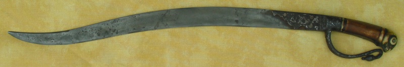

My interest in Kopesh/Kopis-like blades got me this nice sword for which I yet have to find a name or any other details on its history - any suggestions/observations most welcome!
Old 16th July 2005, 10:35 PM   #2
Post

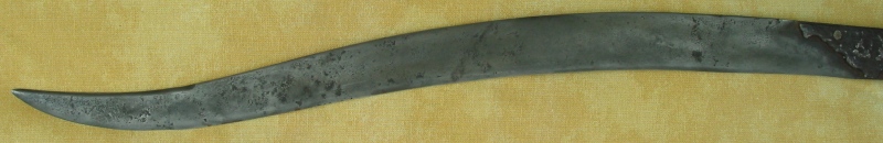

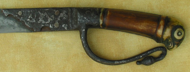

Total length is 62.7 cm with 50.4 cm of Wootz/Bulat blade (that's almost 25" and 20") and a cast(?) metal hilt (21.2 cm or 8.3" including the reinforcements) with little silver Koftgari left. The grip scales are bone and have been painted (brownish body with traces of olive/green remaining on the head of the parrot).
The blade has a ricasso (4.6 cm/1.81") and a sharpened false edge (10.0 cm/4"). It has an hardly noticeable, forged central "fuller area" almost along the whole length (i.e. blade slightly thicker along the spine as well as towards the sharpened edges than along the center). Maximum thickness is 3.9 mm (2.5/16") with 3.4 mm (2.1/16") remaining at the base of the false edge. Blade height is 23.2 mm (0.91") at the base, flaring out to 30.9 mm (1.22") around the middle of the blade, and still 26.9 mm (1.06") high at the base of the false edge.
Although it may have originated somewhere else, it was obtained from the Hyderabad region, a hotbed of So(us)sun Patta(h)s. However, the blade of this sword is about 1/3rd shorter than a regular blade of those larger cousins and just about everything else doesn't fit either...
I don't have much experience with Indian arms and would appreciate any pointers or references!
It was said to be late 18th century but please put forth your own estimates...

Do you know if the blade has a tang?
True what you write that the blade has a bit Kopis/Soussan Patta/Yatagan to it. The blade seems to be rather short, do you think it can have been broken close to the hilt?
You write that you got it from the Hyderabad region. Do you mean Hyderabad in Sind or in Deccan?
Somewhere in one of my books I think I have a picture of a blade like yours, I will have to have a look. The bird on the hilt could be a parrot, but it could also be a hawk or a falcon, it is hard to say, but it is true that they often used a parrot.

Hi Jens, Thanks for your input!
No idea. The blade is tightly secured by those 3 rivets. However, I played with the idea to clean up the hilt by electrolytic rust removal and would have to remove the blade for this.
Wouldn't the ricasso suggest an intact blade? IMVHO it would need some major reforging effort to come up with a new ricasso as well as the shape of the blade...
Possibly a boy's blade? I know it's the usual disingenous ad hoc assumption but the grip is also a bit on the small side.
Deccan
I would appreciate that very much! Take your time though.
I just defaulted on a parrot since that seems to be mentioned much more often than other birds. I'll have a close look again.

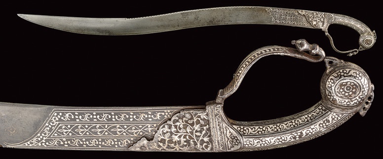

Salams Kai... My apologies since I should have mentioned to you about requesting joining your thread to that of Ariels at http://www.vikingsword.com/vb/showthread.php?t=21429 ...
Please note that I have requested along with Ariel that these two threads be fused since they are about the same family of swords which appears to be a kind of Indian weapon, hybrid or mixture, not fully researched ...and which together as one thread would make an excellent subject...

Hello Ariel,
Thanks a lot for pointing out the companion thread and the possible or even probable relationship based on this rare hilt type!
The hilt construction of the 2 Indian swords with sigmoid wootz blades discussed in this thread seems to be pretty typical for southern India with an integral langet/tunkou used to attach the wootz blade to the hilt. Quite distinct from the full tang construction used in the 3 examples from the other thread. This might merely be due to constraints/function (with wootz blades being size-limited based on ingots) or possibly quality/status (the 2 pieces discussed here seem to be status pieces with elaborate decoration and parrot head pommel while 2 out of 3 in the other thread appear to be of more mundane origin).
While quite a few other blades were shown here in an attempt to establish a relationship, I believe this is a distinct type of sword and I'm not convinced that merging both threads will really help discussion since responses will get mixed up even more.

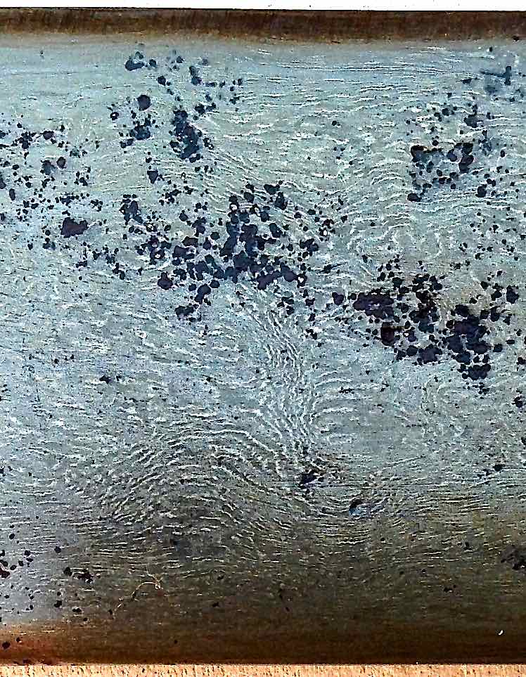

Here's a close-up showing the wootz blade of the sword starting this thread. Am I correct to see some surface manipulation during forging of the ingot to achieve a (possibly ladder-like) pattern?
