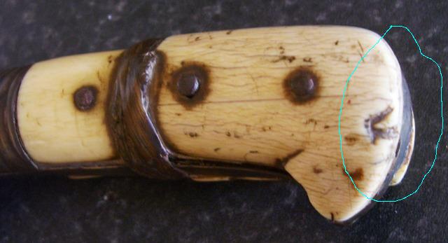

An old, just acquired knife. Usual 'T' spine with a nice downward curved blade , 10.5" long (following curve). A nice chunky handle showing a lovely used patina, handle has a very old repair, the slabs have acquired a nice polished finish from handling....does not look like bone ...I am almost certain some sort of ivory.....any ideas how I can ID it (its not elephant )
I am always wary of the stories behind weapons, but this is stated as being a Victorian 'bring back' from the North-West Frontier,. I have no problem with the dating ....mid 19th C seems highly likely.
I really like these....comments and info would be great Thank you

I love this family of daggers. I think you should call this one a Pesh-Kabz really. Although it does look like its quite possibly Afghan/N.Indian.
I try and avoid Ivory if I can and so am no expert, does the grain separation indicate its likely to be a Walrus tusk rather than Elephant?
Nice piece though, little clean and lemon?

Not my area, but I like it. Seems like a real old piece that was used in action.
Almost has the look of an old African Congo dagger !

There is a chance to be elephant ivory.
Possibly this piece was cutted horizontial from the elephant tooth so we see the black lines (possibly Retzius lines)across the handle.
It will be very hepful if you can show a close picture from the back side of the handle.

I'm intrigued by the 'waisting' on the handle. What is the central band?
Is the material split between the two sides of the band (in other words 4 pieces of ivory)
Best
Gene

Hi David,
I was thinking the same as Gene, the band round the hilt looks as if it's been there for a long time but not something I've seen before. Do you think it's a 'field repair' or an integral part of the construction. To my mind a nice 'well used' piece.

Hi David,
My Regards,
Norman.
Hi Norman,
yes, I believe a 'field repair', it does improve grip as well. Thanks, I really like weapons that are in the 'well used' category.
Regards David
Best
Gene
Hi Gene,
the banding seems to be sinew, as a best guess, which is now very hard and 'secure'. The strange thing is that originally it looks like it had two slabs one either side. Some how the slabs were damaged / cracked between the 1st rivet and 2nd rivet (both sides) It seems to be a 'in the field' repair, to hold the slabs together, presumably until a better aethestic repair could be done.
I have visions of a Afghani mountain tribesman sat at the campfire, drawing the sinew from the leg of a freshly killed goat. wetting it and wrapping the handle of his recently damaged Pesh, in defiant concentration. Placing it near to the warmth of the crackling flames, so that the drying sinew would tighten and hold the ivory slabs. Contemplating the attack on the British Garrison when the sun rises over the mountainous peaks the following day..... little knowing that the star filled blackness of the night would be his last......
well some thing like that.....
Regards David
