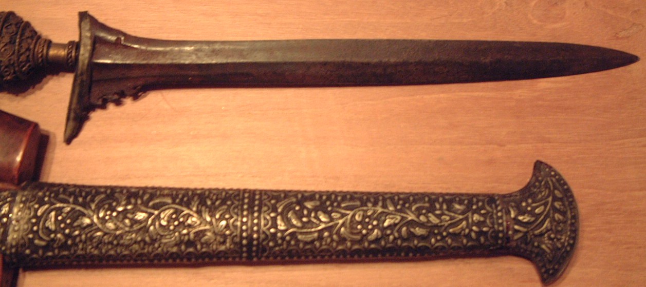

Would like to hear your ideas about the origin of this keris.
The seller thought it was Minangkabau.
Mainly because of the form of the ship I think Northern Sumatra/Gayo.
What do you think and why?
Old 24th December 2008, 12:39 AM   #2
Hello Erik,
I also think this is a Minang Kabau keris - and a nice one at that!

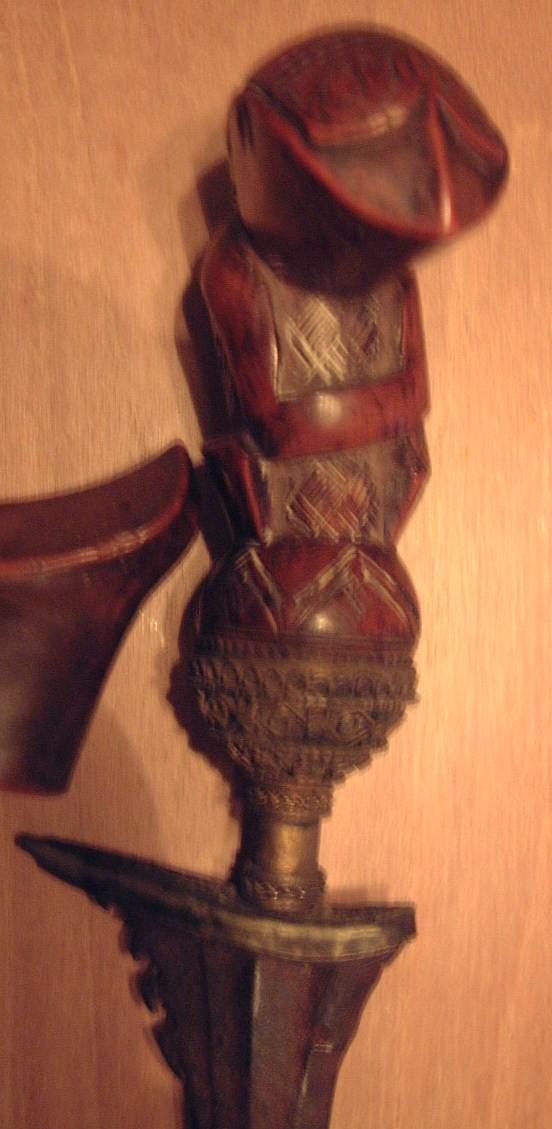

The sampir can be quite variable in Minang scabbards; this seems to be an established style though. The silver work looks typical Minang to me; so does the selut. Could you please post pics of the hilt and the blade? Thanks!

i believe the blade is anak alang type - typical bangkinang

Thanks for these first replies.
Here two more photo's as requested.
Regards, Erik

I also think Minangkabau even if the "selut and mendak" combo is a bit unusual.
Very nice keris by the way.

Gayo would probably have a broader and more simple blade.
And the scabbard would be ending more pointy with hopefully some round fruit shaped silver/suasa decoration ?
