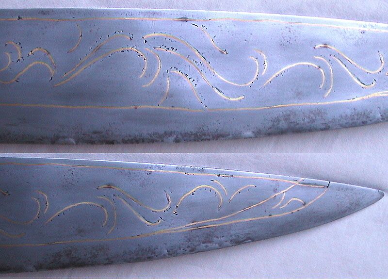

INLAY:
Deep grooves are cut into a harder material (ideally at different angles) and then a softer materal is inserted. For example, on Ian's barong, I had to re-engrave the grooves - cut deeper into the grooves - into the steel. Then I took softer brass wire and hammered it into the grooves. This method of decoration makes the softer metal more permanent and thicker. Often it is then polished down to the level of the harder material. Here is an example of the brass inlay I did on Ian's barong blade:

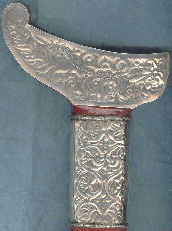

chasing:
Technically, the term "chasing" is named after the process of taking a chasing tool, a straight punch with a straight beveled head in the form of a "v" (point down) and as the artist hammers, the artist moves the tool across the surface in simple straight lines or large archs (there are different ways to do this which I will not get into).
What has also been subsumed under "chasing" is the process of hammering soft metals with punches with difrerent shaped heads. The artist would hammer the punches onto the surface of the sheetmetal. These indentations then would start to form a design. Here is the scabbard to a silver headed Sulu kris I made. It was my first attempt at chasing silver:
