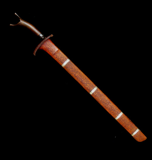

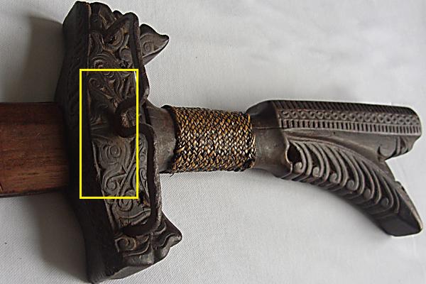

Hi Bill,
Thanks for starting this thread.A nice subject and we will probably never know what happend so we can only guess and try to get as much info as we can.
Its a little dangerous to build a theory on the not proven other theory of the crocodilemouth I think.
Personally I don't think the handle represents always the crocodile mouth but that for later......
If Magellan was killed with a kampilan I doubt if the model was the same as we know know on the Phillipines.
seemly the model of the handle has become some variations during the times.
However we haven't seen kampilans with dayak motifs it at least looks if the dayaks of North Borneo used a kampilan with a small variation into the handle.
they seem to be more like a massive block,ceratainly the lower "jaw"
Pics below are mainly described as Dusun ( north Borneo)

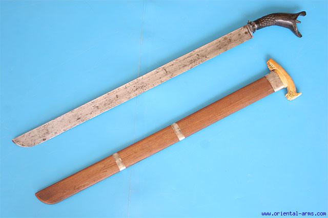

On Timor however you find Kampilans with hughe handles....
In my opinion they have more in common with the head of a hornbill.
Whats for sure is that on Timor they couldn't make swordblades and every blade had to be obtained by trade.
Seemly these kampilans where also traded to Timor.The collection numbers are very old so probably these are very old pieces.
Whats also possible that they carved the handle themselves but I doubt that.
Note that on two pieces the handguard is asymetric.
We don't know if these kampilans where a model before the more common open "crocodile" type or a modification of that type.
I agree with Vandoo that the blade of a kampilan is'nt very handy into the forrest. But on a boat or open area it must be a great weapon.
Note however that the area of North borneo is more open than other parts of Borneo. On the other way it would not suprise me if the kampilan design was originally from the mainland of Malaysia but was modified for combat at sea,traded and got his influence from other cultures.
The hook at the end of the blade is very handy for entering or just keeping of entering boats from enemies.
There's a nice theory if this hook maybe represents a prowshead.
Hi Arjan,
I see what you mean and it looks indeed at a hornbill's head.
Did you noticed that the last pic of your Timor-examples has the hilt upsidedown?
The ,hairy, part of the hilt normally is on the ,edge, side of the blade.
To this one the ,hairy, side is at the backside of the blade (non-edge).

Old 16th May 2010, 09:16 AM   #23
Maurice
Maurice's Avatar
Join Date: Jan 2007
Posts: 1,464
Originally Posted by Bill Marsh
I have never seen a kampilan with Dayak designs.
To me this look like a dayak design (on the crosspiece).
It looks like some kind of face, which is uncommon to moro design..or am I mistaken?
This carving would be great when painted on the top/bottom section of a dayakshield.
(By the way I would be probably the last who is thinking here that the kampilan is from Borneo/Dayak origine, I just want to discuss this design as being dayak... ).
Maurice
Old 16th May 2010, 06:43 PM   #24
Posts: 7,416
I believe that this piece is actually Iranun, who also live and made raids on the Borneo coasts.
Also faces made from okir are not unheard of on Moro pieces.
