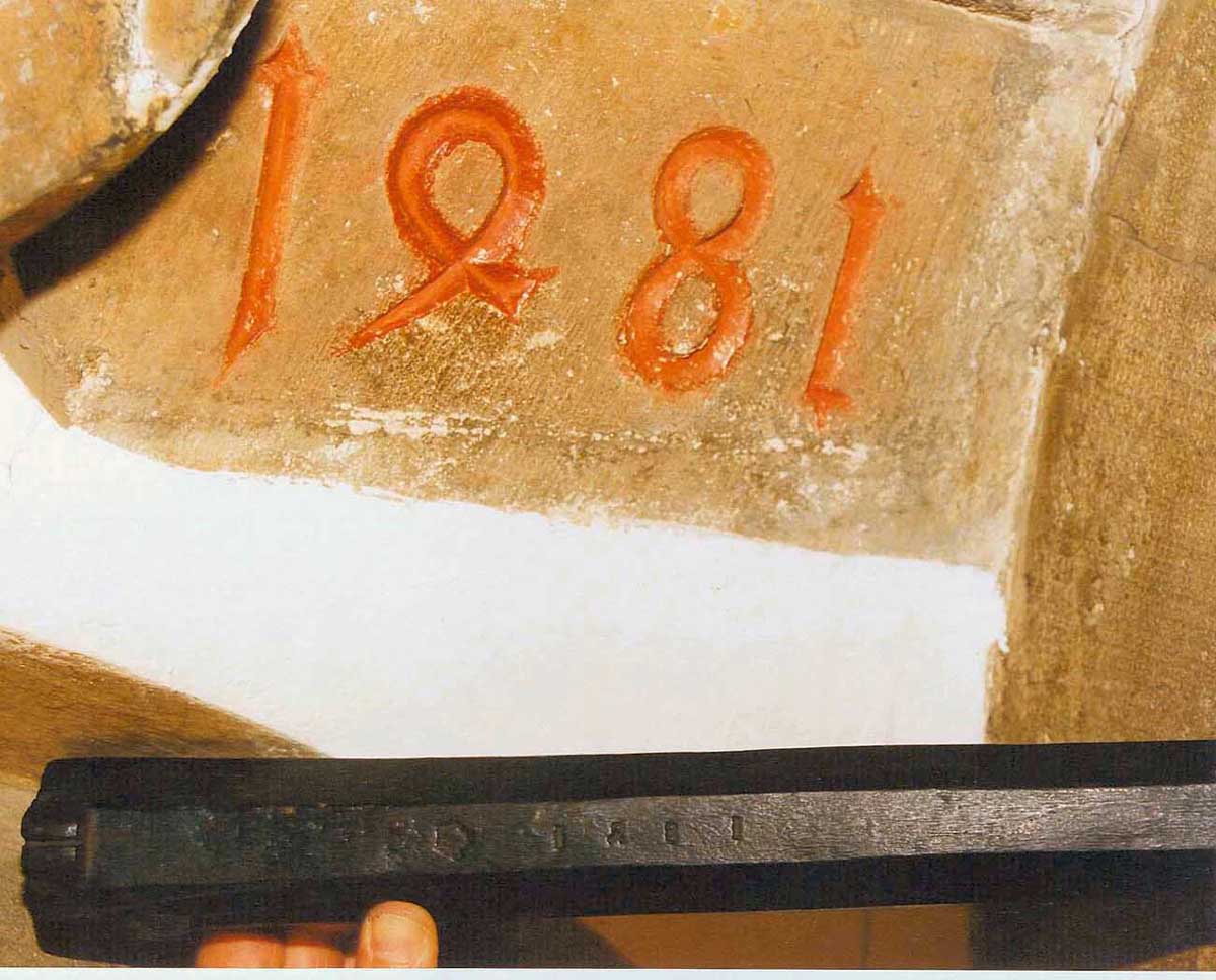

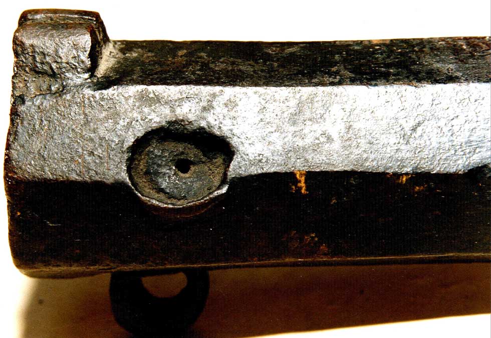

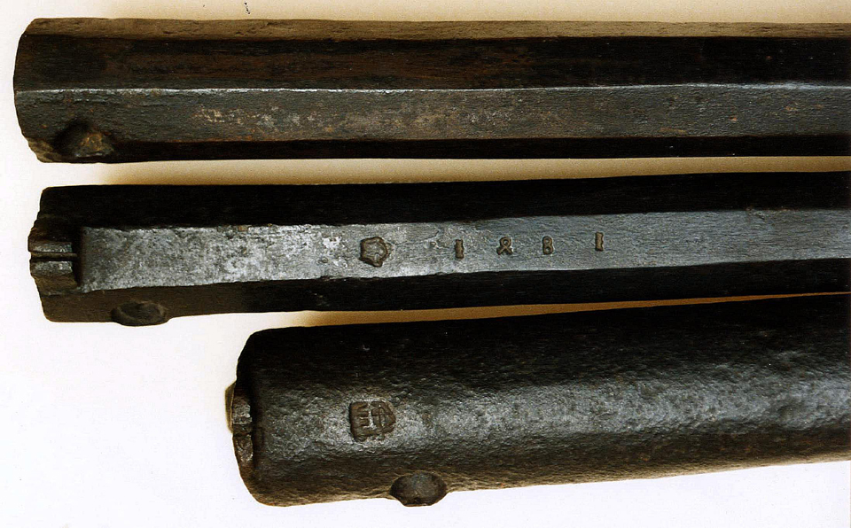

A wrought-iron haquebut barrel struck with the Munich town mark.
You will remember seeing details of it in former postings where I also explained how to correctly read the date 1481, which, in the upmost image, is also seen chiseled in Gothic stone work and contrasted with the identical date on the barrel below.
Just imagine the Gothic numeral 4 being turned clockwise by 90 degrees and you get the contemporary shape.
This is a highly important historical piece in having survived so well preserved for 527 years!
Michael

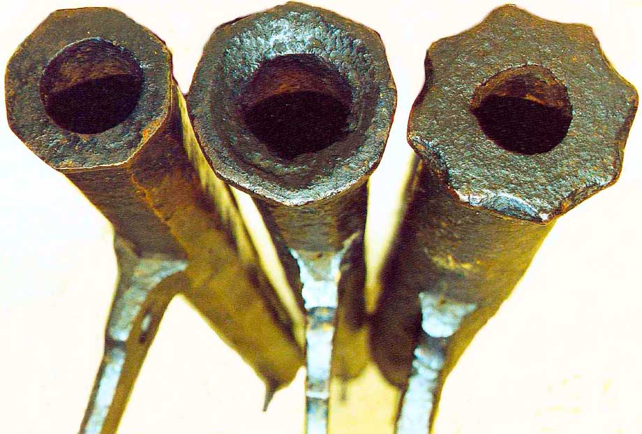

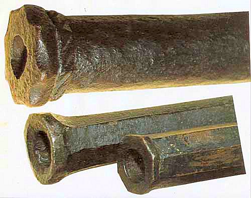

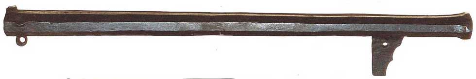

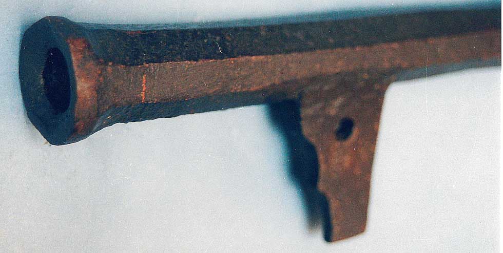

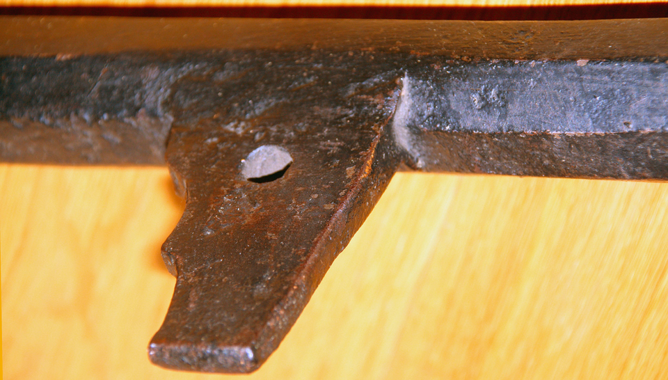

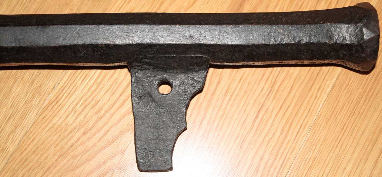

Hi Alexander,
The overall length of the octagonal barrel is 93.8 cm, the caliber at the heavily swamped muzzle is 2.7 cm, and the weight is 5.6 kg.
It is known from the Passau city archives that a number of these haquebuts were ordered in 1481 to be employed in a famous feud between two rivaling candidates for the archbishopship of Passau, Georg Kardinal von Hasler and Friedrich I. Mauerkircher, which took place from 2nd to 29th June 1482. This fact, too, makes this barrel a highly important historical object.
I attach some further images, the last three showing our piece in discussion together with two other haquebut barrels, ca. 1460 and 1490 respectively, all from the Passau Oberhaus Castle.
Please see my earlier posts for more details of these pieces.
Michael
