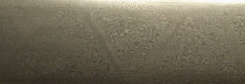

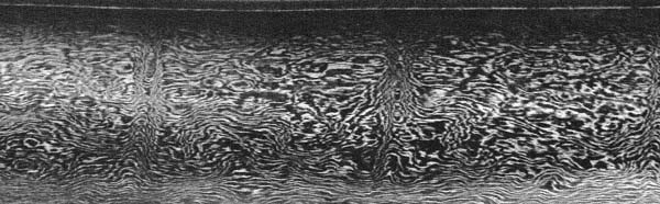

Apart from the seller who claimed speaking to Dr.Leo Fiegel a few days ago (Dr. Fiegel is no longer among us unfortunately), this sword looks legit. It displays a unique zig zag ladder pattern. Does anyone know of ANY similar pattern in existence elsewhere? Can it be authentic/original? Could the ladder rants were added later, i.e. recently? The reason to make them in the first place is to signify a "ladder to heaven", and would making any other geometrical variations be considered an anomaly (well, there is a double ladder pattern, rose variations, etc, but at least they are known, and still ladder patterns)? If it's authentic pattern - the realised price does not signify it's importance in any way. What gives?

Hi Alex,
I found this blade to be quite interesting and actually made a run at it, albeit, an unsucessful one because the wootz is very high quality and the zig zag effect is quite interesting. I felt the pattern was mechanically induced into the pattern during forging. I don't know how you add this effect at a later date to a quality wootz blade without impacting the existing pattern. You make a good point about its intent. While I have not seen a similar pattern I have seen some interesting manipulations a few of which are seen in Figiel's book. I imagine there is a bit of experimentation when trying to manipulate a pattern and I would guess you have to make a few blades to understand exactly how a certain manipulation would turn out. Perhaps someone was attempting to forge a ladder pattern blade but didn't manipulate the ingot in the correct way and turned out this type of pattern versus a ladder or double rung ladder. Who know's. I do think the price was probably conservative because we were dealing with such an unknown and maybe his comments about speaking to Figiel scared a few bidders away. All in all I think the blade is quite interesting on this one!

I do not recall having ever seen that pattern before, although I do agree that it is integral to forging of the blade and that this is wootz. A most interesting piece.

Rick, thank you for the nice comments. I agree with you, as I also think the pattern is original to the blade. If it'd be added after the production - it'd affect the visible integrity of the blade, but it has no visual defects, such as discolorations, etc. I also think the seller scared many potential buyers by making a false statement, but it is interesting blade indeed.

I don't know much about the particulars of altering or making blades, or how things like acid etcing would affect the wootz pattern, but doesn't it look like the "ladder" is actually slightly upraised from the body of the blade?

This is sort of "optical illusion", if you will. The "ladders" are not raised, they just appear as such. As with most well defined "Kirk Narduban" aka "Ladder" patterns, they appear visually raised, so it's a normal "visual effect". Also, it just can not be acid etch. An entire pattern appears 100% naturally formed.

It looks like an old blade reworked to me, there is a 'modern' feel to the ladder rungs and how they are placed. This would require completely reforging the blade, so unless they started with a heavy blade the finished item would end up noticeably thin or skinny in at least one dimension.
The modern look to the rungs is due to their edges, a little too consistent and different from the ground pattern, combined with the parallel ‘ghost’ lines showing up occasionally, it just screams “angle grinder” to me – compare them to one of Dr. Figiel’s strongly laddered blades, there is a more ‘organic’ feel to the rungs.

Blade is right i've seen this pattern before but only once long time ago. at that time it was called a tumbling ladder by the guy who had it i think its just the smith showing off his skill doesn't necessarily mean anything like a ladder to paradse. there is no way you could rework the blade with steps like this its all in the forging process. neat piece surprsied you guys let it go that cheap

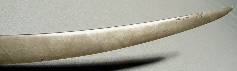

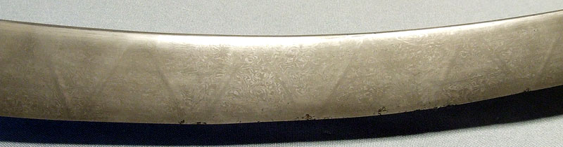

Let me see if I am understanding what people mean by the blade being modified. Are you saying that the blade was forged without the zig-zags, then sometime later they were added, either by grinding in the lines and reforging the blade flat or .... how? Forging little wootz bars onto the surface of the blade?
What catches my totally inexpert eye is that you can trace the watering pattern right through the lines, which are defined (at least to my eye) simply by a disturbance in the sworls. Would that change in the pattern happen with grinding? I can't envision how it could be done by adding metal.
Also, while I think everyone is agreeing that the surface of the blade is essentially flat and the pattern not raised, there is a slight pinching of the glare of reflected light in some of the photos (e.g., the first two below) that corresponds to the peaks and valleys of the zig-zag - it is not an even reflection along the blade such as you'd expect from a flat surface, in other words.
Final observation - some of the zig-zags are actually arcs (third photo below, right side). Does that mean anything? When I think grinder, I think straight lines unless you're using something more like an engraver, so making that turn strikes me as a tricky thing to do by grinding. Would the curve result from the post-grind reforging?

if you grind the grooves in ... early on... then they seem to have a nicer more organic feel.....
but if you do them close to final forging... it looks more like that blade...
-- to do that sword... just use a dremel with a wide stone... to cut the shallow channel... and forge flat in a very reducing atmosphere..
-- if the sword was a heavy saber... with spine around 5mm ... then no problem at all.. lots of room for pattern..
deep prior rust spots would be left as they are... and would come back after regrinding forge scale off.
by the way... ladders can even come out when forging the blade with a very narrow fullering tool... used to draw out the barstock...
nice sword
