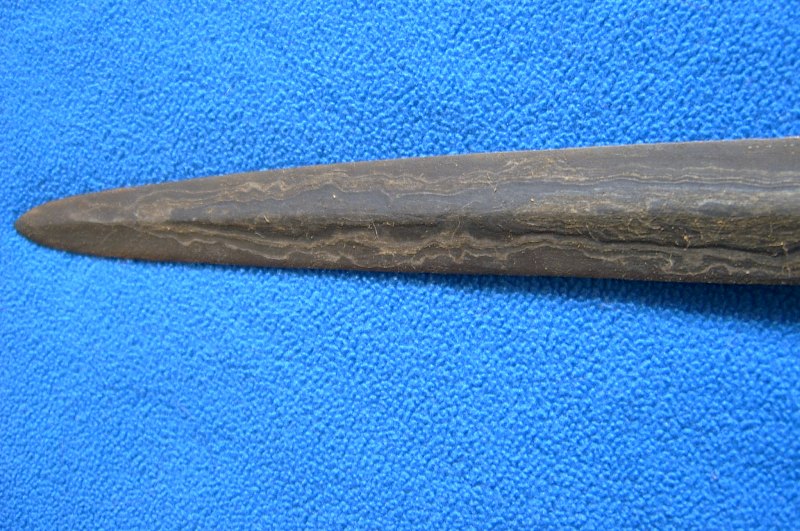

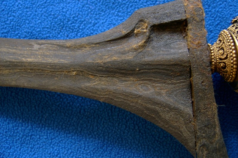

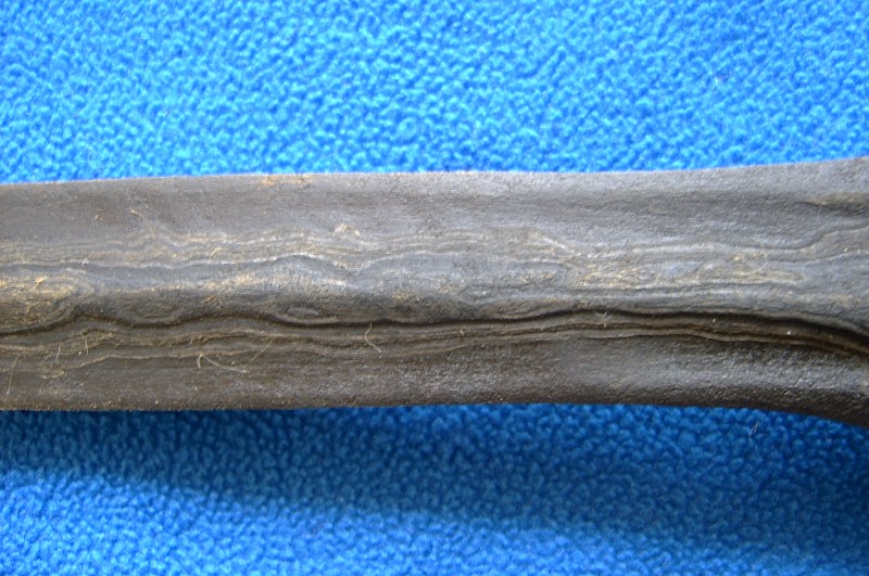

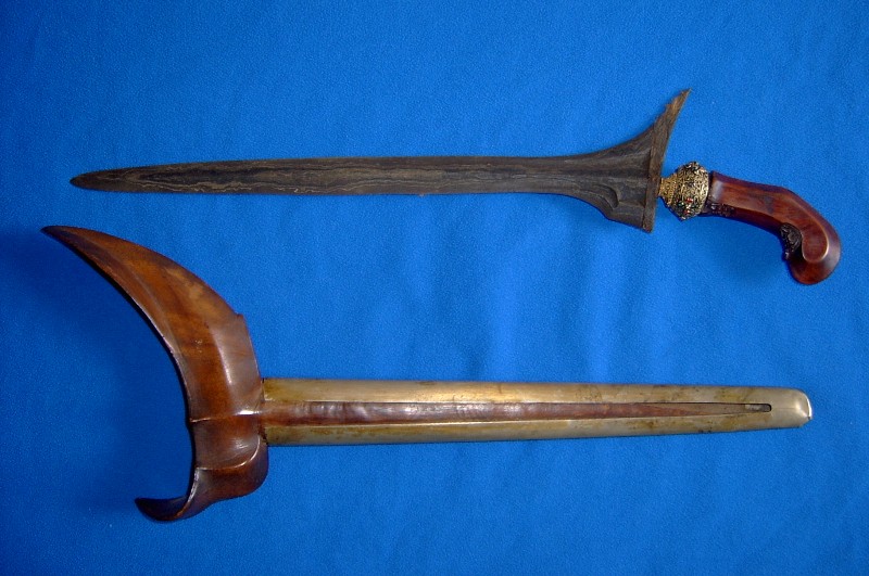

any comment on this keris???
ferrylaki is offline   Reply With Quote
Old 25th January 2007, 05:39 PM   #2
Posts: 7,303
Not sure what to say other than what i said on the other thread you posted this one on (though for a more thorough discussion it is usually best to post them one at a time like you have now ). I like this keris. It is not of extraordinary quality is probably village made for a "commoner", but it has a nice presence inspite of many years of acid washing. It is, as stated before, Surakarta formal dress (ladrang), with a pendok blewah (open) and as i look more closely this time it does appear that the sheath is wrongko iras, the stem and the top sheath being made of one piece of wood. If the blade fits like a glove in the sheath and was perhaps made for the blade as opposed to being adapted from an old wrongko, i would guess that this keris was held in high esteem by it's previous owner, at least to the point that he was willing to spend the extra money on a more expensive sheath.
As for age i wouldn't dare to say, other then it is obviously old. Dating keris is always tricky even with experts (which i am not) and the keris in the hand. Dating by a photograph involves far too many unassessable factors.
This one won't win any contests, but it's a great start for any keris collection.

Hi Ferrylaki
this is as David says a nice old keris, and a good starter. Each keris has something to teach, even if it is just to start us researching a particular feature. Had your keris been freshly oiled when the photos were taken, or has someone put some varnish or similar on the area of blade closest to the hilt.

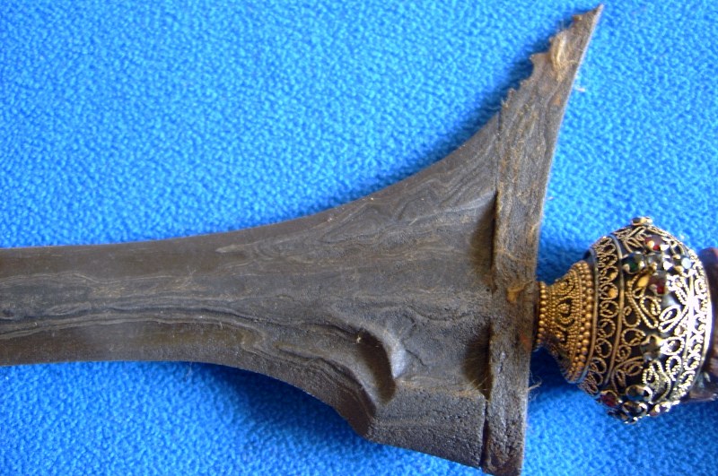

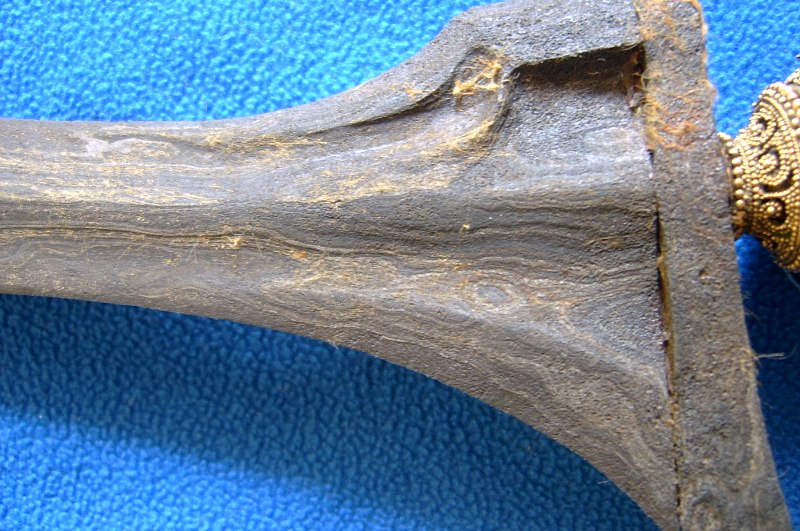

it just been oiled... my mother did. using cendana oil.
she said there some light rust on the kris ...

Oh, I see some fibres on the keris. Remnants of the cleaning rag?
Better pick those off with a pair of tweezers, or you will soon see real rust forming on the keris!
I would suggest you use a dabbing motion to clean the oil off the keris, rather than a rubbing motion, which will lodge a lot of loose fibre on the keris. While we like our kerises to smell nice, it is better to clean off the oil until it looks dry. Shiny wet oil on the keris dries up and leaves residues which causes more rust, and the worst part is that they stain the wrongko. Once the wrongko is stained by oil, you can never get the stained patch to go away. Better to note for your kerises in expensive wrongko.
Singer oil would be a good cleaning oil, after which you can apply a eeny teeny bit of scented oil.
Happy keris collecting!
