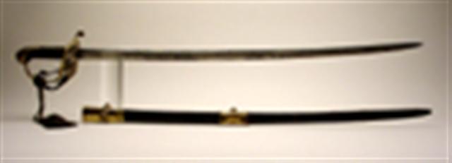

Curator
San Jacinto Museum of History
One Monument Circle
La Porte (Houston), TX 77571
Dear Matt-
I have done some research based off of the swords we have in our collections, and the style is very similar to an 1820s sword (37.5” long) we have in our collection that has floral etchings and crosshatching on both sides of blade. It is inscribed: "Viva El imper-io Mexicano" (Inscription refers to Iturbide's Empire, 1822-1823.) The handgrip of the hilt is made of wood and is wrapped in heavy cord and covered with leather. The pommel is of shallow cup design and the backstrap and knucklebow are made of strips of steel with two branches terminating in a an S-shaped quillon. I know the picture is… lacking, but our photographer is booked solid through May (this is our busiest time of the year and she is only in once every other week.)
We also have a mid-century (2011.a-b) Mexican army sword and sheath with a very slightly curved blade with sharp true edge and false edge. It has an etched floral design with a Mexican eagle and snake mid-blade on both faces. It has some sort of reptile skin (may be shark skin—hard to tell due to condition) grip wrapped in brass bands. It also has a brass back strap, pommel, branched knuckle bow, and scrolled quillion. There is a Mexican eagle and snake on the guard with the inside half of guard hinged to fold flat.
In other words, we have similar weapons with as much (or in the case of the second one) more “work” on the blade, but nothing exactly like yours. We have a huge Spanish language archive, but, unfortunately no archivist to process it so I am unable to know if there is anything I there that can help you. When I need help with things like this, I tend to go to private dealers in my area—unfortunately, they charge for their opinion to the public (and they are not cheap.)
I am sorry I can not be of more help.
-Liz
Liz sent me two photos in her e-mail, they are very small so I resized them, this is the best I can get them.

It was very kind of the lady at this museum to respond, especially with the detailed data on thier holdings. It seems that often, especially these days, museums simply do not have the time, budget or personnel to address the many personal queries they must receive. As she has accurately noted they often charge handsomely. Also, information from dealers must be carefully guaged as thier responses may be closely associated to the marketability of thier holdings or interest in the purchase of an item for resale.

Liz was the most helpful of all I have contacted, and I understand the lack of time and money in museums ect we all have that some times.
I wish I could travel to some of the museums I have found on line, some say they have over a hundred edged weapons but have no photos to search through.
The photos Liz sent have left me with more questions than answers, the hilt on these two swords look very similar to mine and I would like to know where they came from, also I wish I could see the eagls she describes on one of the blades.
Jim, I have been thinking about your comment about the John Walter book and that swords were marketed along with cutlery and tableware and I am starting to follow that path to see where it may lead, do you know of any sources I can check ?
Thanks again

Inquiry of Matthew Branch: Sword of P.D.L.
Conclusion: This is probably a lower ranking Mexican cavalry officer's
presentation sword, intended to be carried in battle.
Blade: The blade on the sword is probably mid 19th century of the 1799
Pattern. The straight double edged blade is a pre-1799 design. In 1799 a
newer version of the 1728 Pattern blade (minor changes) was attached to a
dragoon hilt. A second version of the blade had a single edge. In 1803 a
curved blade was created for light cavalry, but the straight blade retained
its popularity among conservative Spaniards. The 3-fuller design with a
hexagonal blade is probably the most common blade type found in New Spain.
The blade appears to have been hilted in a common style of the 1820's in
Mexico (though it could be Spanish, German or British).
Hilt: The simple pommel cap design was introduced in the late 1790s, though
the style had been used on the Spanish dragoon sword since 1768. The hilt
design was common in the early 19th Century (see many of the dragoon swords
used by French and British). I cannot determine from the photograph whether
the hilt is steel or brass. The knuckle bow guard is a common 3 bar or
branch hilt.
Grip: The palm grip is probably pine. It is most likely covered in calfskin
which is common on Mexican hilts. The braided wire is a common feature of a
Mexican officer's sword.
Blade decoration: This has a common martial decoration. The eagle and snake
art tends to be crude, the wings being less broad and the head and neck
being less bold and beautiful than is used as a Mexican symbol in the late
half of the 19th century. This eagle is similar to the 1823 first official
Mexican flag design (see the 1859 Mexican eagle dollar for a similar eagle).
Notes:
AHS possesses a Mexican presentation dress sword (cerca 1890) with a similar
blade design (cannon, drum and eagle with snake-eagle is more refined), a
Spanish dragoon saber (post 1799) with etching that is similar (etching
appears to be added in a later period), and an A.L. de Santa Ana
presentation sword that has similar etching.
Spanish Military weapons in Colonial America 1700-1821, Brinkerhoff and
Chamberlain Pg 73 & 88
The Price Guide to Antigue Edged Weapons, Leslie Southwick, 1982
Swords and Hilt Weapons, 1989
Richard A. Collins
