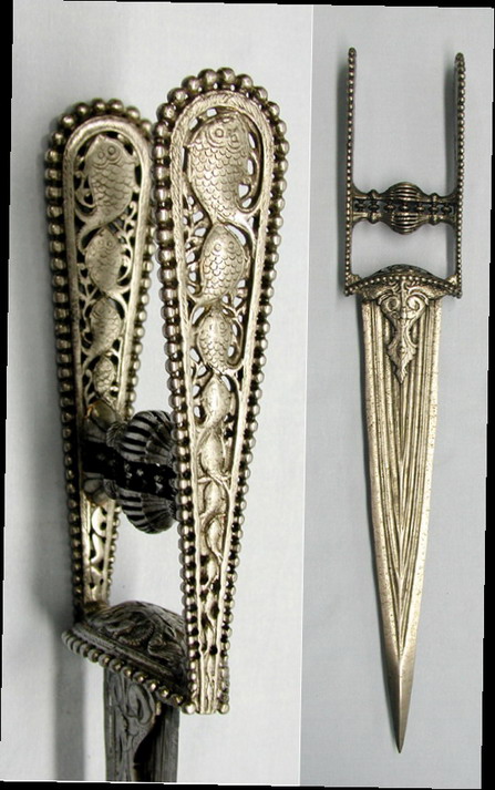

Katar. Tanjore, South India. Length 51 cm, blade 33 cm. The hilt and the blade have been made in two parts and riveted together. The side guards are decorated with fish and steel pearls. When the side guard is hit, the sound is deep and it sounds like a tuning fork, but the sound does not last as long as it does from the first katar.

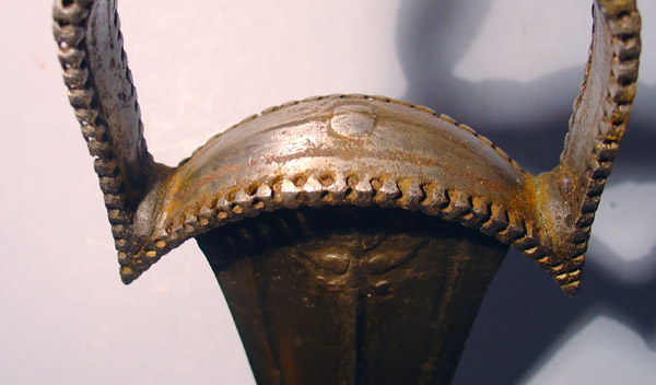

i also agree with lew, that the blades were also joined via a peened-over shortened tang, which can be elongated to resemble a dovetail.
the attached image is an old example, of the early 17thC. the blade sits into a cut out slot in the guard (quite shallow as the guard is not thick) and a small tang has been peened over.
you would think this is not a sturdy way to join the blade, given the stabbing purpose of the dagger but it is 400 years old and still solid with no movement.
delor, with these three ways of constructing a katar, i think you have a free reign. if you want historical accuracy, why not roughly design the katar that you have in mind, and show the drawings. we can then tell you what it is close to (ie which culture), and show you pictures of actual examples of the same type. you can then adjust the drawings to suit, and you fit the blade in the appropriate way.
